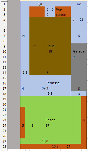

mambo198830 Nov 2020 18:19Unfortunately, the property was purchased privately. Until the building permit / planning permission is granted, there are only deadlines that will unfortunately increase the cost of house construction. Therefore, we want to proactively address and advance this topic.
Today, it was decided to develop the following proposal: a cistern, greywater reuse, and an overflow into the active soil zone or a infiltration basin in the rear garden area.
The infiltration basin in particular is causing us headaches. Can it be used for playing? Is only grass allowed there? How else can it be designed?
Here is our property:
mambo1988 schrieb:
How could the infiltration basin possibly be optimized/improved/made more usable?You could build a wooden deck on it. The idea of placing the basin close to the house is also nice: creating a rock garden or pond in the basin.Similar topics
