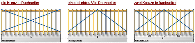

Mycraft7 Oct 2020 17:00
Nowadays, rip-strip tape is used for this, and yes, something like that is necessary.
Sketches of roof side braces: left X, middle rotated V, right two crosses per side.

I hope I’m not overstepping by saying that you can replace them with "modern" tension straps. These are basically perforated flat steel strips from a roll. Afterwards, you could easily double up the rafters to create a flat surface, on which you can then install the paneling you have in mind. Alternatively, you could double up the rafters to a thickness that exceeds the height of the old wooden wind braces.
