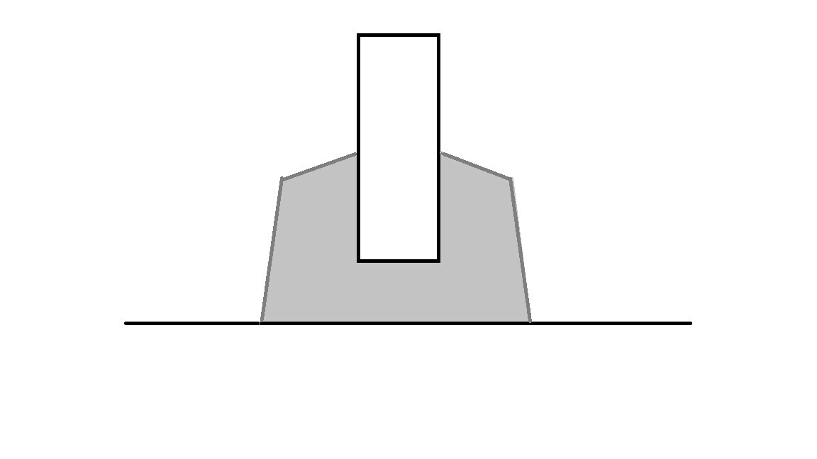

A friend advised me not to skimp on concrete and not to create a wedge. Rather, more like in my attached picture. This way, the curb can better handle lateral loads. Approximately 0.14 cubic meters (5 cubic feet) of concrete per meter (3.3 feet). However, I’m not sure if that might be overdoing it—maybe appropriate for paths that will be driven on?
