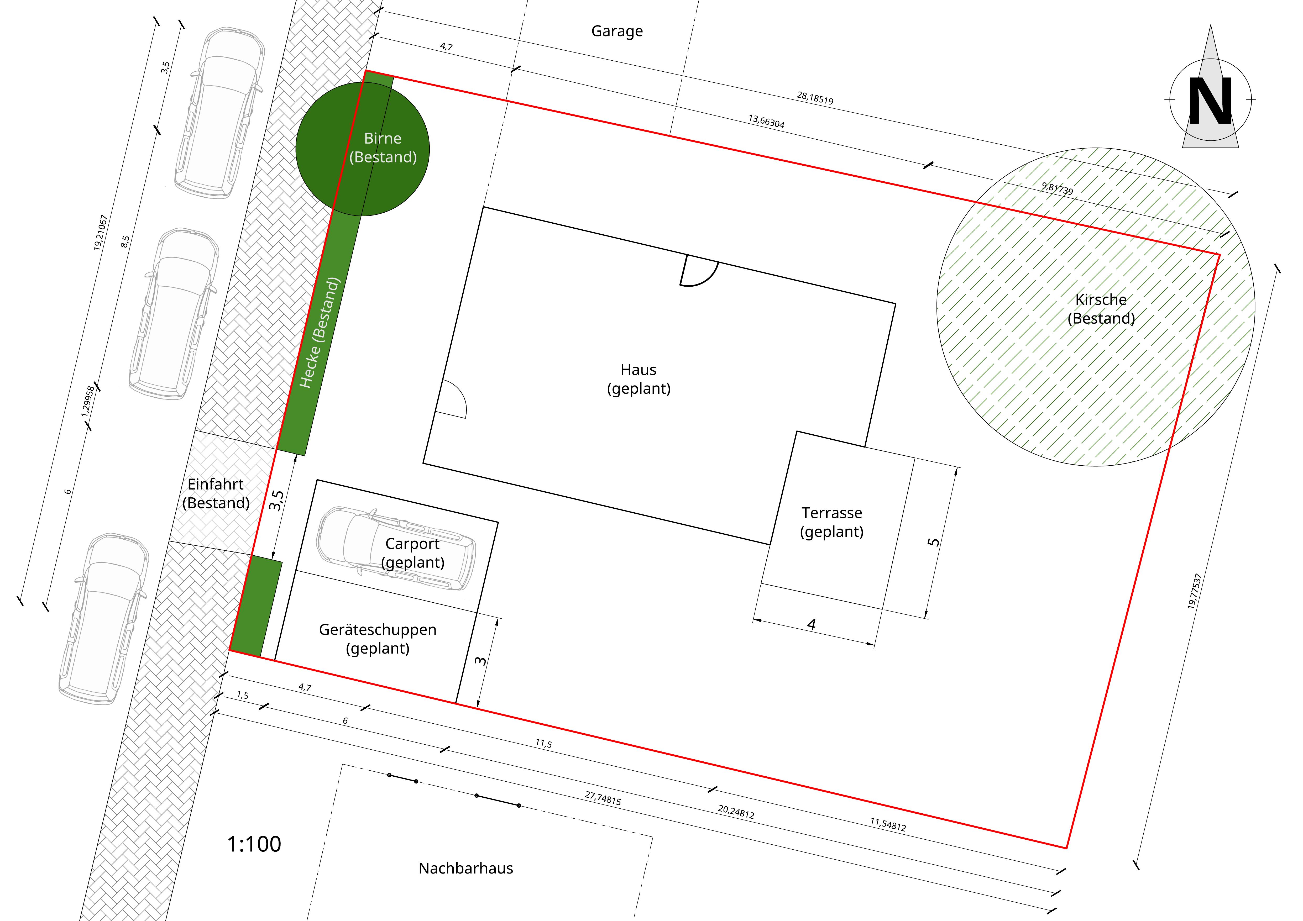

- Plot: How can it be used optimally, and where could a second parking space for guests be located without blocking the south side with a large garage or sacrificing light in the kitchen? Our idea is to apply for a second driveway along the north wall, but 3.5 m (11.5 ft) is quite tight for parking and the house entrance. It is also important to keep a shed or storage room of at least 15 m² (161 ft²) near the front for garden tools, car tires, bicycles.

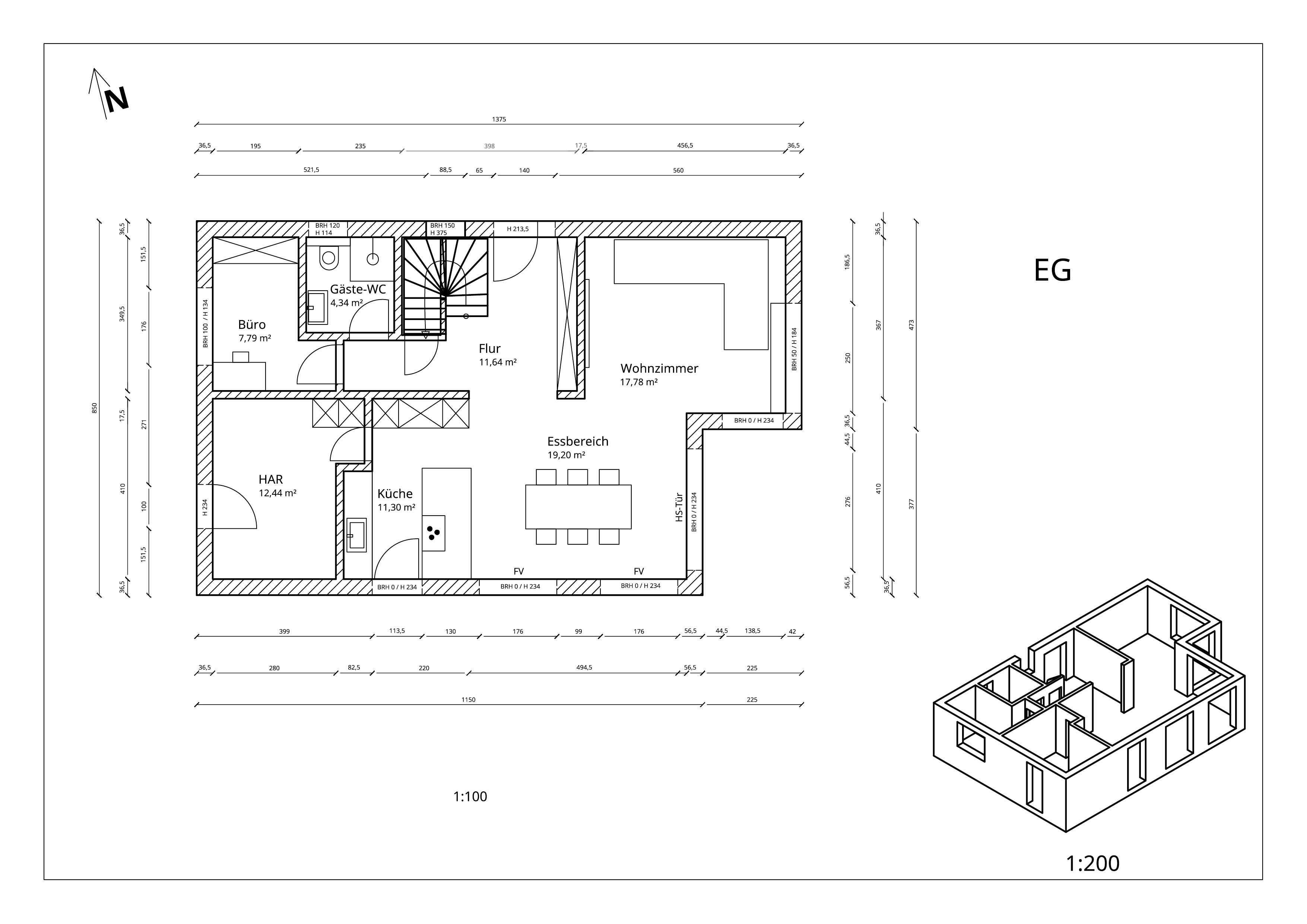

- Ground floor: How can the layout of the office, a generously sized guest shower toilet, and the utility room (HAR) with pantry section be optimized?
We would prefer a connection from the utility room to the hallway rather than the kitchen (to avoid bringing dirt inside), but then the pantry part of the utility room would need to be separated to allow direct access to the kitchen.

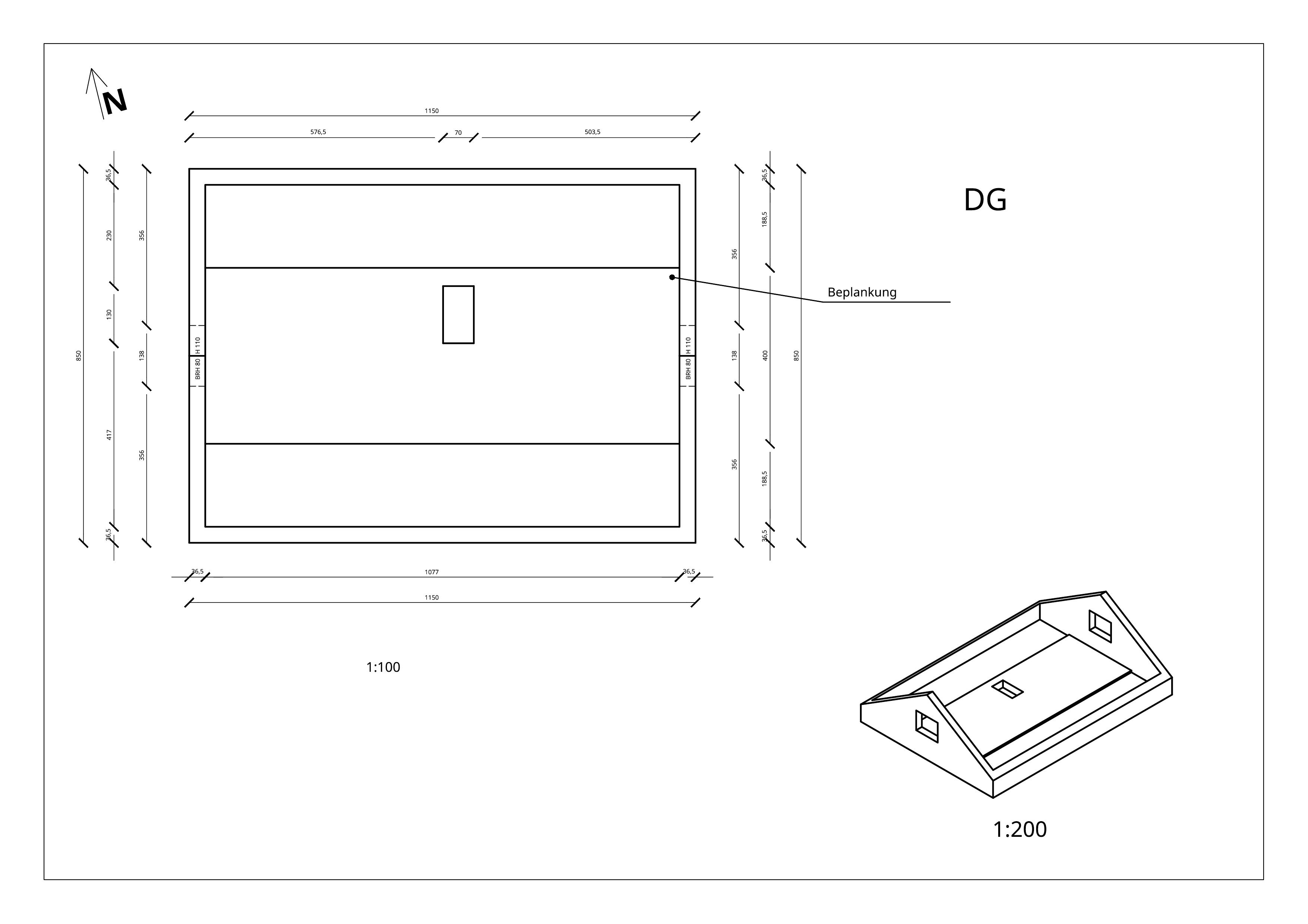

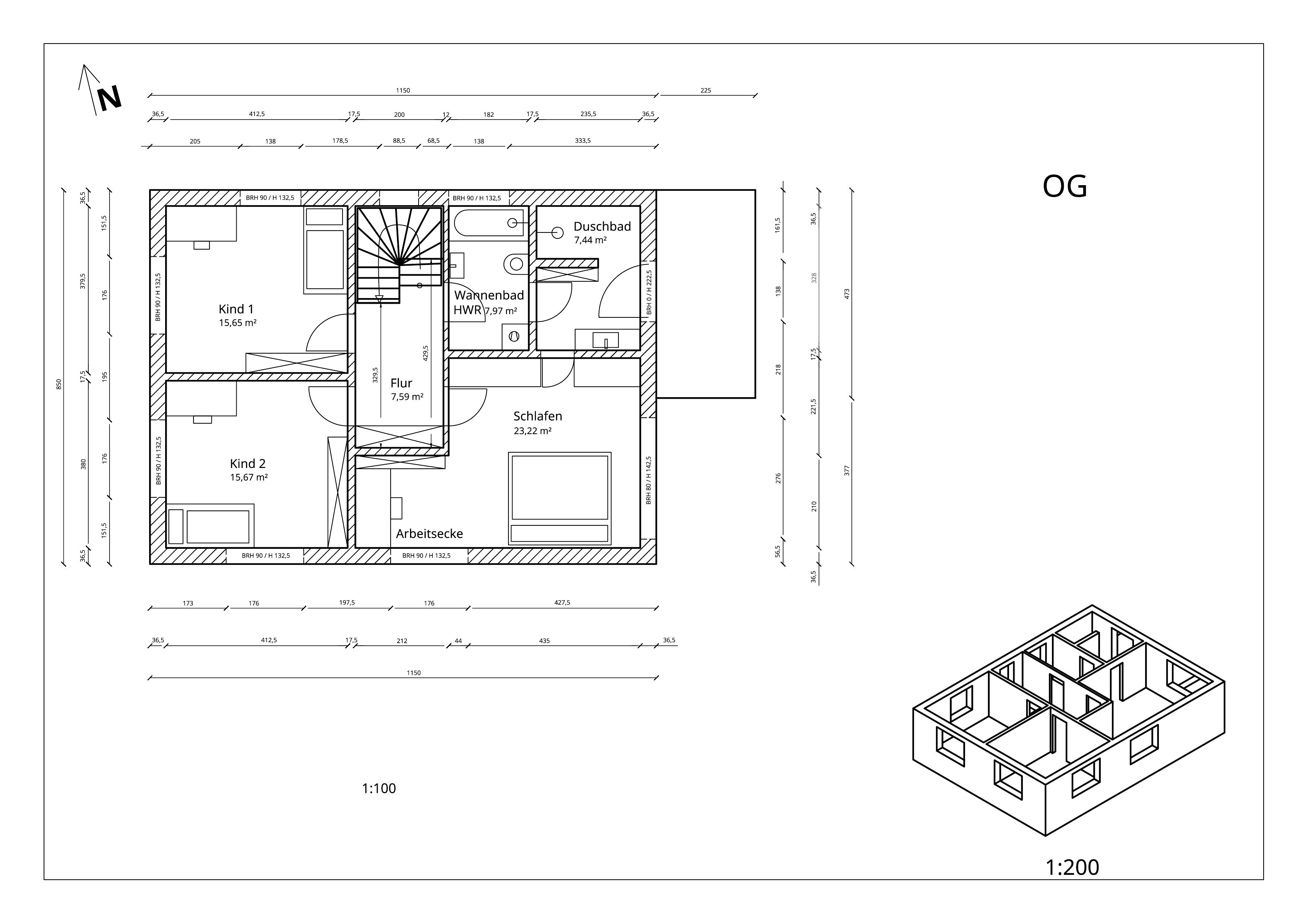

- First floor: The idea is to create a laundry balcony above the bay window on the ground floor and possibly add an external staircase later, turning the bathroom and bedroom into a separate small apartment. However, this would require designing some sort of entrance area right away, so the balcony door shouldn’t open directly from the bathroom (which currently is not an issue due to the large tree ensuring privacy).

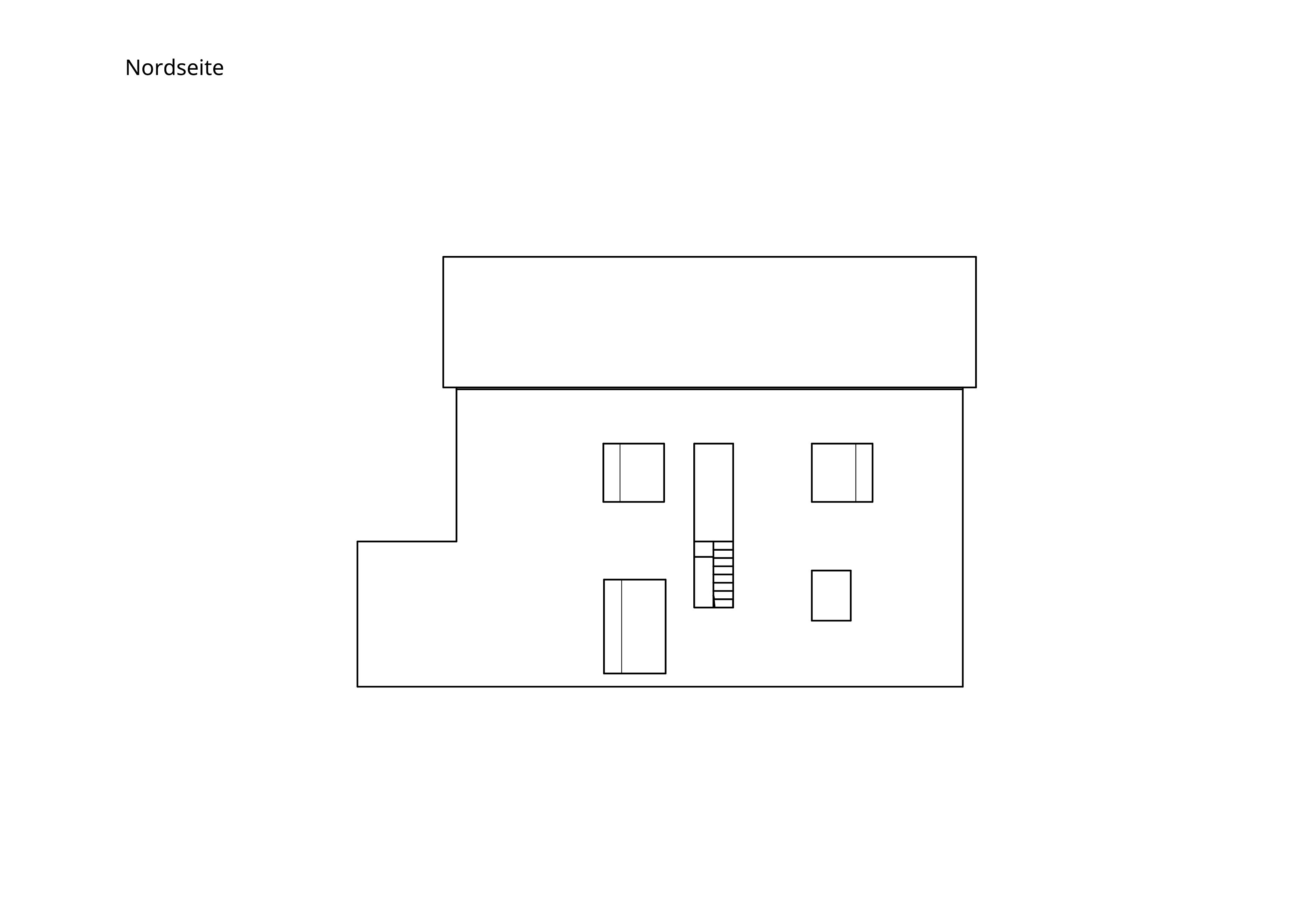

- Facade: What are your thoughts on the window arrangement on the north side? Are there too many window formats?

- Ground floor office awkwardly shaped (guest shower toilet on ground floor should also function as the only bathroom in old age and already offers sufficient space, which reduces office size)
- Window symmetry on north side feels too busy

I have been following with interest for a year now – we have been tweaking our floor plan for just as long. On Monday, our building application will be reviewed with the planning office of our general contractor, so if possible, we would really appreciate some critical feedback now!
Location:
It concerns an infill development with heavy pedestrian and vehicle traffic (30 km/h (19 mph) zone, school opposite, and a popular recreational area with sought-after parking spaces).
- Approximately 19 m (62 ft) tall building opposite on the west side, so no evening sun for about 4 months (terrace or living room on the west side therefore not an option)
- Building zone starts only 5 m (16 ft) behind the western property line, design regulations forbid floor-to-ceiling windows or light bands in areas visible from the street
Most pressing questions:
- Do you notice anything else?
Thanks!

Garage, carport: one carport space, adjacent shed up to property boundary, plus uncovered “overflow” guest parking preferred

K a t j a schrieb:
Regarding the floor plan itself: the amateur planning is obvious. Cutting corners on planning reduces the house’s value even before construction. Absolutely, you can clearly see the amateur planning conceptually at many points right from the start (not just at critical ones). You should only save on architects if they are the type that “@Gerddieter warns” about – and then save completely. Otherwise, phase 5 of the architectural services is by far the most valuable, even though its price only misleadingly suggests otherwise: it only seems expensive. Anyone who understands the house-building process will combine phases 1, 2, and 5 accordingly.

Besides that, I would not remove the tree – especially not with occasional car users. Few things are as forward-looking as adapting today to the decreasing dominance of the private car. A tree doesn’t spoil anything, and any replacement tree takes too long to restore what the predecessor provided. It is part of a property’s character not just to have a foundation slab but to be the organic foundation of a paradise. Only fools destroy this (unfortunately many times every year). Especially as a family that has already used the plot as a garden, I would not kill my own memories there.
A tree doesn’t spoil anything, and every replacement tree takes too long to restore what the original provided. Elefant, I fully respect your fight for the tree. I’m certainly one of the last people to want to cut down trees. But this is a fruit tree. Sometimes you have to keep things in perspective. If it were an oak, I would see the situation very differently (kind regards to @Oakland). Also, bikes need to be stored. You’d be surprised how much space they take up, along with the lawn mower and garden tools. One might still consider it if there was already a perfectly maintained and stunning enclosure. But even then, a gate can be moved in no time.

Regarding the floor plan itself: it clearly shows an amateur design. Cutting corners on the planning reduces the house’s value even before construction begins. In this case, I would immediately reduce the resale value by about 30%. Therefore, it’s best to shred this draft and then consult an architect who actually studied this. Thanks for the quick review! We were fortunate to have a family architect visit our plot this weekend, who didn’t recommend rotating the house but did suggest rearranging the rooms. We will invest the time and money to get professional advice here and also thank you for confirming that there is still a lot of untapped potential.
The design shown is packed with critical issues, so much so that it’s better to skip paying for an analysis of them (which I do professionally) and instead develop a new design. Note — a new and developed design, NOT just debugging the current one. I really appreciate how thoroughly you considered our requirements. The longer I looked at floor plans, the clearer it became that there are many more variables than just moving interior walls. “Radical” but logical steps like adjusting the building’s footprint and relocating the two neglected “work niches” to the attic were also impulses we needed. We have now listed and prioritized our wishes and will bring this list to our meeting tomorrow.

A tree doesn’t spoil anything, and any replacement tree takes too long to restore what the predecessor provided. It is part of a property’s character not just to support a foundation slab but to be the organic basis of a paradise. We agree — the existing mature trees give this plot its soul and distinguish it from a new development, which we cannot imagine as a building site.
K a t j a schrieb:
And bicycles need to be accommodated too. A detached bike shed won’t be obstructed by the pear tree. The distance between the trunk and the north side is 2.5m (8 feet), enough for a pedestrian gate, which we plan to install anyway. Even now, there would be enough space in the front part of the 3.5m (11.5 feet) wide strip on the north side for a bike shed, although it might partially block the view from the entrance to the pedestrian gate.
motorradsilke26 Apr 2026 22:5911ant schrieb:
11ant wrote:
It’s a pity that besides Yvonne (already earlier), Katja has also given up.
I just received a like from Katja – that makes me happy, so at least she is still following along :-) I suspect that Yvonne is also still posting here, just under a different name.
HausamSee schrieb:
The longer I searched for floor plans, the clearer it became to me that there are so many more variables to adjust than just moving interior walls. This really shouldn’t happen to someone who reads a lot,
HausamSee schrieb:
I have been following with interest for a year now - right?
I’m not in favor of rotating the house, nor do I see the point of cutting down a tree.
The house has a nice orientation, and a hedge or wall can separate the carport from the garden without nosy people being able to peek through.
It’s better to realize this late than not at all.
