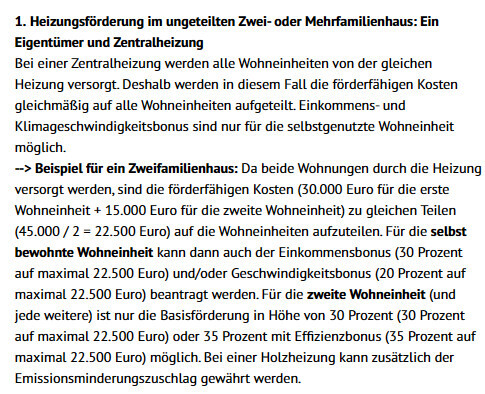

nordanney22 Dec 2024 16:56Thomas Seitz schrieb:
We are replacing our old oil heating system with a new pellet heating system. Our house has two separate living units, both of which we occupy ourselves (parents downstairs, children upstairs).
In addition to the basic subsidy of €45,000 * 30% = €13,500, we also receive an emissions bonus of €2,500.
Since we are also installing a domestic hot water heat pump, we qualify for the climate acceleration bonus.
My question is, can I apply for the climate acceleration bonus per living unit (so twice)?
Then I should be able to submit two applications to receive 2 * €4,500 = €9,000... Or am I mistaken? No, only one dwelling is owner-occupied. The second unit is formally used by third parties, regardless of whether it is rented or used without charge.
The climate acceleration bonus is granted solely for the owner-occupied dwelling.
Unfortunately, as an owner and occupant in a multi-family house, you only receive the subsidy once.
