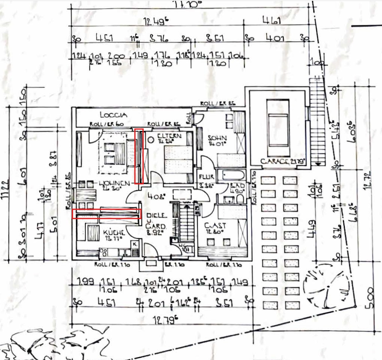

I wanted to ask for your opinion on the following situation:
We would like to combine the kitchen, living room, and dining room on the ground floor (currently the parents’ rooms) into one large open space.
According to the plan, the two walls are 10cm (4 inches) and 11.6cm (4.5 inches) thick, which initially doesn’t suggest that they are load-bearing walls.
However, I am wondering if these walls might have some stiffening function, for example, to ensure the building’s torsional rigidity.
Perhaps someone here can assess this.

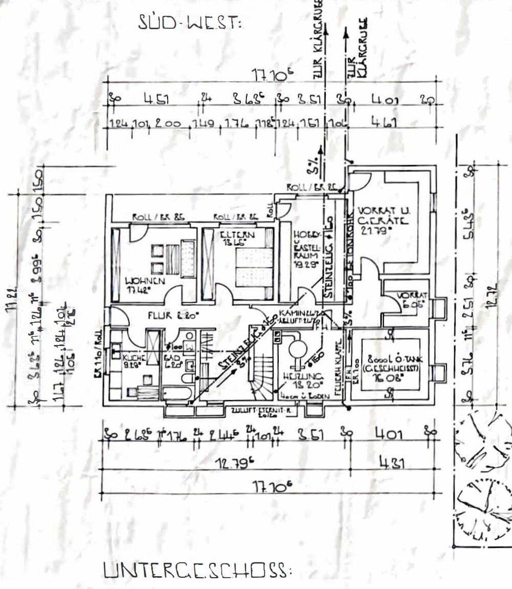

Ground floor:
Basement:

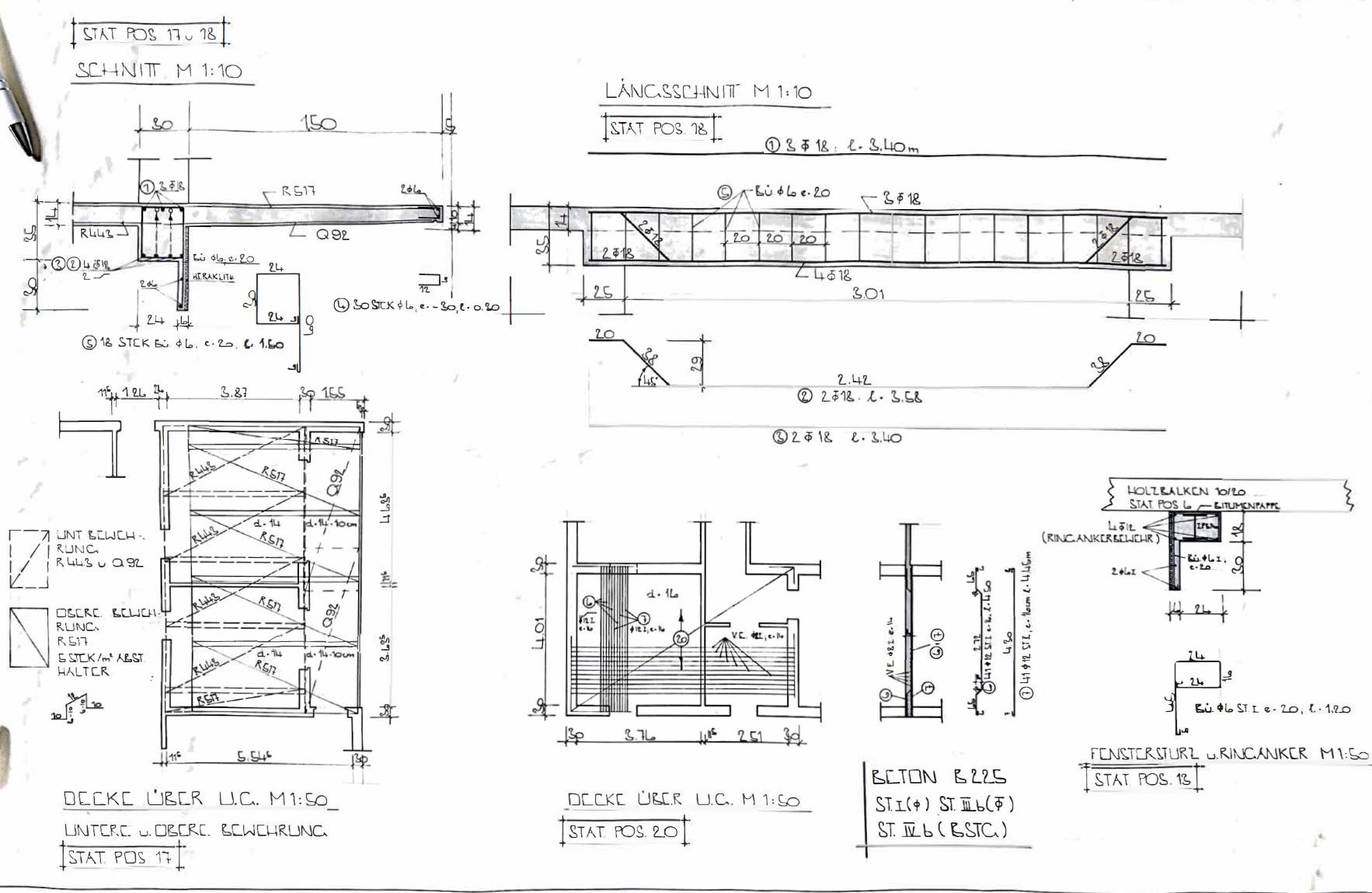

Ceiling plan:
11ant31 Jan 2026 13:43
Tapping on the surface here would not provide any useful information. Unfortunately, the ceiling plan shown does not contain any helpful details. The wall between the "Living" and "Dining" areas is apparently non-load-bearing (unlike its counterpart in the basement), and the one between the Living area and the Kitchen is likely a gypsum board partition; both suggest the intended option of opening them up or even removing them entirely. However, "non-load-bearing" does not mean "dispensable," as their role in bracing can still be significant. At least one opening (while leaving a strip toward the loggia, or a wide passageway) without the need for load transfer at the top seems feasible in each case.

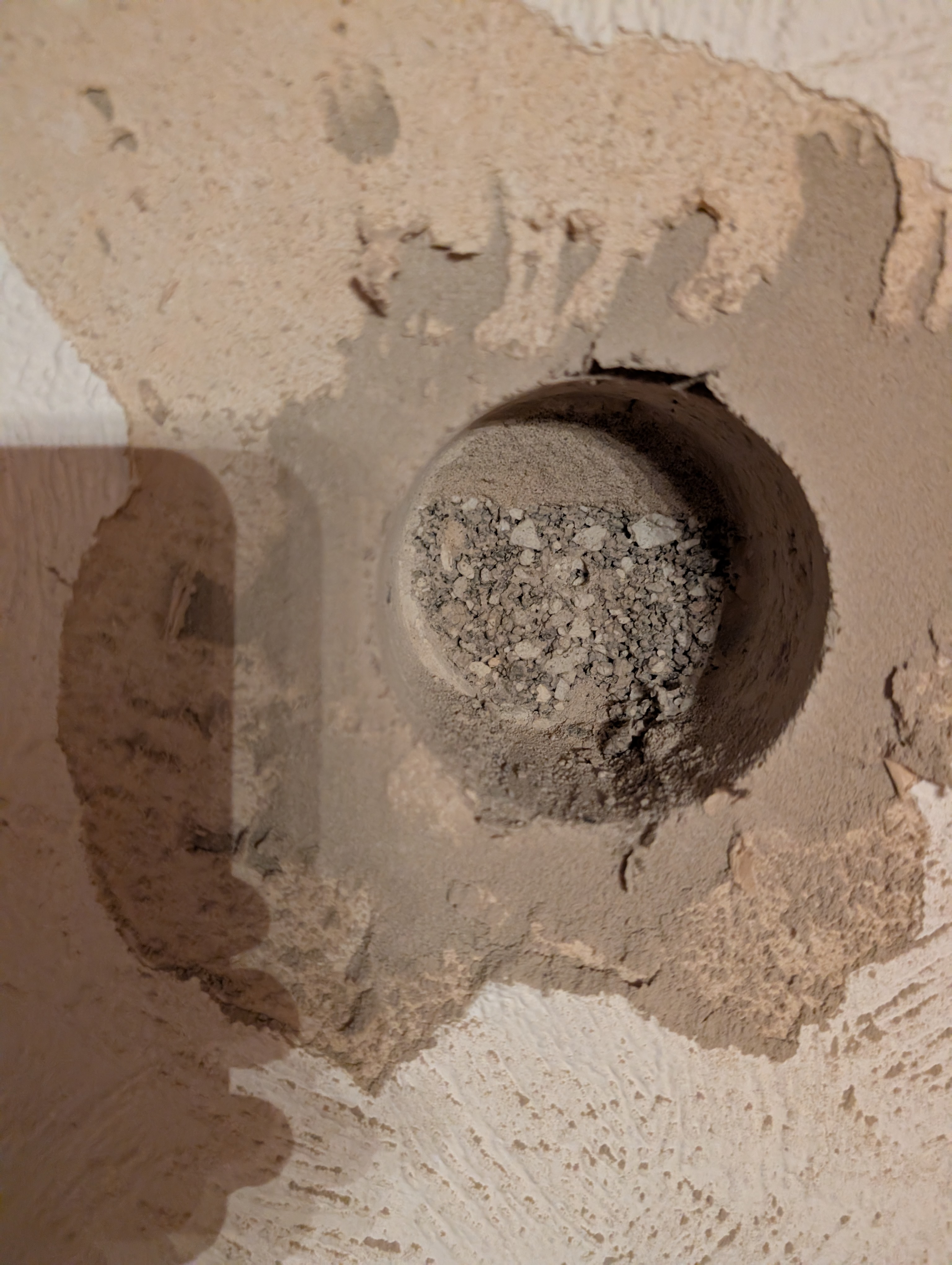

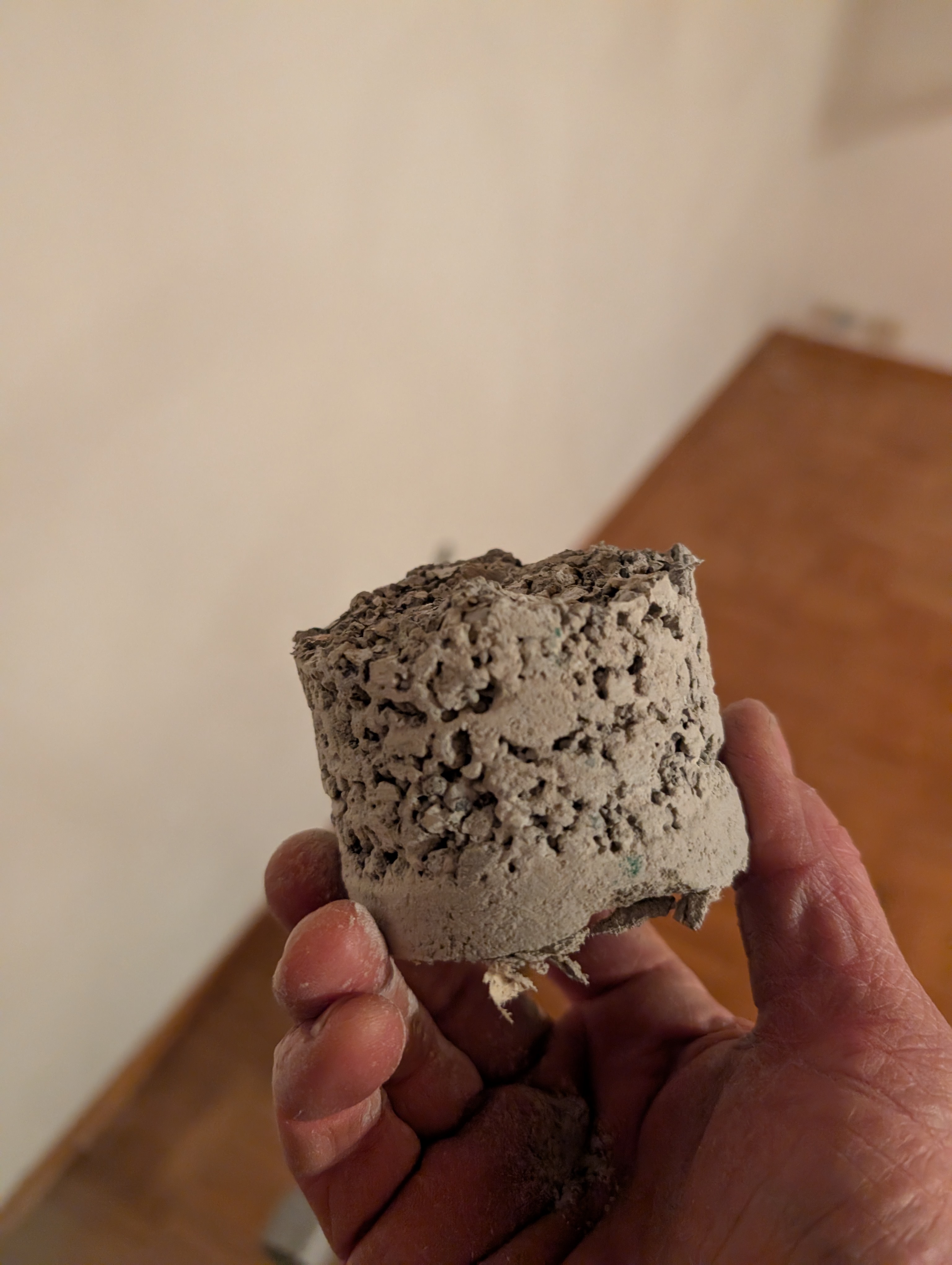

Today, I drilled core holes into both walls.
They both appear to be made of pumice (at least that’s what it looks like to me) and are 13.5–14 cm (5.3–5.5 inches) thick, including plaster.
I’ve also sent the pictures to the structural engineer and am curious to hear their opinion.
Matt123
11ant25 Feb 2026 23:33
Matt123 schrieb:
I drilled core holes today in both walls. [...] I also sent the pictures to the structural engineer and I'm curious to see what he says about it.
To quote Grandpa Willy, a friend's son's grandfather: "as unnecessary as a goiter."
