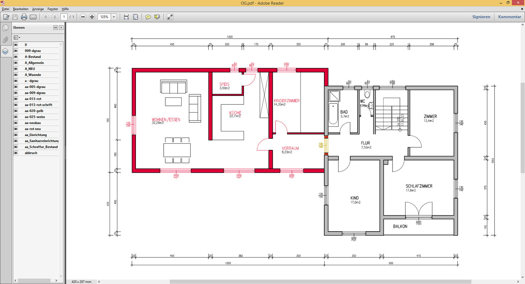

Attached is a screenshot of the current rough plan of what we want (red = new build, white = existing building).
We will handle the entrance area ourselves. It will be on the north side near the staircase (landing with stairs).
