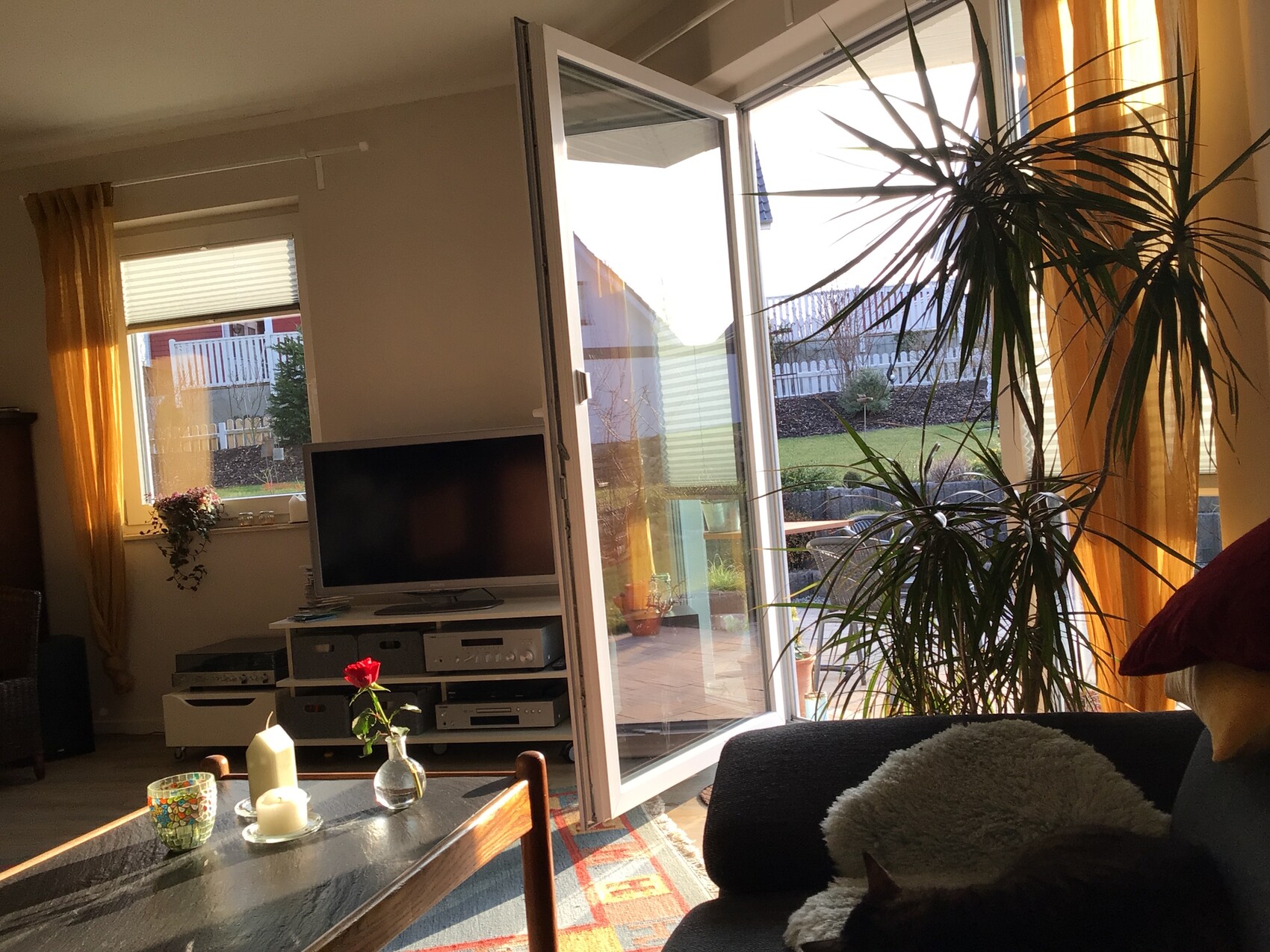

I also have controlled ventilation for the living space. Control means I can seal the house whenever I want.
