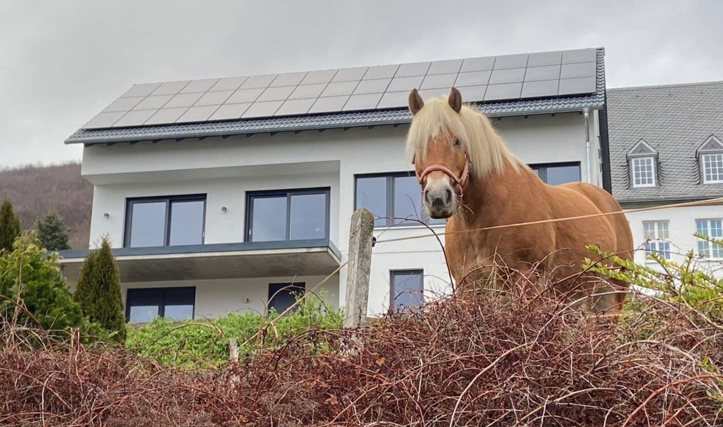

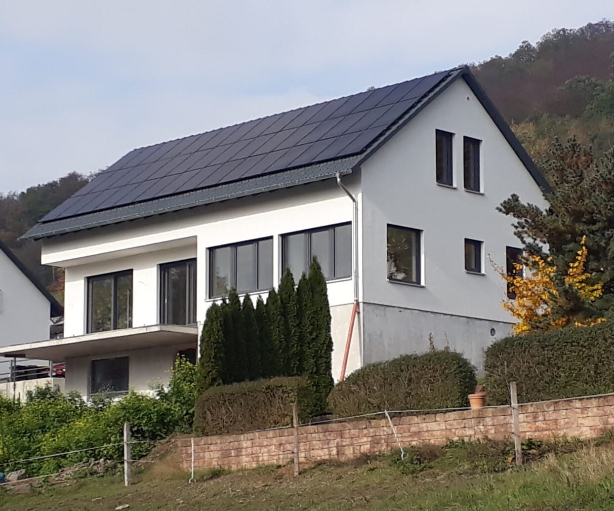

In theory, I wouldn’t care about the look since I’ll never see it, but naturally you also want to be fair to the neighbors above me 😉. speak a different language 😉
All-black modules are not different, special, or better; they are simply black. And no, a black frame is not standard—regular modules have natural aluminum frames and busbars, which honestly look quite ugly. In our area, all-black is even required, but the extra cost is so minimal that I would have chosen it anyway. I don’t even want to imagine that 1980s satellite dish look.
