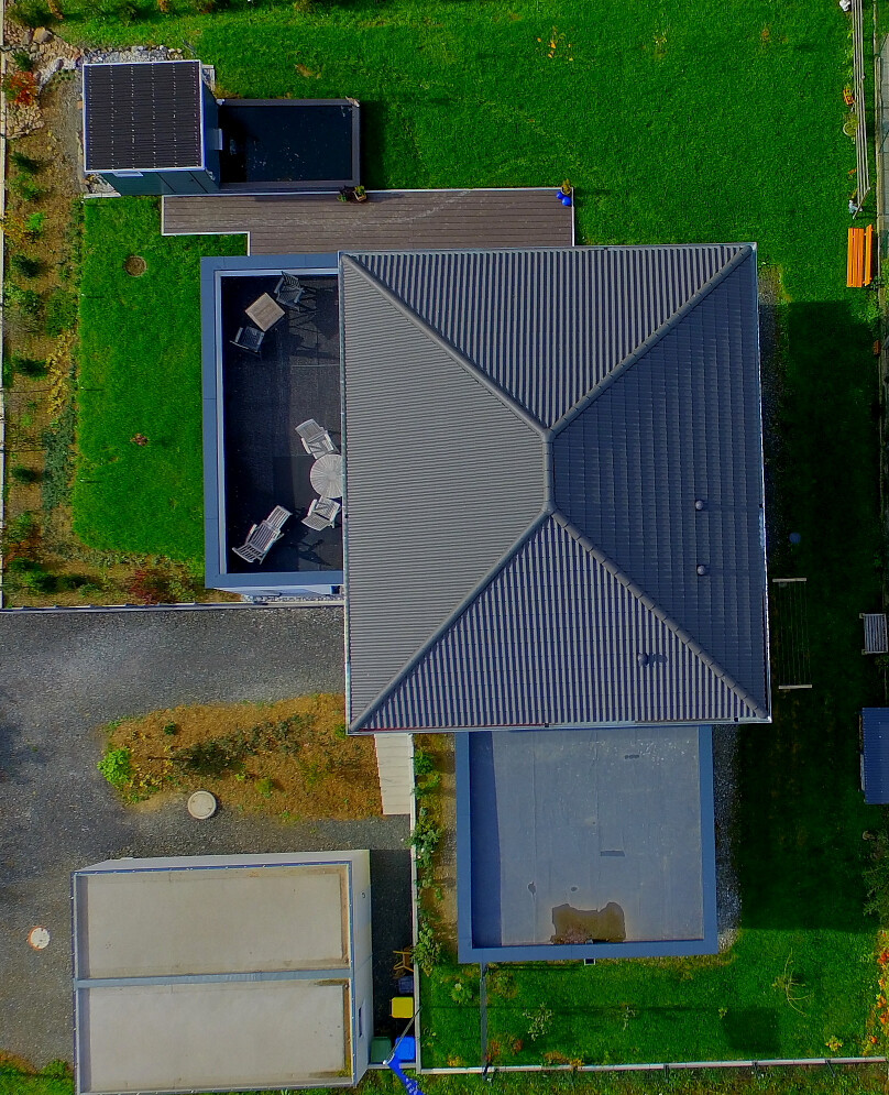

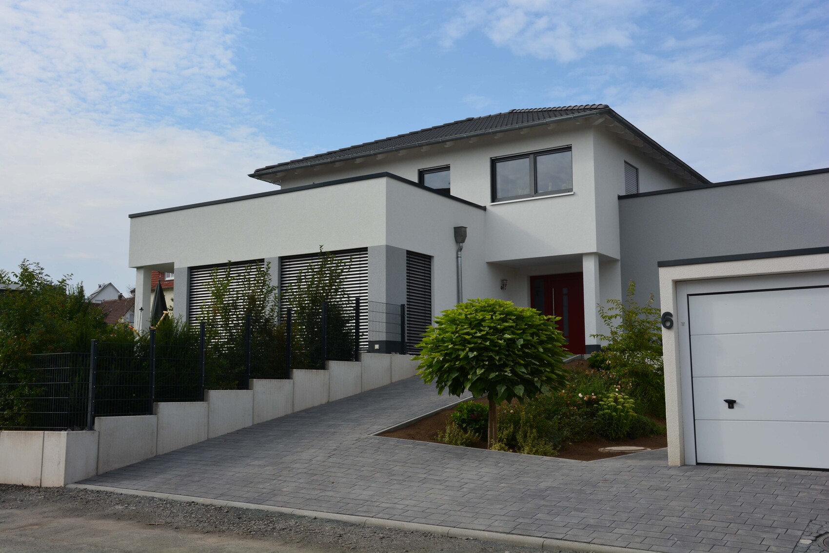

I am happy to share three photos:
1. Of the roof covering in February 2018:
Fresh two-story shell made of white blocks with dark tiled roof, construction crane and snow.
2. In October 2019 (our general contractor had commissioned a drone flight back then for advertising purposes and their 2020 calendar):
Bird’s-eye view of a modern house with a large, multi-section roof, terrace, and green garden.
3. Currently, August 2021 – although due to the low pitch, you can’t see much of the roof:
Modern white villa with red door, garage on the right, and paved driveway.
Three and a half years after installation, the roof still looks like new. It has withstood severe autumn storms and if any birds left droppings, the rain has thoroughly washed it away. We are very satisfied with the roof.

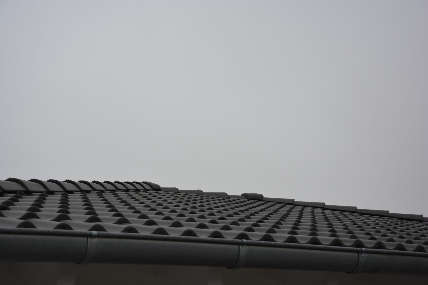

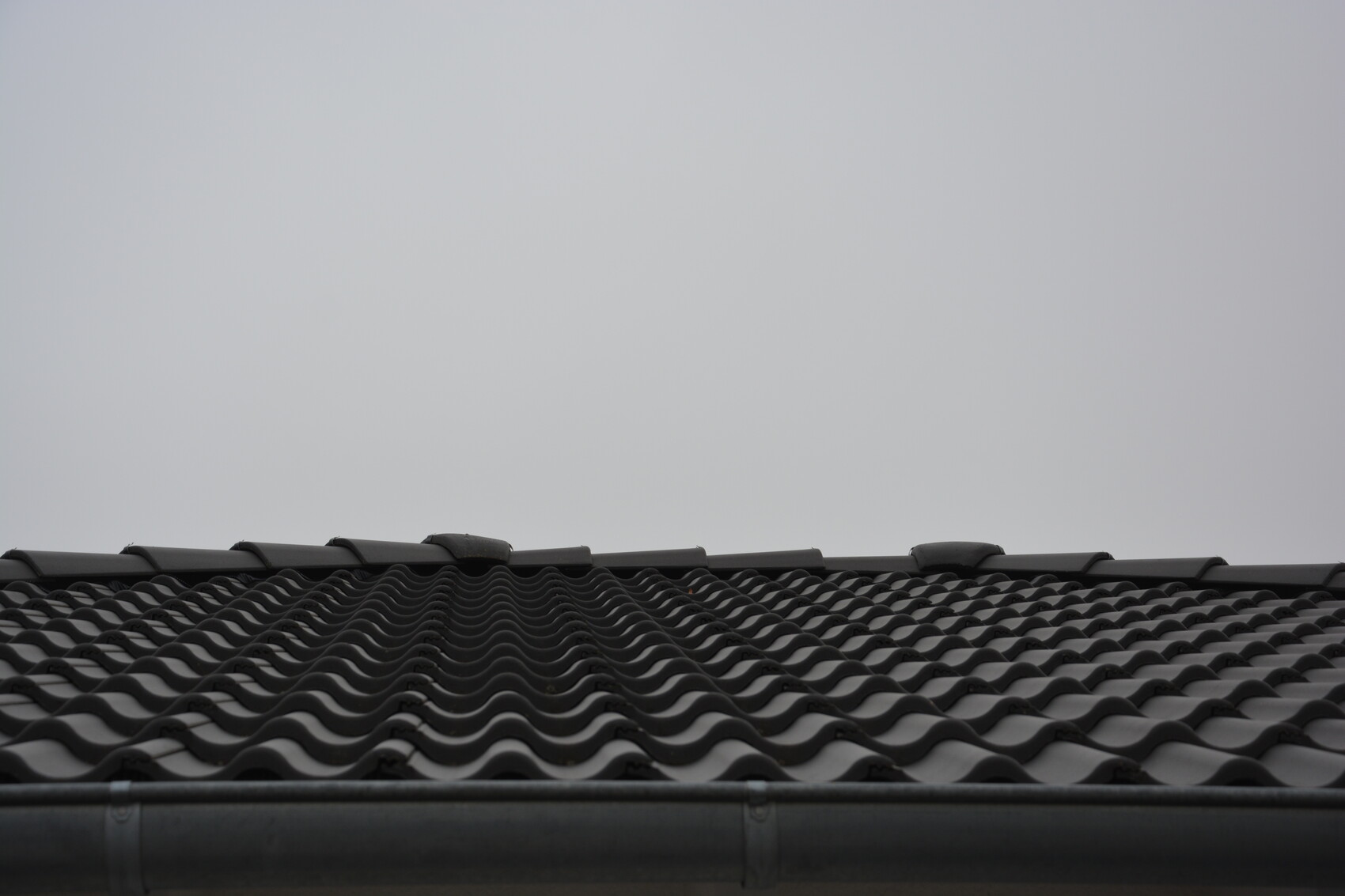

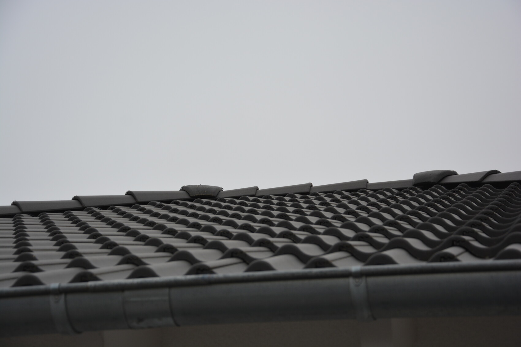

AxelH.28 Oct 2021 15:51
Nixwill schrieb:
Maybe some nice photos of the roof and tiles can be taken from there sometime 🙂
What a beautiful roof... 😉
Dark tiled roof with wavy clay tiles, view from below, grey sky.
Roof with grey, curved tiles and metal gutter at the lower edge against a grey sky.
Roof with dark grey, wavy roof tiles; rain gutter at the bottom of the image, perspective from below.
Roof with grey, curved tiles and rain gutter; cloudy sky in the background.
