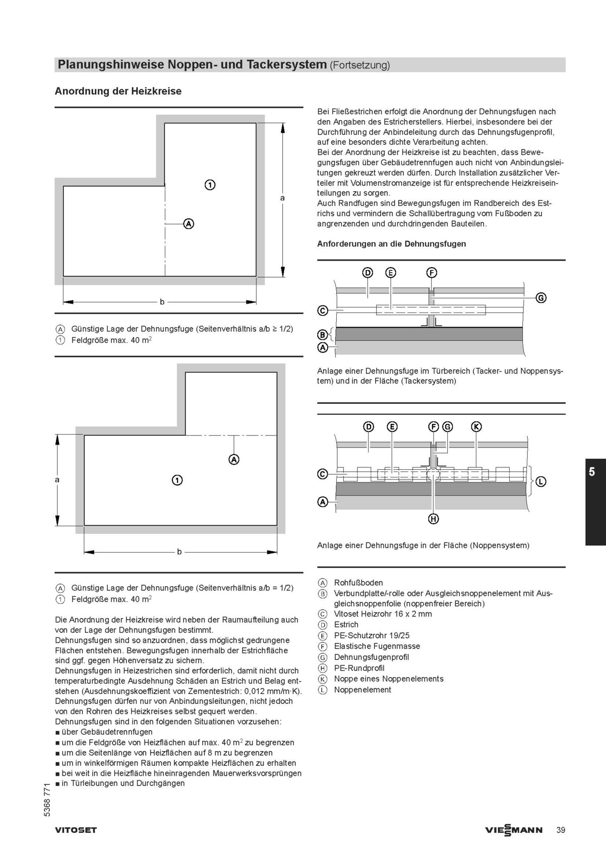

Golfi9028 Feb 2020 11:49
As far as I understand, these are Viessmann pipes...
This is what I found...
Technical drawings of the stud and stapler system: heating circuit arrangement and layout
