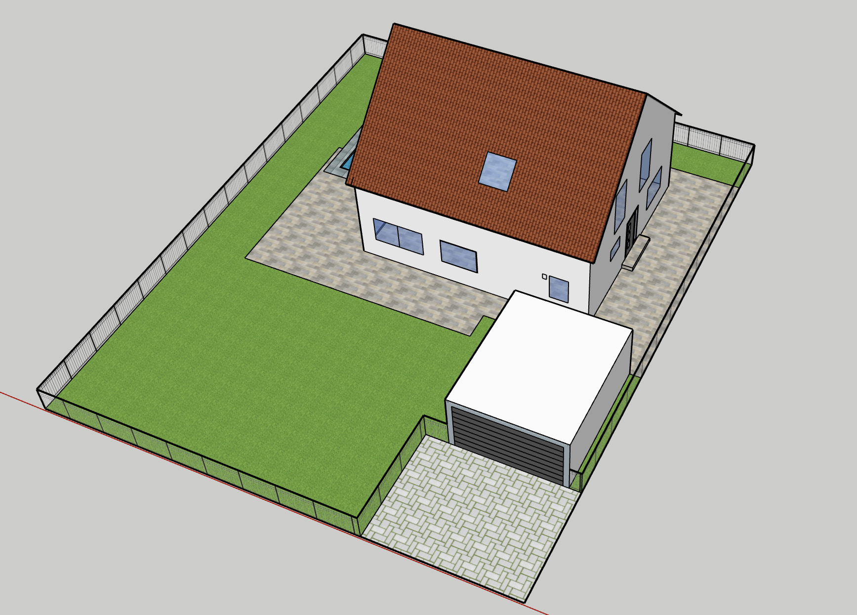

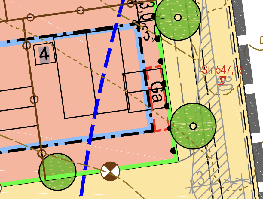

The house will have a footprint of about 80 sqm (860 sq ft). We plan to build with a basement (please keep discussions about this elsewhere). Access to the plot will be from the south, and so the driveway must also enter from the south (see image in the attachment, red box). However, the pedestrian entrance can be from the east. For budget reasons, we need to keep the construction “simple,” so a high-end masonry garage fully integrated into the house is out of the question. We are still debating whether to make the garage deep or wide (a large open garage). We only need space for one car at the moment, but we also require storage for wintering garden furniture and bicycles.

Development plan/restrictions
Plot size: 511 sqm (5500 sq ft)
Slope: gently sloping to the south
Site coverage ratio: 0.25
Floor area ratio: 1.5
Building envelope, building line and boundary: 3 m (10 ft) from the property line, 0.5 m (1.5 ft) for the garage (see attachments, red box for garage)

Did I read somewhere why the driveway absolutely has to be on the south side?
Heimwerker081513 Apr 2026 17:39Have I read somewhere why the driveway must necessarily be on the south side? Because there is a green strip along the road to the east, and the neighbors to the north and west would not be pleased.
nordanney13 Apr 2026 18:28Heimwerker0815 schrieb:
Because there is a green strip along the street to the east, the neighbors to the north and west would not be pleased. So? Is a driveway prohibited there? That’s why I’m asking. Otherwise, there could still be some options available.
Heimwerker081513 Apr 2026 21:53Yes, it is prohibited. The driveway must be accessed from the south.
