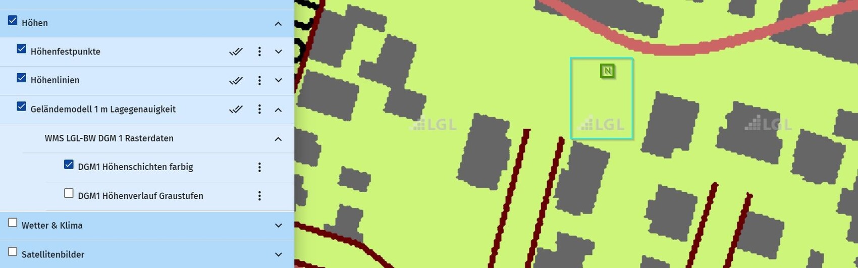

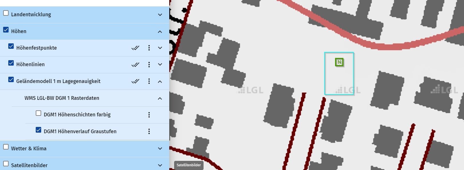

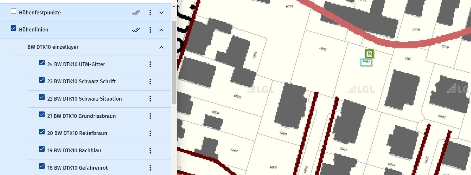

@11ant Thank you for the tip. I think I have found what I was looking for.
I have created one image each with contour lines (all contour lines activated except living areas), elevation layers, and elevation profile.
If I interpret these correctly, the plot is flat. Or am I looking at it wrong? 🙂
@Gartenfreund We did not plan a vegetable garden. Maybe a raised bed with some herbs. But that’s about it. Our garden area won’t be very extensive. A smart home will warn and protect you against a leaking washing machine 😉. But of course, everyone has their own preferences. We have also talked to several people who built without a basement, and the general consensus was always, “We would do it the same way again.” A frequently mentioned advantage — especially from people who previously had a basement — was that you don’t accumulate as many unnecessary things because you tend to use the available storage space more carefully.
We will definitely get quotes from basement builders as soon as the soil survey report is available. We were also advised not to get the basement through the prefabricated house company.
Cadastral map view with property parcels and layers
