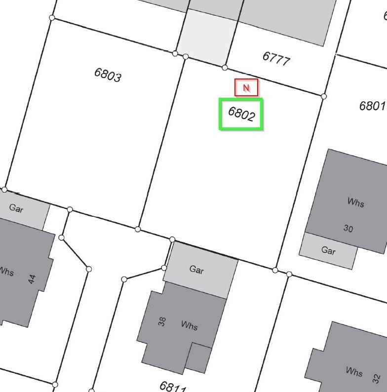

maybe this thread is a bit early since we don’t have a planned floor plan yet. But we would still appreciate your advice. First of all, because this is probably the most important information: We are planning with a budget of 600,000 euros for the house plus additional building-related costs. We have received approval to purchase the plot shown here. We will sign the purchase contract at the end of next week. Now to our problem:
We are very uncertain about which is the better decision for our plot: a (partial) basement with a smaller floor plan (about 130 – 140 m² (1400 – 1500 sq ft)) (Option A), or a slab foundation with a slightly larger floor plan (about 170 m² (1800 sq ft)) (Option B).

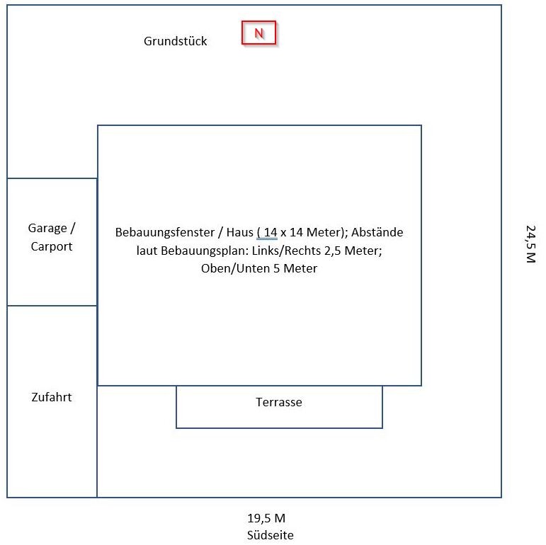

We would be interested in your opinion on how you would build on this plot. I have made a very rough sketch of how we imagine the orientation of the house and placement of parking spaces, etc. I have also attached the site plan and development plan. The questionnaire is mostly filled out, but a “final” floor plan is still missing, as mentioned. This will also largely depend on the question of whether to have a basement or not.

Plot size 477 m² (5130 sq ft)
Slope Minimal
Plot ratio (ground coverage ratio) 0.3
Floor area ratio 0.8
Building envelope, building line, boundary 14 x 14 meters (see image)
Edge development see image
Number of parking spaces unknown
Building height up to 2 full stories
Roof type Hip roof or gable roof 30-40 degrees
Architectural style unknown
Orientation unknown
Maximum height / limits unknown
Other requirements unknown

Maybe I didn’t express myself clearly enough in my initial post. When I mention the square meter values in the floor plans, I always mean the living area — distributed over the two full floors.
Using the example from post #3, I have a house with external dimensions of 12 x 9.5 meters, which results in a built-up area of 114 sqm (square meters).
I calculated: 477 * 0.3 = 143.1 sqm additional, of which 50% for ancillary areas would be about 71 sqm.
In this example, I would still have 143.1 sqm - 114 sqm + 71 sqm = 100 sqm “left over” for ancillary areas.
Is it unrealistic to manage with that?
If it matters: Our development plan is from 1989 — so the building regulations from 1986 should apply here.
@kbt09 Sorry, I can no longer update the initial post. So here again are the plans with the north directions marked. I hope this is clear. I rotated the development plan so that the orientation matches in all plans.
