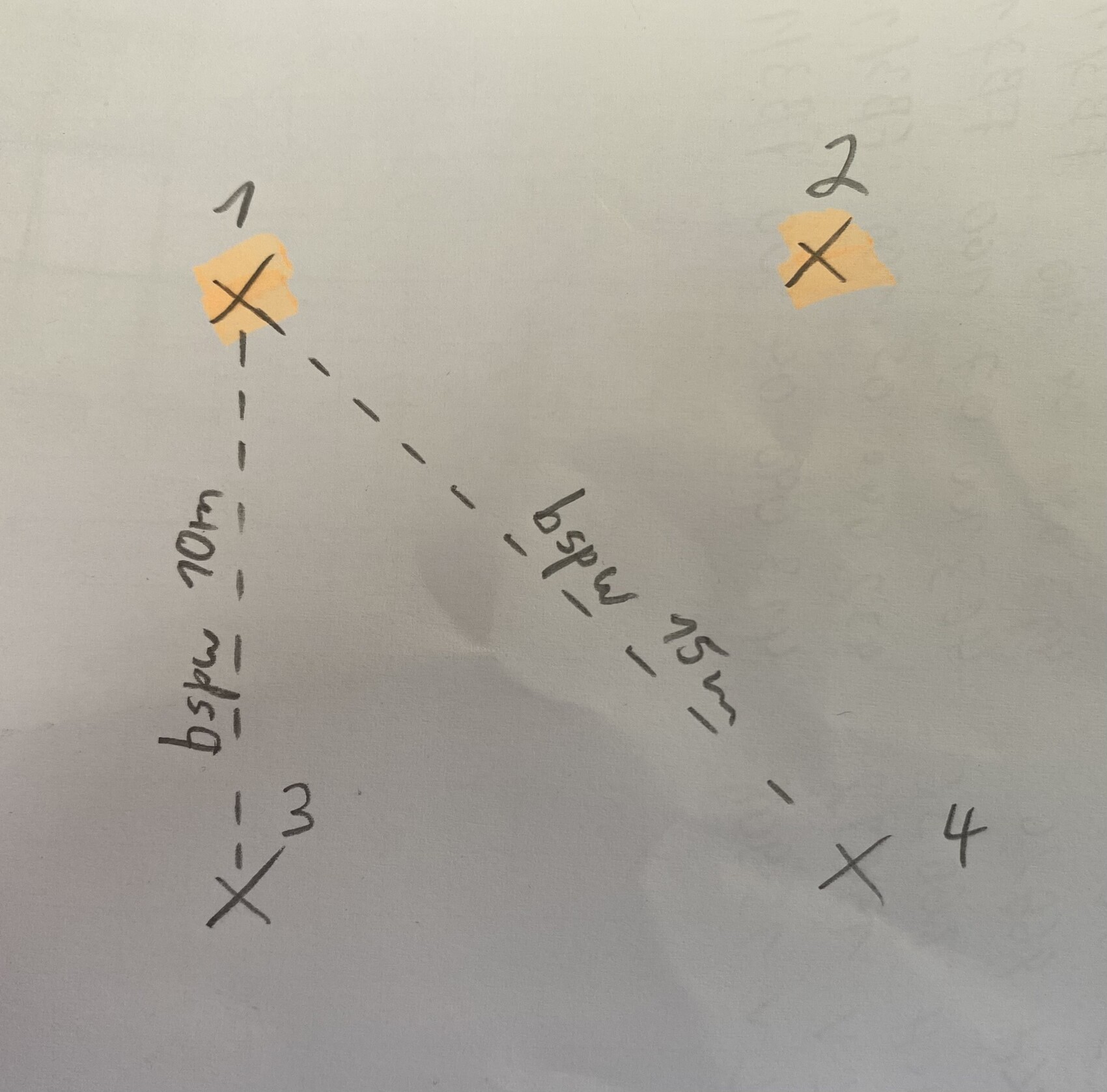

Look up what a BATTEN ARC means or post a sketch. It should show the boundary lengths to the now missing points.

Points 1 and 2 are gone.
From point 3, use a measuring tape to draw an arc with a radius of 10m (33 feet) where point 1 could approximately be located. Do the same from point 4 with a radius of 15m (49 feet).
Where both arcs intersect and form a cross is your point 1. Repeat the same process similarly to determine point 2.
