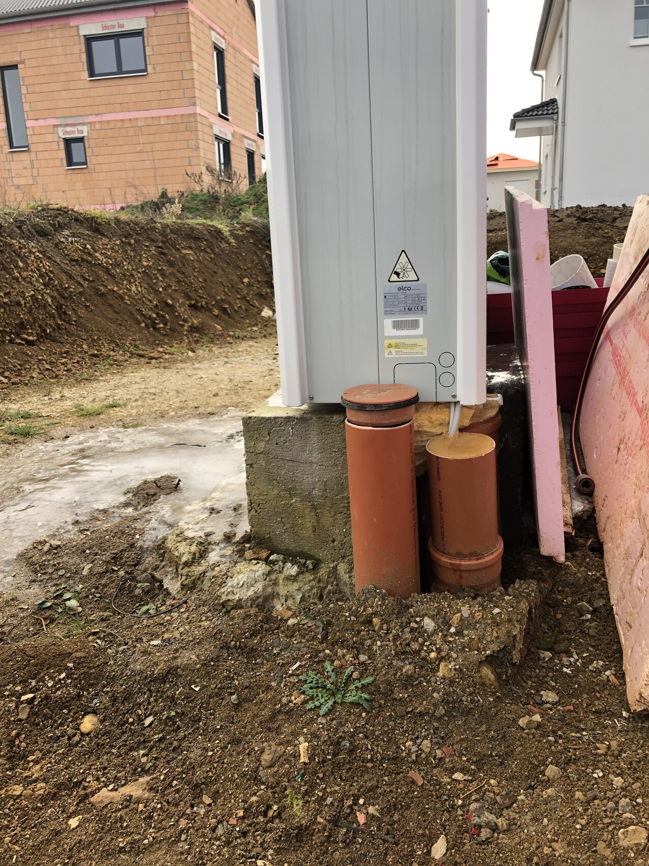

boxandroof26 Jan 2020 10:41How is the drainage for the heat pump planned?
If no defrost water accumulates inside the unit and the drainage path from the heat pump itself remains clear, it’s not a big issue initially. But usually, that’s not the case; the water should also be directed away from the house.
Is the drain simply not yet connected to the drainage system? It looks like a PVC pipe (commonly used for underground drainage) still needs to be connected at the front, but it’s not visible in the picture. If that’s the case, I would first enlarge the hole where the small ice patch currently is so that water can drain over a larger area and doesn’t freeze up to the heat pump.
The outdoor unit usually has a condensate drain. Currently, it just drains onto the sloped ground, but this will likely change. It will either be connected to the drainage system or directed into a gravel bed for infiltration. The amount of water is not an issue right now, just a small puddle. It actually rains more here in two minutes. No need to worry.

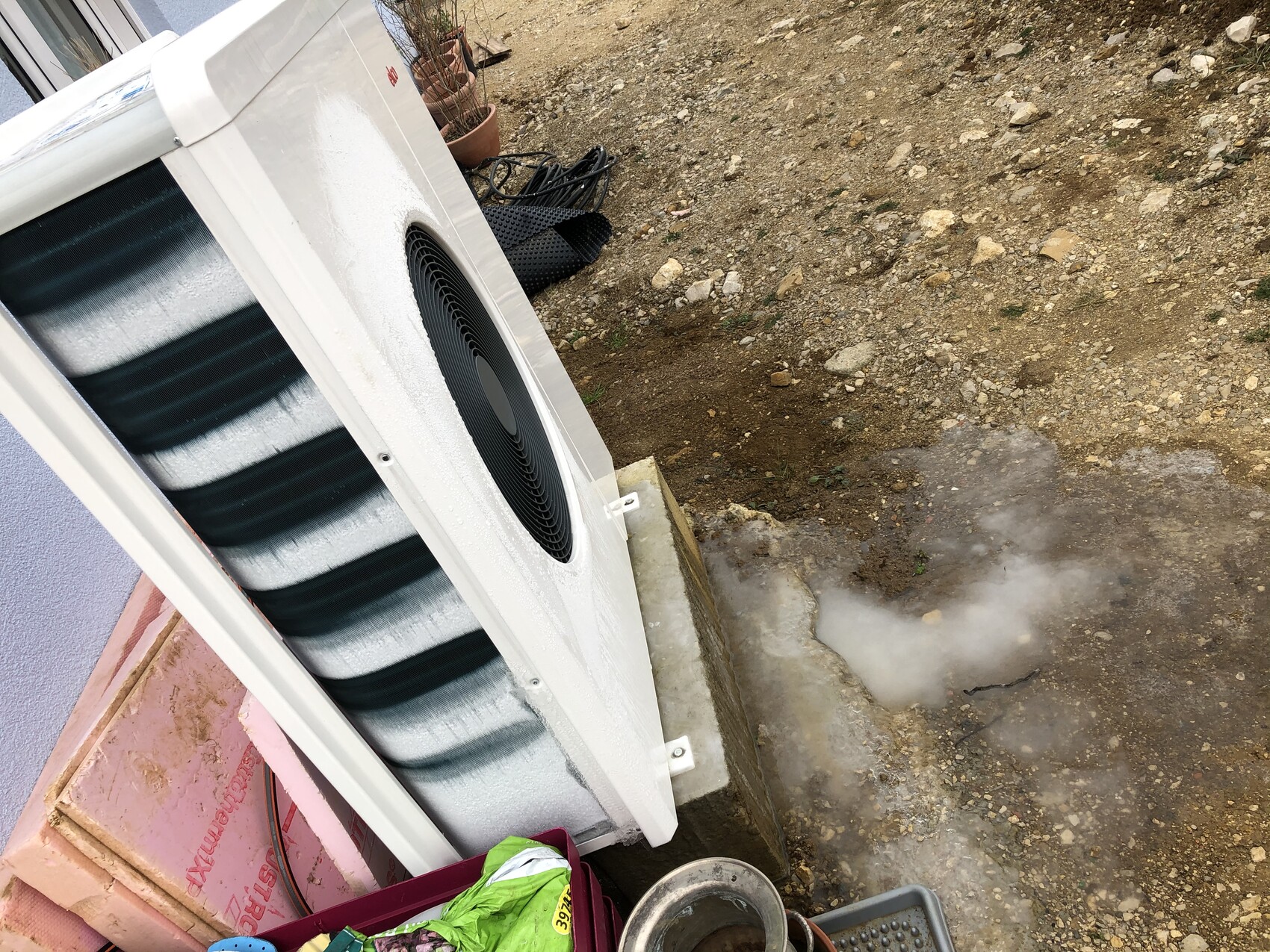

The heat pump itself should defrost to operate efficiently.
boxandroof26 Jan 2020 16:26I rarely get ice on the unit itself, only on the exchanger, but depending on the weather, that’s probably normal and it will thaw eventually.
