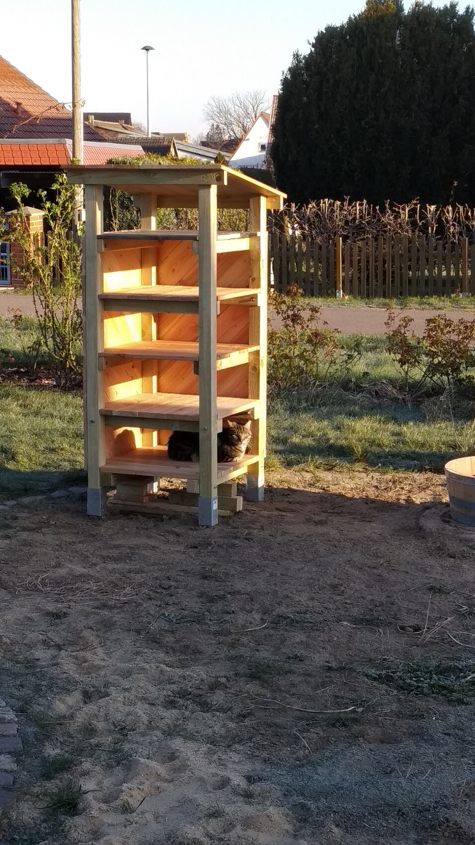

So, the hotel is 1.80 m high (5 feet 11 inches) – simply because the beams were that long and we didn’t want to cut anything off unnecessarily. I’ll take some photos as soon as we set it up and I have time. Sorry, that might take a little while, one anniversary follows another at the moment.

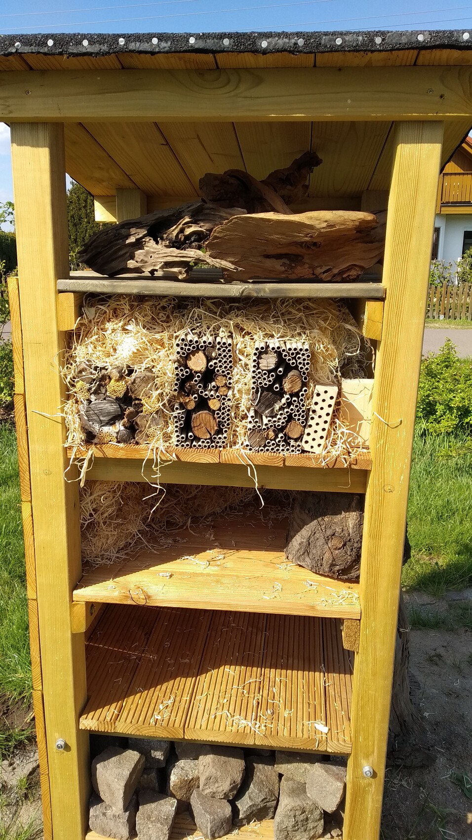

I’ve started inserting the first tubes. They are made of cardboard and coated with plaster on the back. The wood wool is meant to further block drafts from behind and to make it look a bit nicer. I mixed in some branches in between to add some texture and to help the bees find their "holes" more easily. As you can see, it’s just a beginning. The drilling is already in progress (phew!) – so there will be some cherry wood logs added as well. I also ordered a lot of bamboo sticks, which I’d like to add. They’re actually a bit too big, but maybe I can attract the blue carpenter bee. It was already checking things out yesterday... almost "flew me over." That would be cool.
