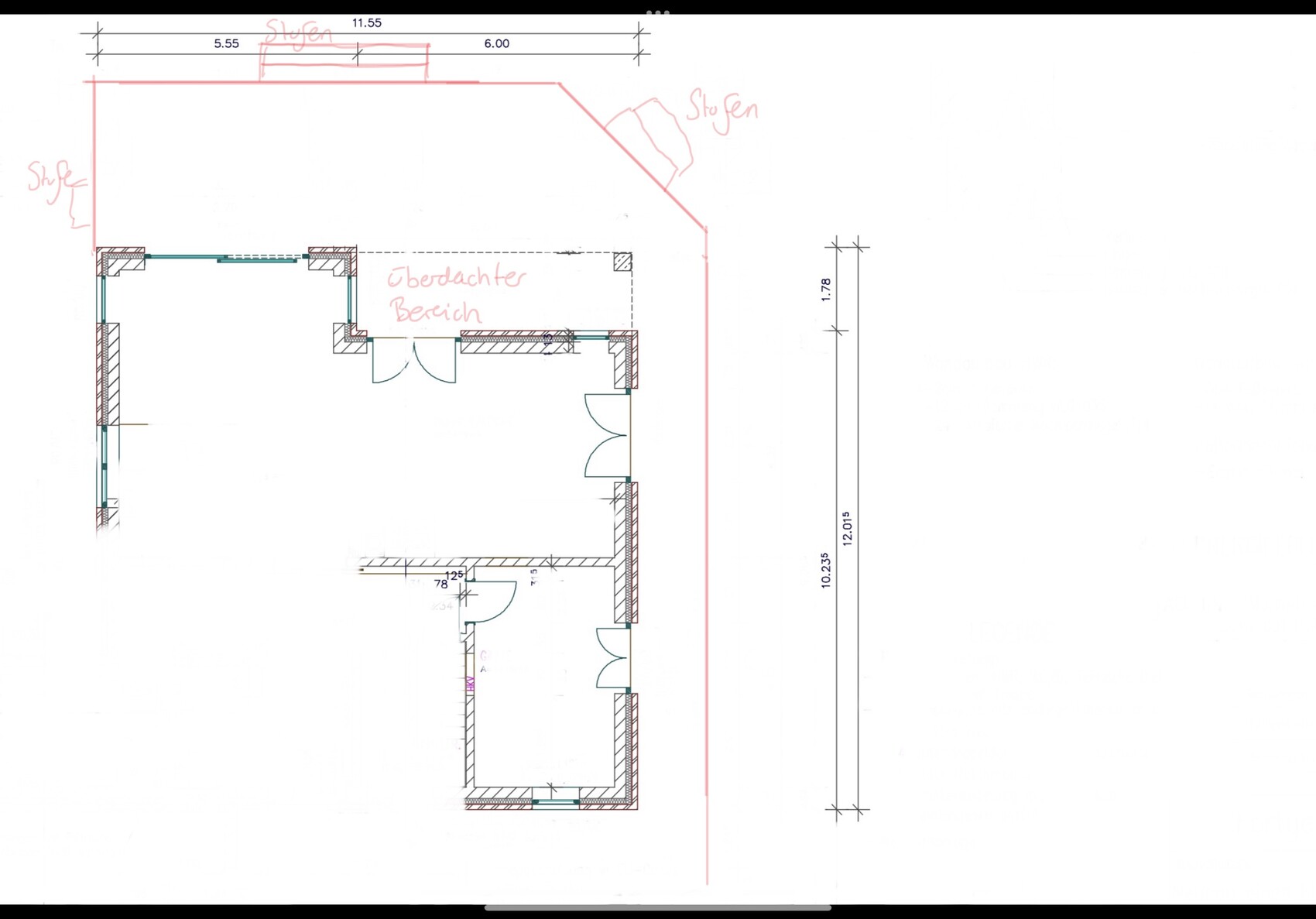

Hello, I am currently working on building my terrace. A WPC decking is planned. First, the borders need to be installed. How would you create the slope according to the attached sketch? Thanks for your feedback.

The angled C does not bother us; the terrace, including the covered area, has a depth of 4.80 m (16 feet). We have already arranged our garden furniture for a test setup. In the covered area, we plan to work with a 0% slope to avoid any edges.

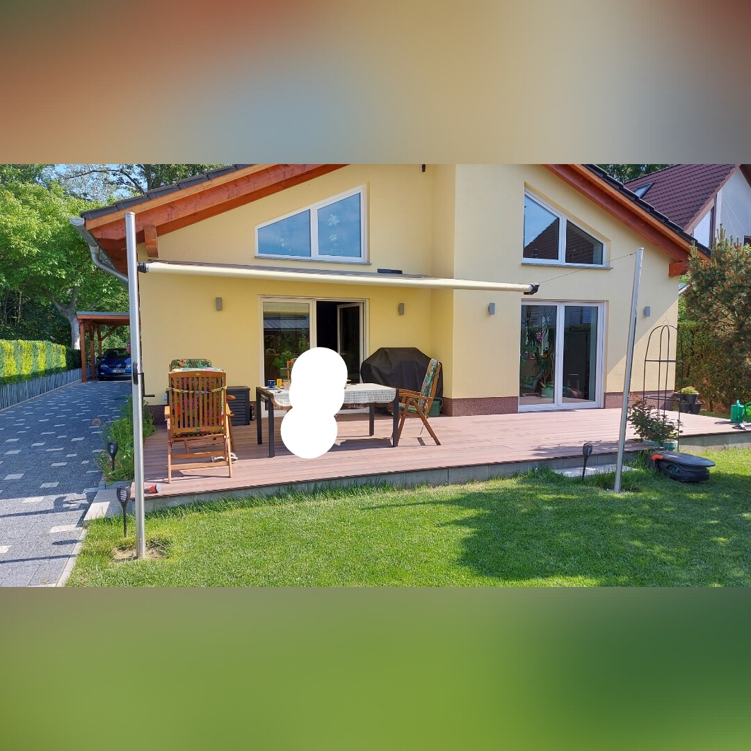

We also have a depth of 4.60 m (15 ft), and sometimes up to 12 people sit at the table. For shade, we use an electric sun sail above it.

Ah, interesting, do you have a step at the floor-to-ceiling window due to the slope?
Nida35a23 Oct 2024 22:32
Yes, 2cm (0.8 inches) at the right door,
in your case, the highest point would be under the porch roof.
Make sure there is a slope everywhere; the water must drain away from the house during heavy rain.
The doors and windows are not waterproof. If water stands on the outside, it will also enter inside.
