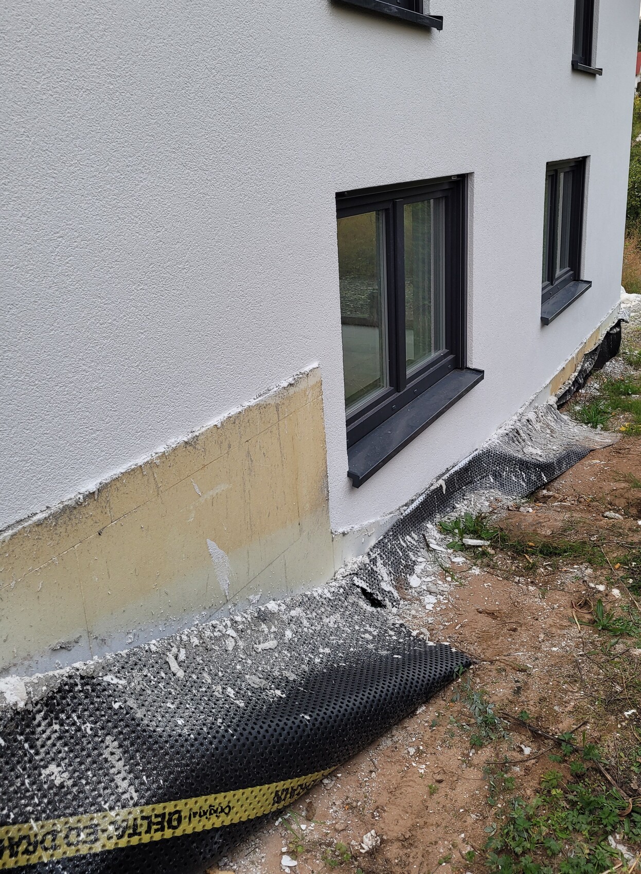

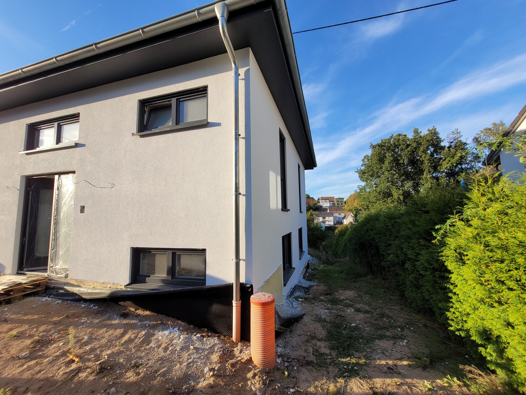

Are there proper solutions to ensure that the drainage membrane or the perimeter insulation is no longer visible and also does not get damp from above due to backflow? The lower part (soil level) has been waterproofed using torch-on membranes and sealing slurry. Would closing profiles on the drainage membrane combined with a gravel strip be advisable here?
Thank you
Weißes Haus im Bau mit Erdarbeiten, orange Drainagerohr am Fundament, Garten rechts.
Außenwand eines Hauses mit grauem Putz, dunklen Fensterrahmen, Absperrband und Fundamentarbeiten.

What does the wall construction look like? How was the waterproofing done? Base coat plaster?

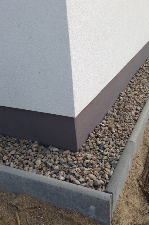

Normally, it looks like this at the end. Of course, the wall is waterproofed, then base coat plaster (and/or waterproof slurry) is applied, the area is backfilled with soil, followed by gravel. The drainage sheet is simply cut to fit. Water running behind it is not an issue.
Exterior wall with white facade, dark base coat, gravel bed and curb at the foundation.

Thank you very much for your feedback.
We have consulted a professional on site. Everything seems to be in order, just not yet finished, which makes it a bit confusing for me as a layperson.

Will soil still be added there? Or will it remain at this level?
Someone must have made some plans...
Ducki123
18 Oct 2023 10:42
lastdrop schrieb:
Will soil be added there? Or will it remain at this level?
Someone must have planned something ...
It will be filled in and surrounded by gravel to protect against dirt splashes.
