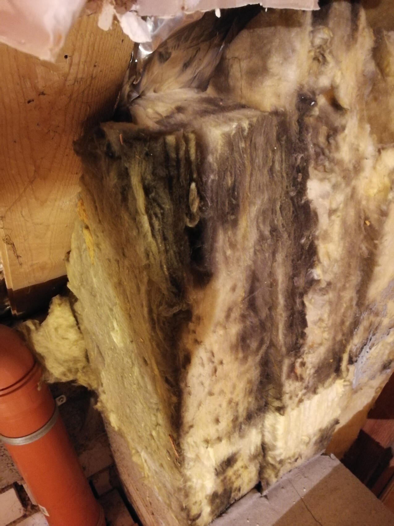

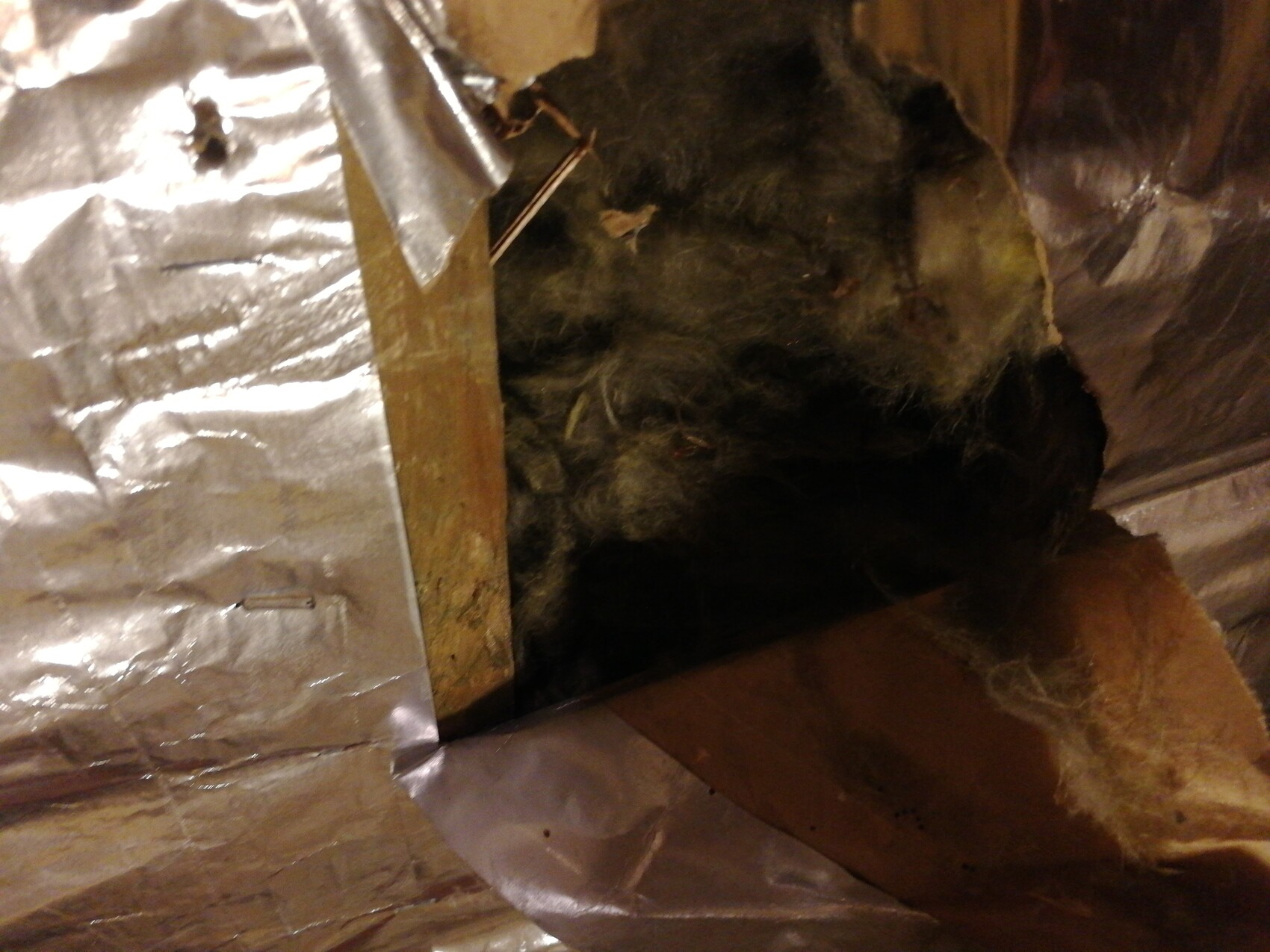

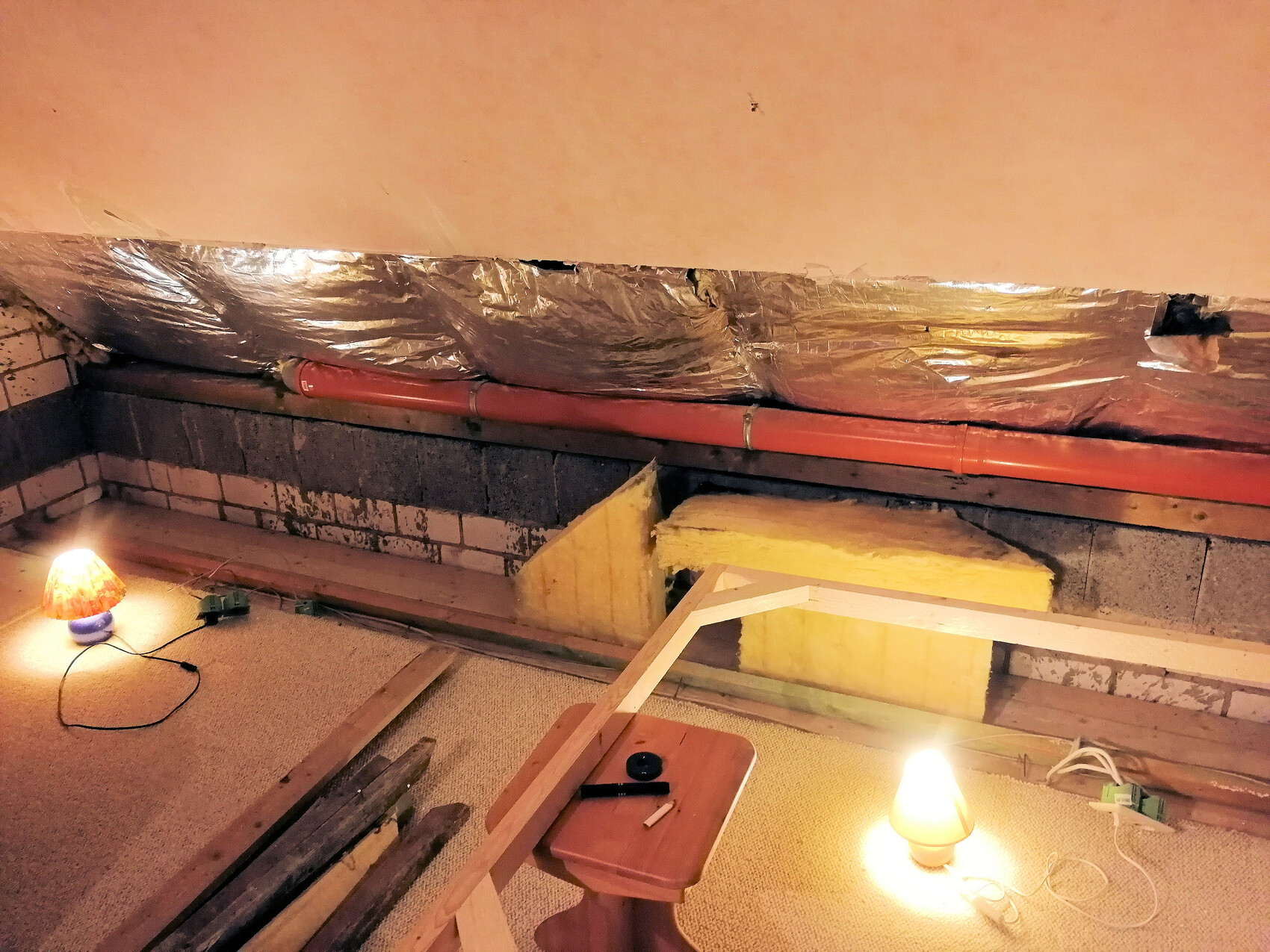

The other rooms are not relevant since they all have concrete ceilings and no ring beam. This concerns an extension, yes, with a beam ceiling, wooden floor, and impact sound insulation as shown in the pictures. The room was improperly insulated with aluminum-coated insulation material, but the knee wall was not insulated. Because of this, cold air is coming through the gap where the floorboards join into the room below. Furthermore, moisture penetrated the insulation, causing it to start molding. At the moment, I am carefully in the process of gutting everything. I have attached a few pictures...
No partial insulation should be installed in the knee wall; rather, ventilation openings are needed so that the cooler air from the cavity can flow more easily into the living space and warm up.
The same vapor retarder also has the same Sd value. However, vapor diffusion should always be ensured.
Who would expect mold in this case?
