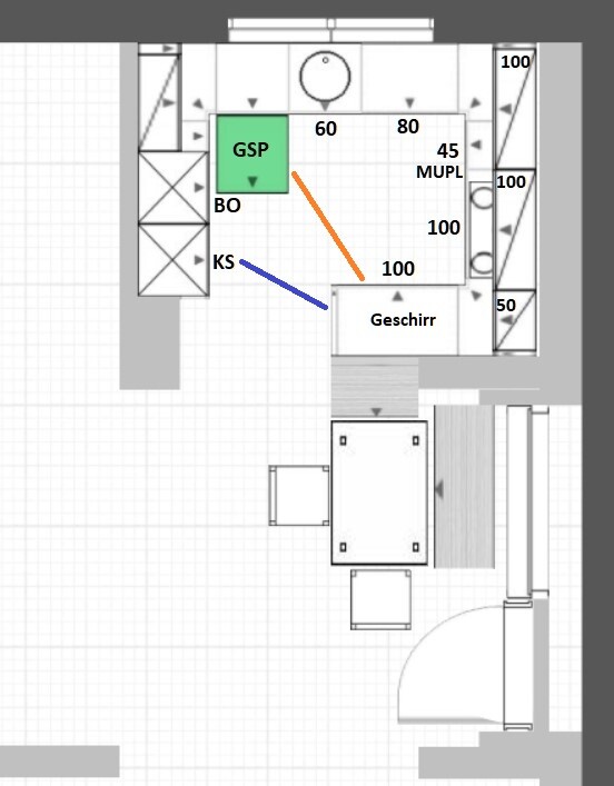

I can create a plan with cabinets exactly as I want them, regardless of the grid, color, or height. Then I can simply add notes using a basic paint program, including descriptions, dimensions, and so on.
Example
From the wall on the left side of the plan:
65cm (26 inches) blind corner cabinet
60cm (24 inches) dishwasher
60cm (24 inches) base cabinet with sink
This means my plumbing connections need to be centered behind the sink base cabinet, roughly at 155cm (61 inches) from the left side of the plan. It doesn’t get any easier than that.

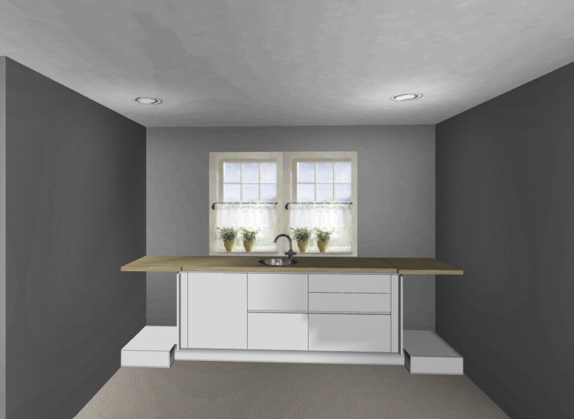

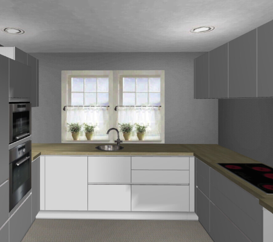

I can also create elevation views with this.
Example
evelinoz schrieb:
one square is 10 x 10 cm (4 x 4 inches) … more like 50 x 50 cm (20 x 20 inches) 😉
