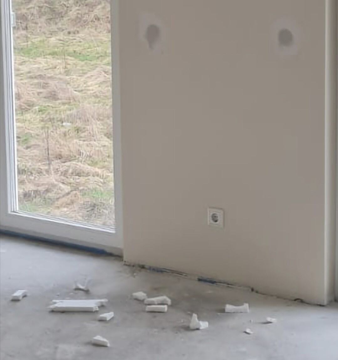

Is there a photo of that spot?I seem to recall the term Styrofoam was actually mentioned. In any case, neither XPS nor EPS.Fortunately, we have a photo:
Allthewayup28 Feb 2024 20:00The fragments actually look more like EPS ("Styrofoam") than XPS. They appear to be about the same thickness as the impact sound insulation under the screed.
I’m not an expert on whether the general contractor (GC) is allowed to do this, but as a homeowner, I wouldn’t accept it. The significantly lower load-bearing capacity could cause problems if anything is ever mounted on this wall, especially in this particular spot.
Just kindly ask them to fill it with a building material that at least roughly matches the strength properties of your expanded clay aggregate. It doesn’t matter whether they use slot plaster or lightweight masonry mortar—either way, it’s definitely better than Styrofoam.
