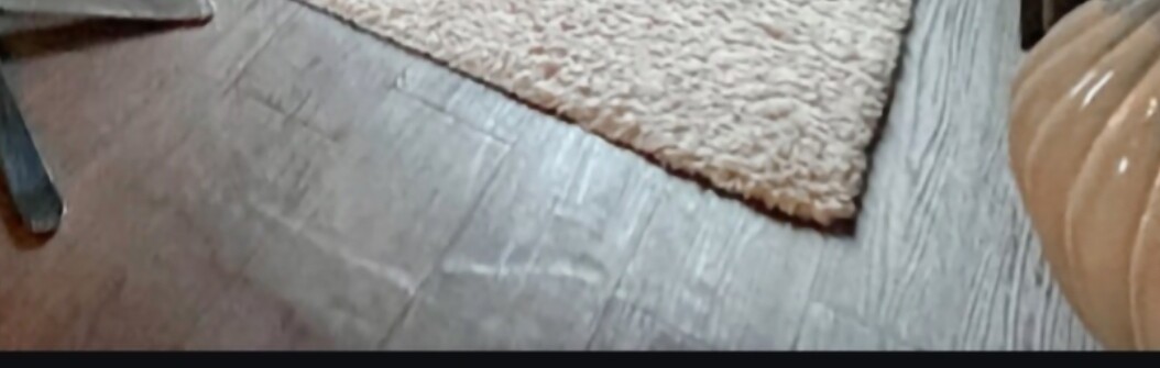

Christian197114 Dec 2024 15:09Thanks first of all. The previous owners are still living there, so I will try to see if I can somehow take a photo of the base. I have attached a photo from the listing, where you can clearly see the unevenness of the floor on the ground floor and also a slight discoloration. We are just wondering if something like this can occur without any moisture. But if that can’t be answered clearly, it’s not very helpful.
nordanney14 Dec 2024 15:14It’s really a bumpy surface. Personally, I would guess that the screed is simply uneven.
Color changes in vinyl due to moisture are possible, but for that, you would need a) the appropriate ("cheap") vinyl and b) a lot of moisture. Before that happens, you should already find a significant amount of moisture or mold on the walls.
P.S. An inspection with an expert who can answer these questions directly is money well spent when buying a house.
