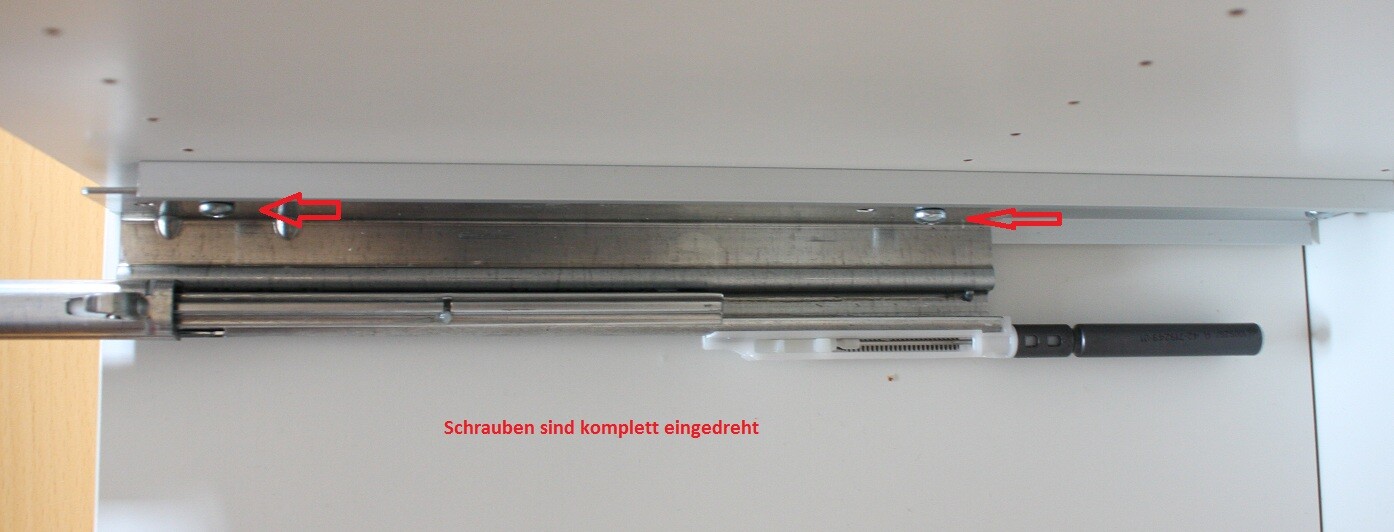

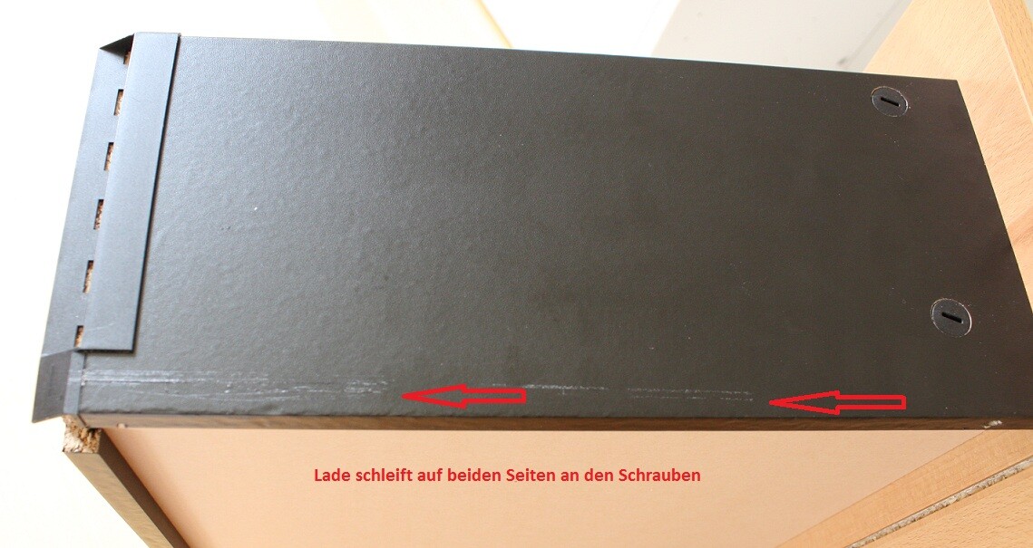

We are having difficulties assembling Besta. We have it as a drawer cabinet with the Inreda full-extension drawers. In 50% of the drawers, there is already scratching when inserting them into the slides. Can anyone help us? Everything is level, and the slides are installed correctly.
Supergrobi_20021 Sep 2010 19:02The same problem still persists...
The solution to leave out the screw in the middle doesn’t work for me because the drawer tilts forward or backward when pulled out or pushed in.
The automatic self-closing mechanism doesn’t work at all :eek ((
Fixing it with a countersunk screw in the middle also didn’t achieve the desired result.

Maverick18542 Sep 2010 09:05Do you happen to have some countersunk screws?
If so, swap them with the pan head screws, then everything will be fine...

Supergrobi_20022 Sep 2010 13:02Hi Maverick,
I tested the countersunk screws and used a countersink tool to achieve the appropriate recess depth. This solved the issue of the screws rubbing.
However, the drawer still doesn’t close properly; it becomes difficult to move halfway, and the automatic pull-in at the end doesn’t work at all. Without the drawer, everything operates smoothly and easily… I’m still investigating.
