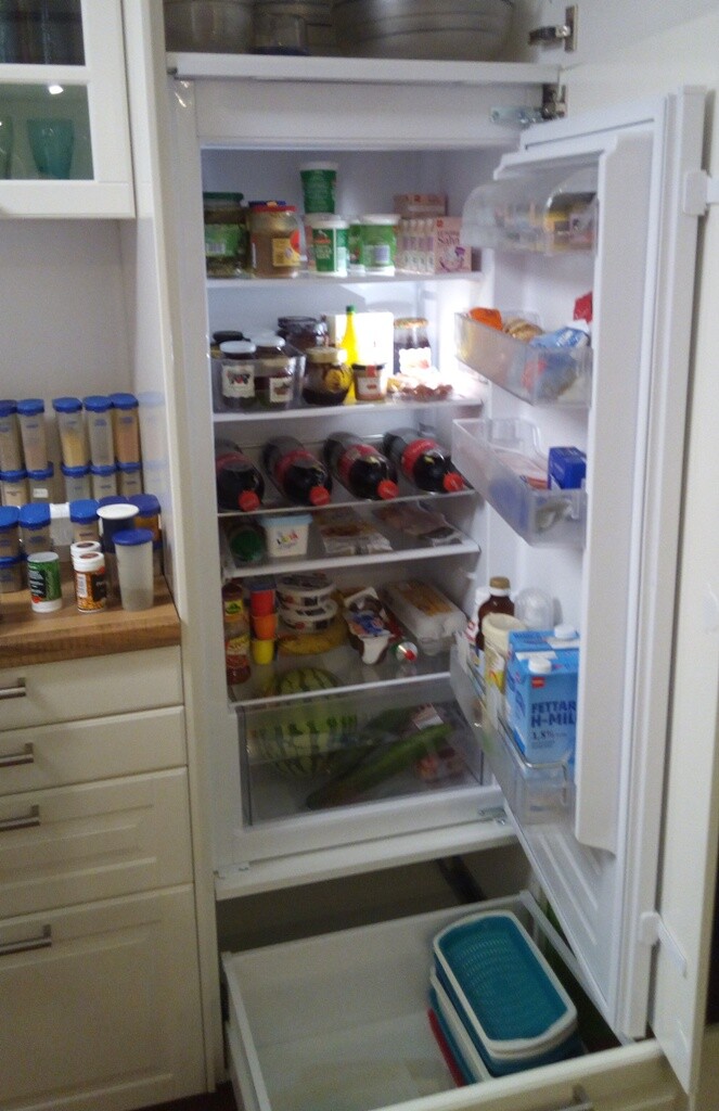

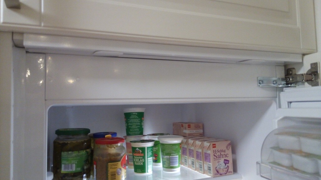

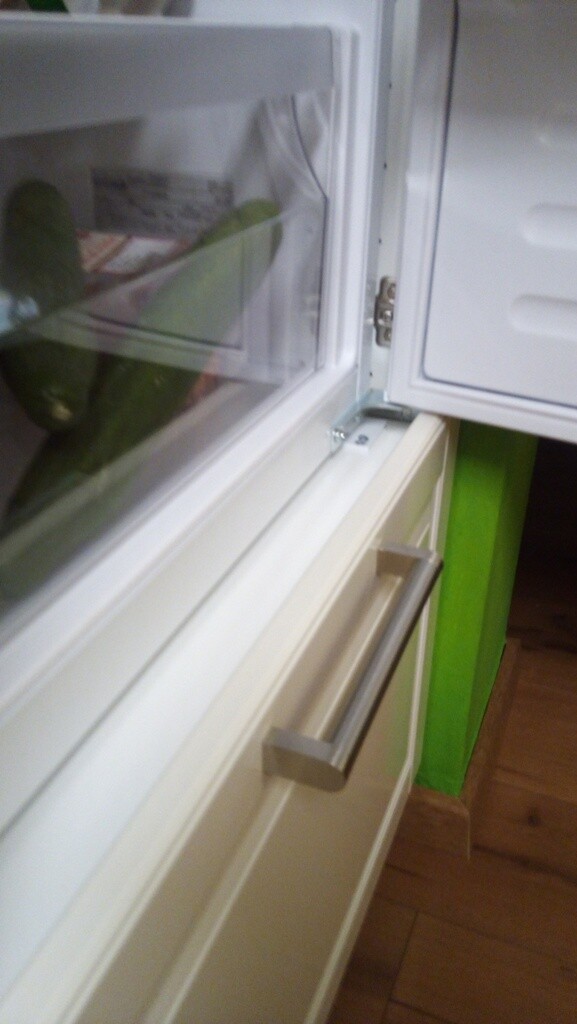

nachtvogel27 Aug 2016 02:17So, the photos are taken............
Here is the cabinet with the door open.
You can clearly see that the refrigerator door is still larger than the rest of the fridge.
If I imagine, it would be another 20cm (8 inches) wider.
At the top, the metal trim of the refrigerator extends slightly over the upper shelf.
This can only be seen from inside the refrigerator.
At the bottom, the drawer front extends slightly beyond the refrigerator base.

IKEA-Experte27 Aug 2016 10:59Many craftsmen could take this as an example of what precise work means.
@sabine: Thank you so much for the photos and the great description in your other thread. That’s really helpful and very kind of you.
I just measured the height of my refrigerator door; it’s almost exactly 95cm (37 inches) tall. However, since the fridge has a fixed door system and the hinges extend about 2.5cm (1 inch) beyond the door at both top and bottom, and need to be covered from the front, the total height is exactly 100cm (39 inches). So, the 100cm (39-inch) Sävedal front/door would just fit.
I would also use a drawer under the refrigerator that slightly overlaps the fridge’s plinth, just like in your photo. So that would work as well, but my next issue is the microwave I planned to place above the fridge. It’s only 38.8cm (15.25 inches) tall, so there would be an additional gap of 6mm (0.25 inch) both below and above the microwave. Do you have any ideas on how to deal with this?
