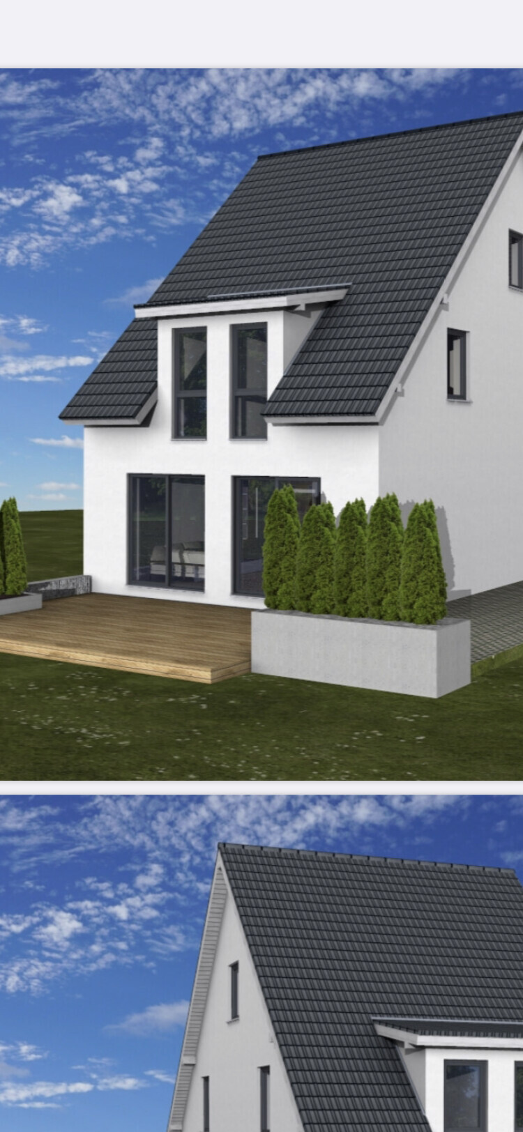

I have a small problem. We are extending an existing semi-detached house (each semi-detached unit is 7 meters (23 feet) wide). During the entire planning phase, a dormer measuring 3 meters (10 feet) wide was planned. Dormers of this size can also be found on neighboring houses in the area (same planning regulations). But not on the immediate neighbor’s house.
Yesterday, I had a phone call with the architect, who pointed out the planning regulations:
“The total width of dormers on each side of the building must not exceed half of the building’s width, and the width of each individual dormer must not be more than one third of the building’s width. The maximum dormer width is set at 3.0 meters (10 feet).
Side gables are allowed with a maximum width of half the building’s width. The combined width of dormers and side gables must not exceed half of the building’s width. The wall height of the side gables and the main building must be identical. The ridge of the side gables must be at least 1.0 meter (3 feet) below the ridge of the main building.”
According to this, the dormer would have to be 2.30 meters (7.5 feet) wide. I wonder how the neighbors managed to do it. All neighbors received their building permits via the simplified procedure.
Could it be that if the dormer extends over two rooms, it is counted as two separate dormers?
Does anyone here perhaps have an explanation?

Sedax182 schrieb:
Does anyone here possibly have an explanation?
In my opinion, your pictures do not show a dormer. A dormer is built on top of the roof rafters.
I believe this is more likely a transverse gable and would therefore be covered by the regulations for secondary gables.
You cannot see from here what the neighbors have or how wide it is.

guckuck2 schrieb:
In my opinion, your pictures do not show a dormer. A dormer is built onto the rafters of the roof.
I think this is more accurately described as a transverse gable and would therefore fall under the regulations for secondary gables.
You can’t see what the neighbors have or how wide it is here
It looks the same at the neighbors’ houses.
I didn’t want to take pictures of other people’s homes specifically.

I assume that by "side gable," a cross-gable is meant. A cross-gable differs from a dormer in that it is structurally supported directly on the exterior wall of the floor below, whereas a dormer is a roof extension built on the rafters. In terms of building regulations, for example concerning setback distances, a minimum offset from the exterior wall of one row of bricks or 50cm (20 inches) is often required.

Escroda schrieb:
I assume that by "side gable" you mean a dormer roof extension. A dormer roof extension differs from a dormer window in that it structurally rests on the exterior wall of the floor below, while a dormer window is constructed on the roof rafters. In building regulations, for example regarding setback requirements, a minimum offset from the exterior wall of one brick course or 50cm (20 inches) is often required.
"One dormer window" is singular, "the surrounding neighbors" is plural. Are there multiple dormer windows in the area, all clearly subject to the same textual regulations, that do not comply with these requirements?
Our plot is located along a bypass road. For all semi-detached houses along this bypass road, the same development plan applies. I asked three neighbors about the width of their dormer windows. Their answer was 3 meters (10 feet).
