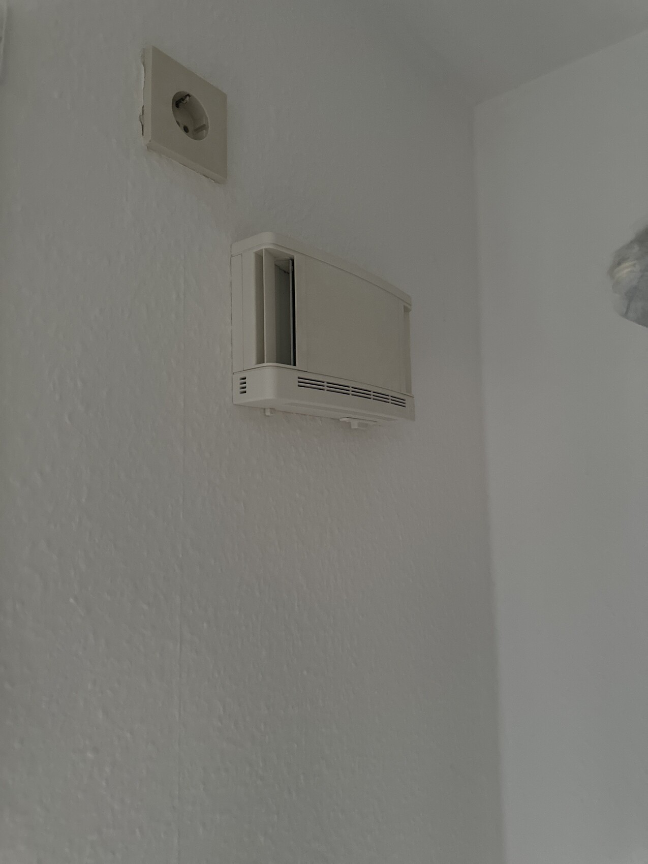

bluetoothtony7 Apr 2024 22:26Hello everyone,
I have a problem with humidity in my apartment.
All rooms have humidity levels between 55% and 70% despite regular ventilation.
A few months ago, we had mold remediation done, and now we want to solve this problem because we only took ownership of this condominium a few months ago. The previous owner paid for the mold remediation.
Each room has a 100mm (4 inch) hole for air exchange.
There is a fan in the bathroom that is supposed to create negative pressure inside the apartment.
I think this system simply does not work properly.
Now, my idea is to install a decentralized ventilation unit in each of the 100mm (4 inch) ducts, set to activate based on certain humidity levels, and then I would have peace of mind.
However, I am not sure if the 100mm (4 inch) duct diameter is sufficient.
Increasing the size is difficult because I need approval from the other owners, and that takes time...
Would this work?
Thanks in advance for your opinions.

You can already get a hint of the beginning: What happened there? What was renovated and why?We had mold on two exterior walls.
A mold specialist inspected all the rooms and concluded that the mold was likely caused by cold exterior walls and poor air circulation (the bed and couch were placed against the walls).
The entire plaster was removed, and then calcium silicate boards were installed.
bluetoothtony8 Apr 2024 19:39SoL schrieb:
A hole in the wall leading outside??? Like, just looking out and hoping no critters get in and that there’s no draft? We have a 100mm (4 inch) hole in every room with a plastic flap covering it.
Inside, there is only a mesh screen to keep insects from entering the apartment.
But no fans or anything like that.
