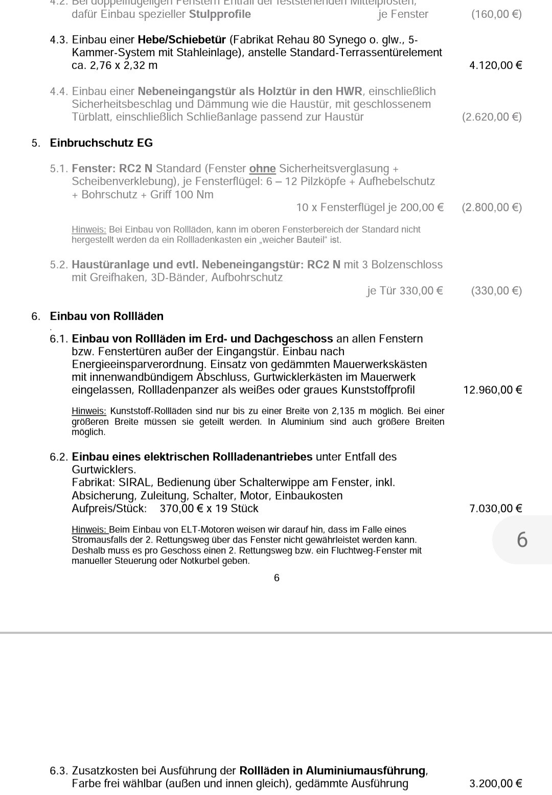

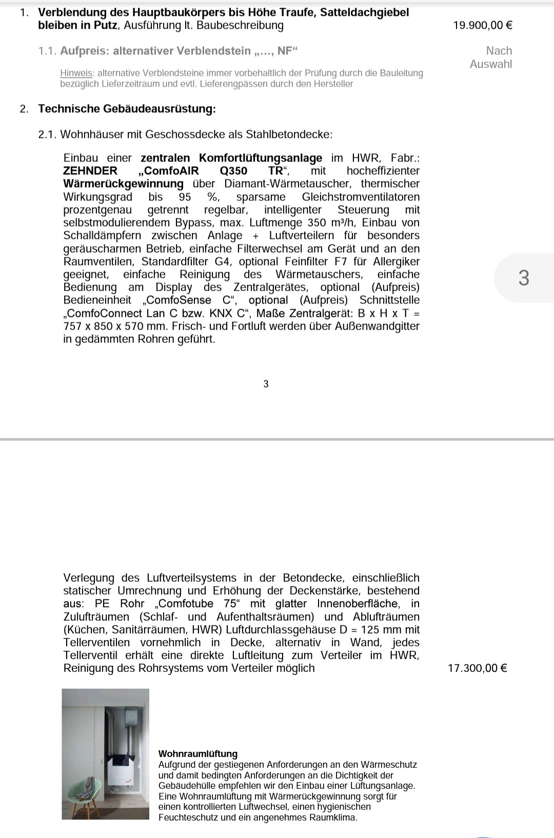

Hello, we have received what we consider a quite good house construction offer from a developer for a single-family home with 161m² (1,733 sq ft) of living space. However, we are puzzled by three items that seem completely overpriced to us:
- Installation of a central comfort ventilation system in the utility room, brand: Zehnder “ComfoAIR Q350 TR,” with highly efficient heat recovery for €17,300
- Cladding of the main building up to the eaves height, with the gable of the pitched roof remaining plastered, for €19,900 (would brick slips be cheaper to apply afterward?)
- Installation of a lifting/sliding door (brand: Rehau 80 Synego or equivalent, 5-chamber system with steel reinforcement) instead of the standard patio door element, approximately 2.76 x 2.32m (9.1 x 7.6 ft), for €4,120
- Installation of a total of 19 aluminum roller shutters (three of which are wider in the living-dining area) with electric roller shutter motors, color freely selectable, for a total of €23,190
Do you see any potential to save here? Is it possible to contract the above work separately? What have you paid for similar items?
Thank you and best regards

Aluminum roller shutters definitely seem too expensive.
Here are our costs for comparison:
- Color of choice for all windows €2,400
- Aluminum roller shutters €4,200
- Electric drives with switches about €2,000
Total around €8,600
DominicHannove
18 Sep 2022 16:48
danielohondo schrieb:
Aluminum roller shutters are clearly too expensive.
- Custom color: €2400 for all windows
- Aluminum roller shutters: €4200
- Electric drives with switches approx. €2000
Total about €8600 overall.
How many windows does that price cover? And when was the offer made?
