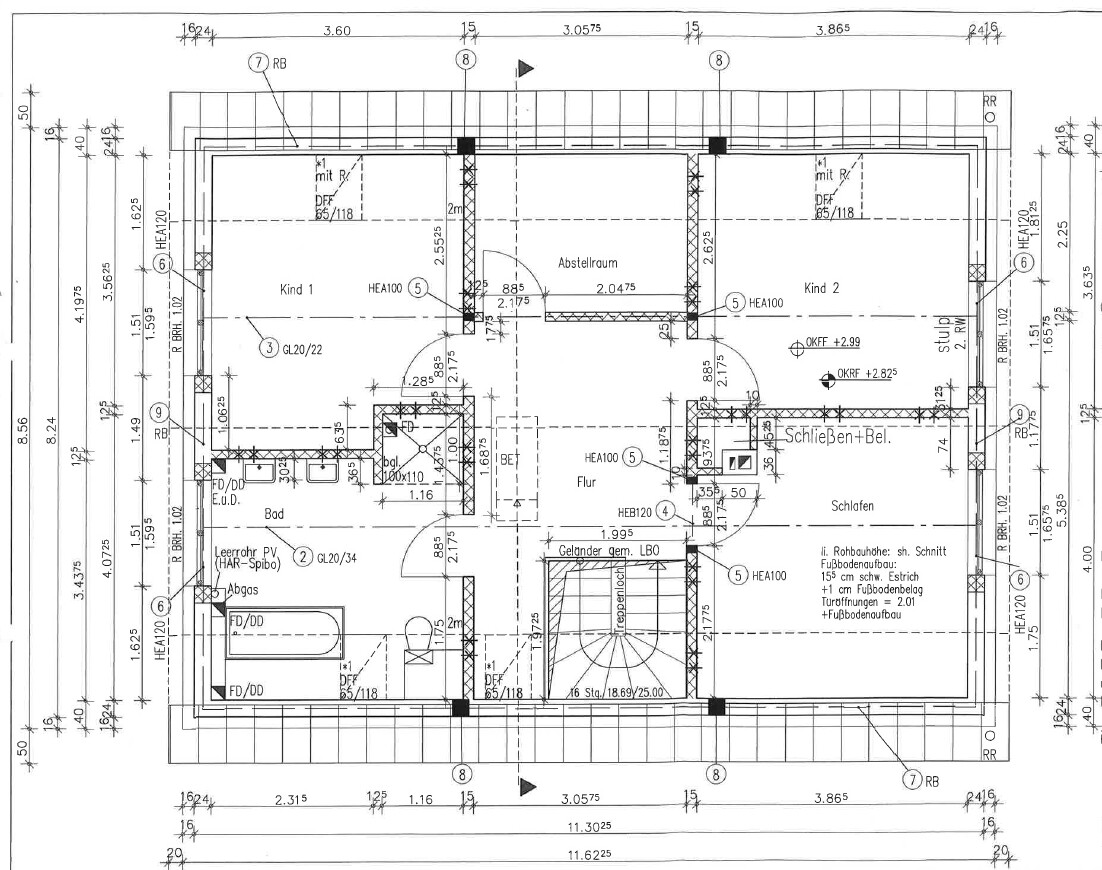

Dear forum members,
Our house seller recommended installing a conduit from the main distribution panel to the attic, to later pull a cable for a photovoltaic system through it. This conduit runs on the upper floor right next to the bathroom window, alongside other pipes such as the heating exhaust, which results in a fairly large drywall chase. I’m just wondering whether it looks good if the drywall chase extends up to (almost) the window opening, or if it would be better to omit the conduit. That would give about 20cm (8 inches) more space to the exhaust pipe.
Attached is the building plan for reference.
Thank you in advance.

chrisw81
15 Apr 2019 10:07
There is no opening planned in the ground floor ceiling; if necessary, it would probably have to be made using core drilling, or maybe the conduit will actually be routed through the wall. So I can still actively decide for or against it. Now that the pipe is located in a rather inconvenient spot, I am leaning toward leaving it out – the chance of installing photovoltaics later on seems quite low. If the empty conduit had been placed somewhere discreet, the situation would look completely different.
chrisw81
7 Jun 2019 09:48
Lumpi_LE schrieb:
The wall won’t work anyway; where would the water supply and wastewater pipes for the sink go with only 12.5cm (5 inches)? You’ll have to change that anyway, and then you can integrate the shaft into the wall.
For photovoltaic systems, you need a conduit with a diameter of 32mm or at most 40mm (1.25 or 1.5 inches) that can easily be installed inside any wall—no need for a corner or shaft.
The plumber told me that water supply and wastewater pipes can also be routed inside the drywall partition. For the drain, it probably won’t be a 90mm or 100mm (3.5 or 4 inches) pipe, since a smaller one is sufficient. Two 40mm (1.5 inch) pipes should easily fit within a drywall system with 75mm (3 inch) studs.
