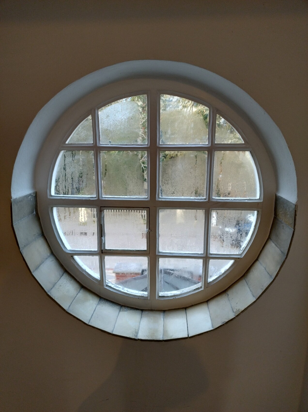

We recently purchased a house that is ready for demolition, on whose foundation we will build anew. Before tearing it down, I would like to carefully remove an old, round window, as I find it very beautiful and would like to reuse it in a suitable location.
Although I consider myself fairly handy, I have little experience with masonry and window work. Could I ask for your advice on the best way to proceed? So far, my idea was to use a rotary hammer drill from the inside to expose any fastenings and then remove the window inward. Is this feasible, or is there a high risk of damage?

thank you for the constructive responses regarding the window removal. I was also advised to test the putty for asbestos, which I will definitely do before removing it.
We will no longer use it as an exterior window but, as suggested above, rather as a room divider or in the garden shed.

wiltshire9 Jan 2025 13:25Apfelbaum schrieb:
I was advised to test the glazing putty for asbestos, which I will definitely do before removal. If you find asbestos in your house, you are required to dispose of it properly. This can be quite costly. Knowingly disposing of asbestos improperly can be very expensive.
Asbestos was used in window putty until the late 1980s. The fibers are bound within the putty and therefore not hazardous. Of course, such putty hardens over the years – but as long as you don’t sand or grind it, there is no health risk from handling it.
Remove it as you planned. I would definitely not measure it again.
