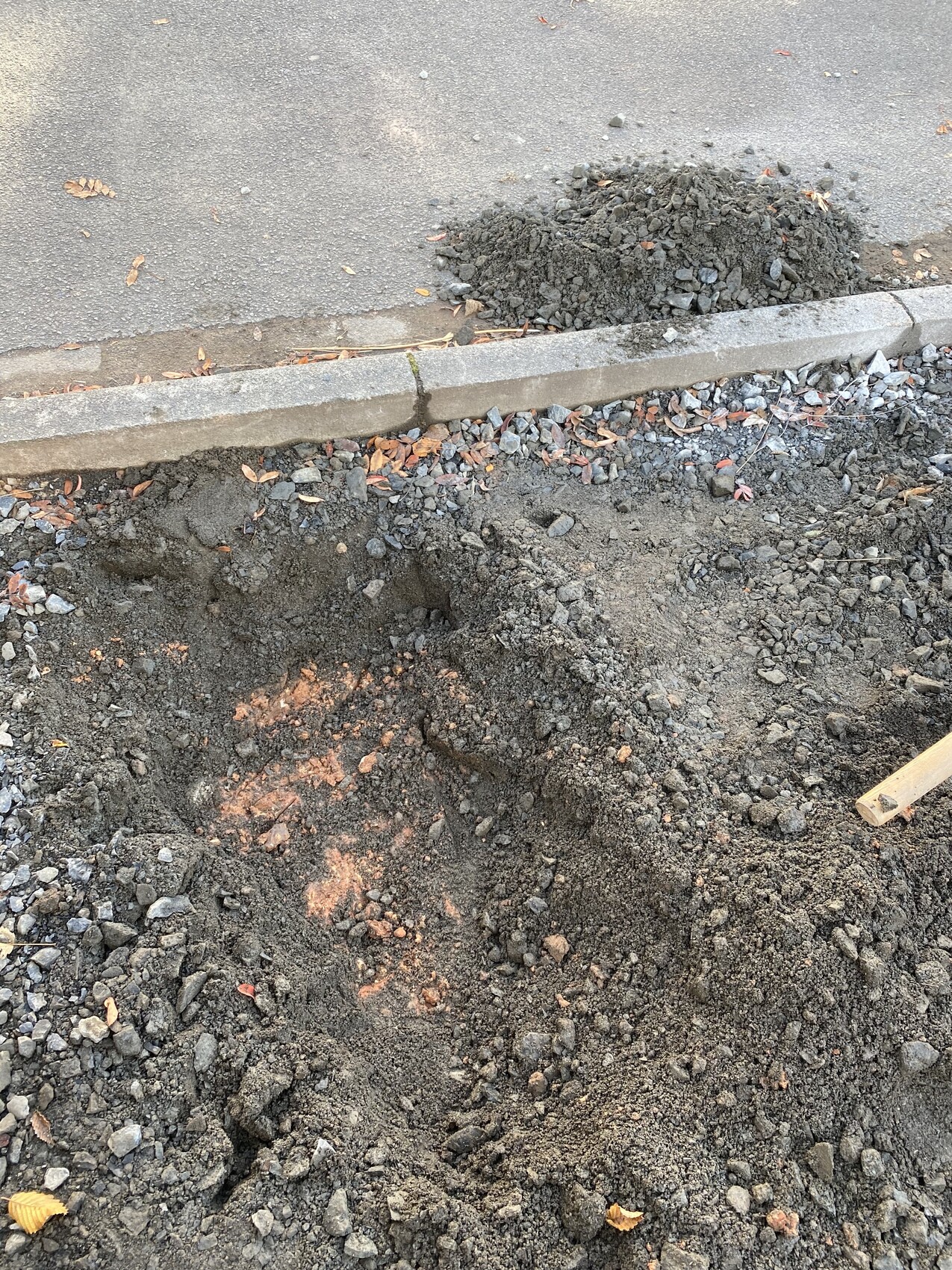

Patrick9327 Oct 2022 13:32Hello,
I need your advice.
We want to renew our driveway and have found that beneath the paving there is fine basalt sand instead of gravel as a base layer.
We planned to replace it with gravel.
Our excavator operator said he would leave it in place, as it would be wasteful to remove it.
We listened to him, but now our glazier thinks that material might not be stable enough and there is a risk it could settle.
Does anyone have experience with this?

DaGoodness27 Oct 2022 13:42The question is, who will be responsible for the warranty of the completed paving work later on? The excavator operator or the landscape gardener?
DaGoodness27 Oct 2022 13:50When the landscape contractor carries out the paving work, they are also responsible for ensuring a proper base, as they must guarantee the quality of their work. So, in this situation, I would tend to trust the landscape contractor more than the excavator operator. It would also be questionable whether the landscape contractor would proceed with the work if they already have concerns.

I would replace the substrate; the planned use and expected loads on the surface, combined with the results of the soil survey, determine the required depth.
There is nothing more frustrating than having to redo everything four years later.

DaGoodness27 Oct 2022 14:07I just wanted to make it clear that I would trust the landscaper more than the excavator.
And if the landscaper says the soil is not load-bearing, then make the soil load-bearing according to the landscaper’s specifications 😉
