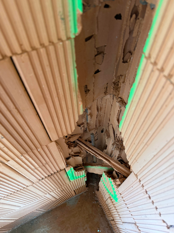

Our shell builder (semi-detached house, ceiling height 2.50 m (8 ft 2 in)) has installed the tension supports required by the structural engineer between the ground floor ceiling and the upper floor ceiling in the corner of the exterior walls as shown in the picture. Is this a proper professional solution? I am concerned about insulation (thermal bridge) and structural integrity (cracks). Apparently, the whole area is supposed to be sealed with insulating mortar.
I would appreciate detailed feedback. Thank you in advance!

hanghaus202330 Mar 2026 14:45I have not seen anything like this before. It is likely that a thermal bridge is forming here.
