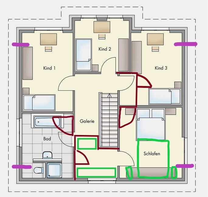

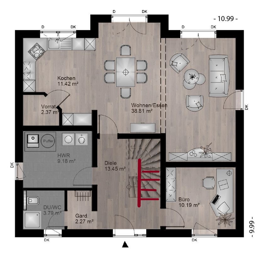

we are planning to build and before consulting an architect, we would like to get your objective opinions on the floor plans we have posted. We really like this layout for the ground floor and upper floor and would like the architect to design something similar.
Please excuse the very simplified sketches; I’m not comfortable using these floor plan software programs, but I hope it’s understandable enough.
Notes on ground floor: Please disregard the pantry; the staircase should start straight and turn left at the top or simply be completely straight.
Notes on upper floor: We would like a walk-in closet attached to the bedroom with a connection to the bathroom. I have roughly marked this as we would like it, with the furniture in green. The T-shaped fixture in the bathroom should be rotated.
The main focus is on the room layout itself and whether there is enough storage space. Of course, the architect will need to adjust things, for example to align the stairs between ground and upper floor. The house should be about 170 square meters (1,830 square feet) and have a gable roof with a dormer. I have roughly indicated the approximate 2-meter (6.5 feet) height line in purple in a very basic way.

Ground floor: office, utility room, guest toilet, kitchen/dining/living room
Upper floor: 3 children’s rooms, bedroom, walk-in closet, large bathroom

Do you think 7 sqm (75 sq ft) is enough for a utility room? For a combined utility/storage room, 7 sqm (75 sq ft) is rather tight if there is no basement (what does the plot say about that?).

Regarding the garage: a prefabricated garage for one car will be placed next to the house. However, access will still be through the front door.

There will be a prefabricated garage next to the house for one car. However, access will still be through the front door. Then you should at least mark the garage with a thick red line indicating where it could interfere with windows.
Does a single garage satisfy parking space requirements? There are also municipalities with parking regulations, and regarding this, "no zoning plan / no building permit restrictions" is not a guaranteed exception.
Herr_Nord-DE_ schrieb:
Please leave the staircase situation aside for now, I wish that were possible. A staircase is precisely THE element that influences the floors.
Shortening it just isn’t an option. That would make it too steep. The required length has to go somewhere. That’s exactly why it is designed the way it is in that particular plan.

where we would like it to be at the marked position. You missed what @11ant wrote: a knee wall of 1.40m (4 ft 7 in) won’t allow for a cupboard there, and by the way, not even a shower or toilet. And I’m not saying this to annoy you.
You’d probably have to make the house a bit bigger.
Where do the 1.40m (4 ft 7 in) come from, anyway?

And do you think 7 sqm (75 sq ft) are enough for a utility room? No, definitely not. At least not for 5 people plus 2 dogs.
We have about 8.5 sqm (90 sq ft) for technical and storage space (pantry, recycling bags, drinks, cleaning supplies, etc.) plus 4 sqm (43 sq ft) in the attic for the utility room (washing machine + dryer). What kind of dogs are they? Dog crates, feeding bowls, accessories… how do you do laundry now? Ironing, storage of laundry to be ironed, dirty laundry, where do you iron?
If you’re going to involve an architect anyway, just give them the room program. They will create something that (hopefully) works from that. Then you can discuss the layout to see if the architect did a good job or if there are things that could be improved.
Otherwise, I would recommend reconsidering the two doors in the probably already tight bathroom for three children. You lose storage and maneuvering space because of that. You have to make compromises somewhere, although I would actually see two doors more as a benefit than a drawback. 😉
Herr_Nord-DE_4 Aug 2023 14:44The 1.40 m (4 ft 7 in) knee wall looked good to us visually. We like sloped ceilings and once visited friends who have a house with a knee wall like that. Of course, it’s inconvenient for the wardrobe in the dressing room, since then a wardrobe can only be placed on the opposite side, which is really not enough...
The shower and toilet layout won’t work as is, yes. That’s why I suggested rotating the T-shape. Then it would work. We don’t want the bathroom to be smaller than 13 sqm (140 sq ft). I think that size should be suitable for a family bathroom? So would you prefer not to have two doors, and instead only access the bathroom from the hallway?

I already thought that 7 sqm (75 sq ft) would be tight. Strange that such sizes are so often seen in floor plans...?! Without a basement, you don’t really know where to put all the stuff anyway. Sure, there’s an attic, but that’s not really an option for cleaning supplies, dog gear, etc. By the way, there are two Labradors.

I already figured that 7sqm (75 sq ft) would be tight. [...] By the way, there are two Labradors. If you’re coming in with them from a muddy dirt road, a utility room of that size is practically needed just for the shower, drain, and boot storage. Then the washer and dryer will have to be stacked, and all the utility connections have to go somewhere else.
