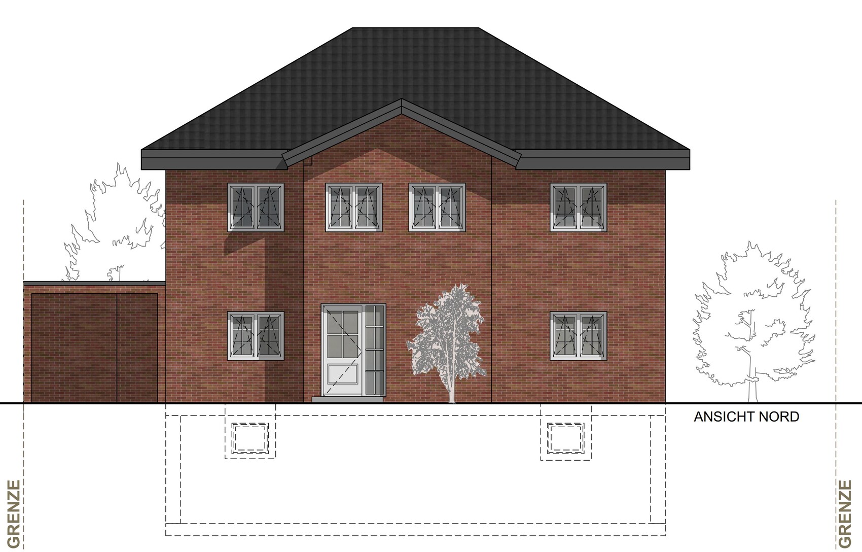

A more rectangular shape, as well as bay windows and a steeper roof were suggested, which means we are quite satisfied with the exterior appearance as it stands today.
You can say a lot, but we don’t know what you are referring to.
I’m not sure what you want now…
If you’re asking whether you are planning the right house for your plot, you would still need to take action here

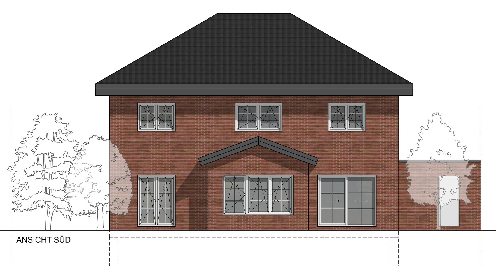

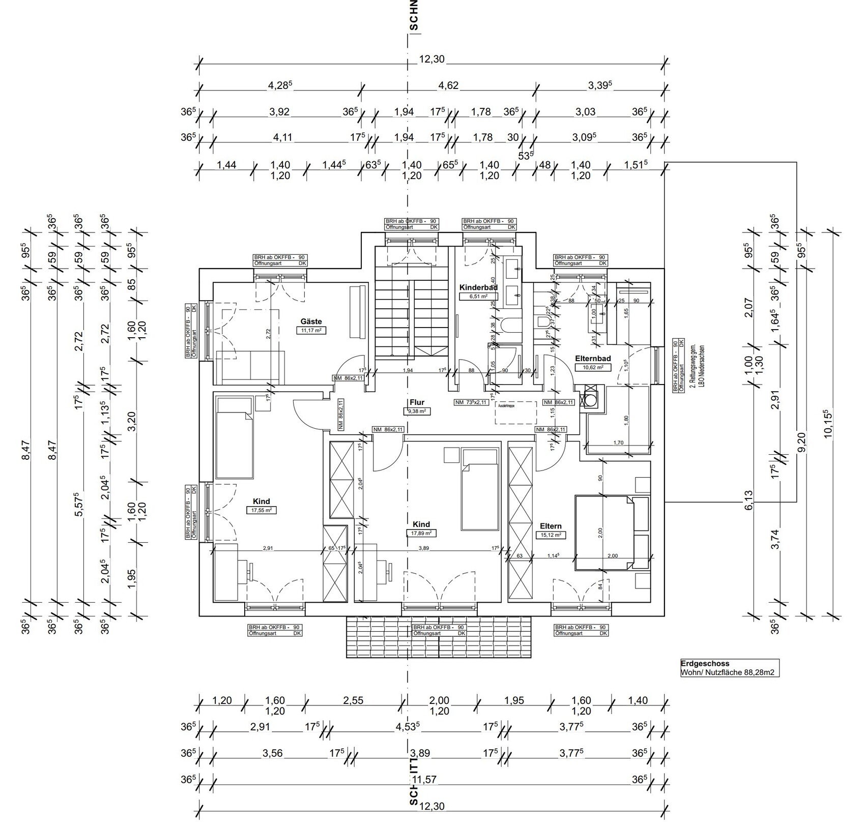

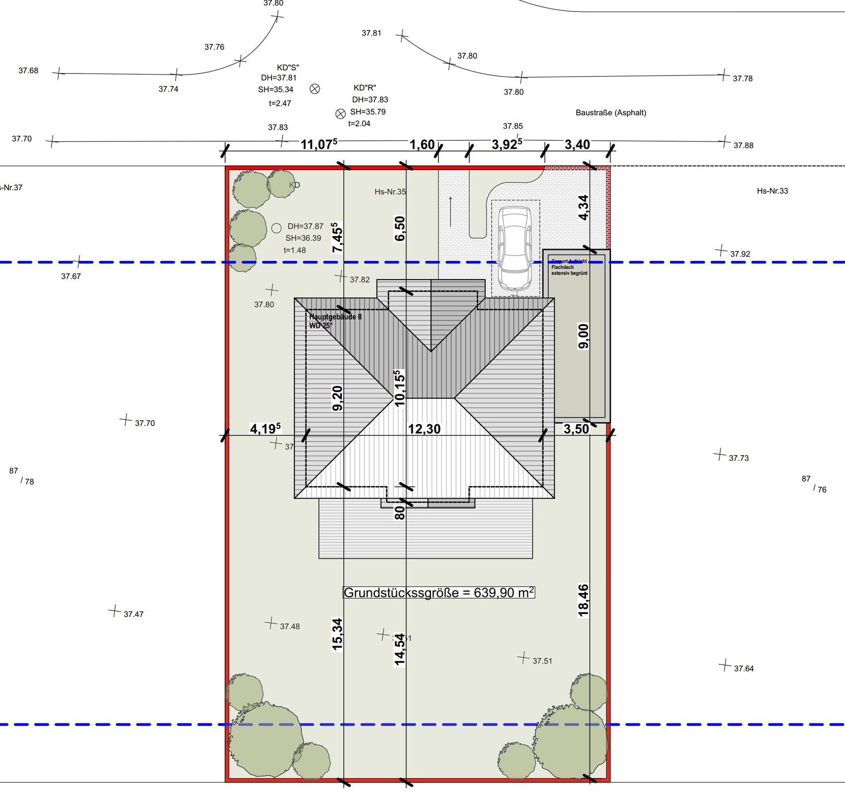

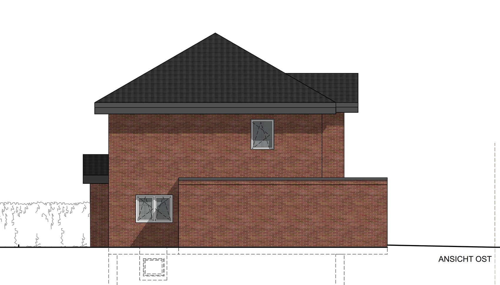

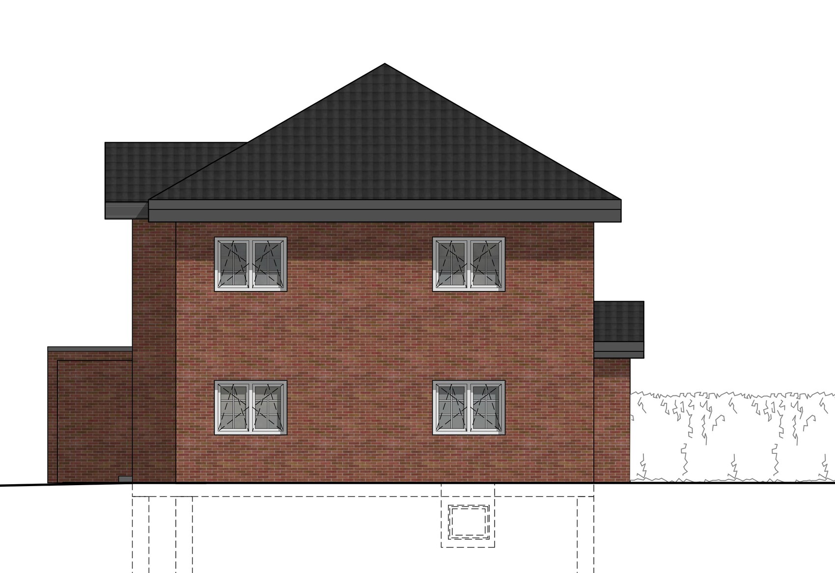

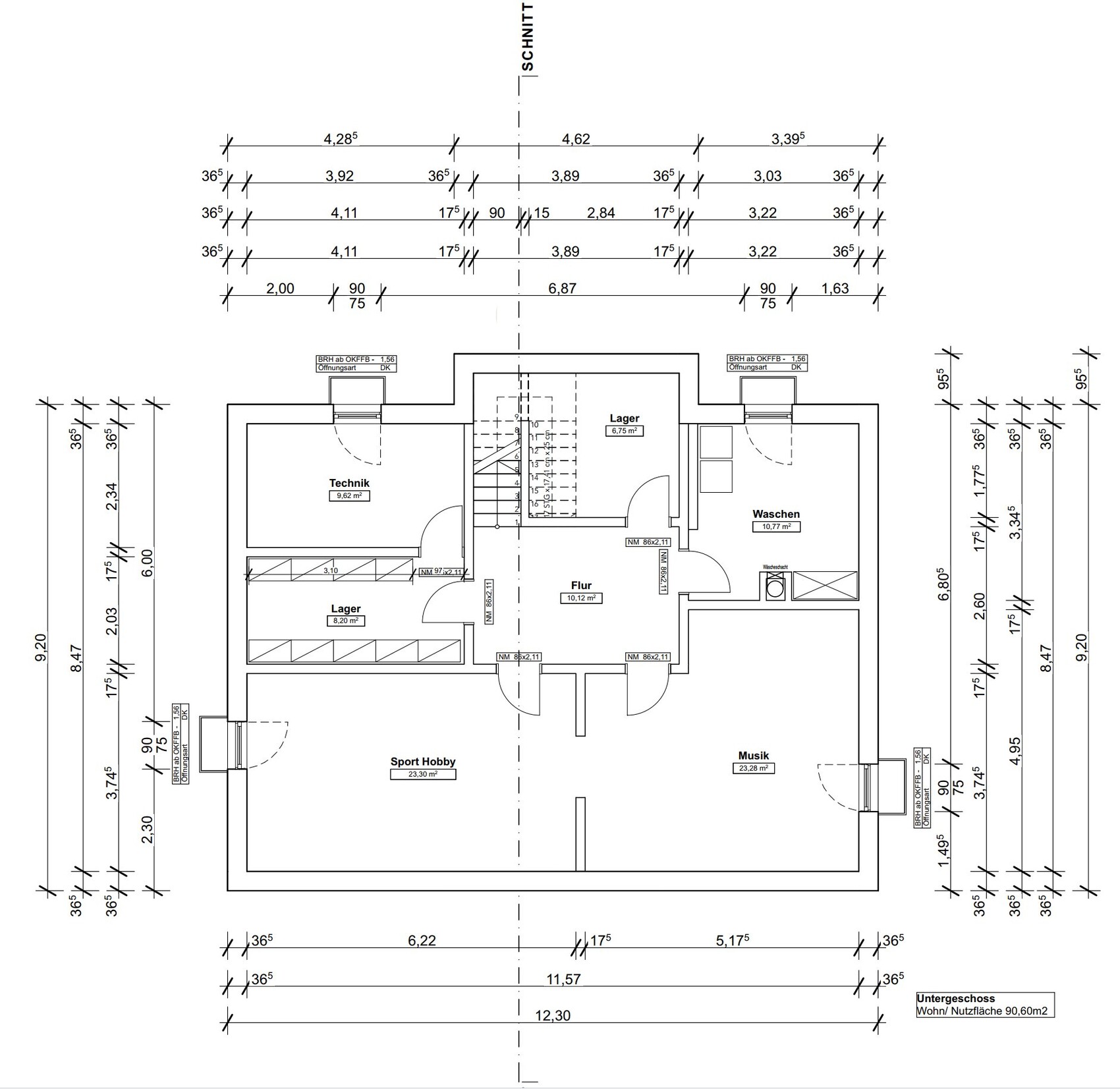

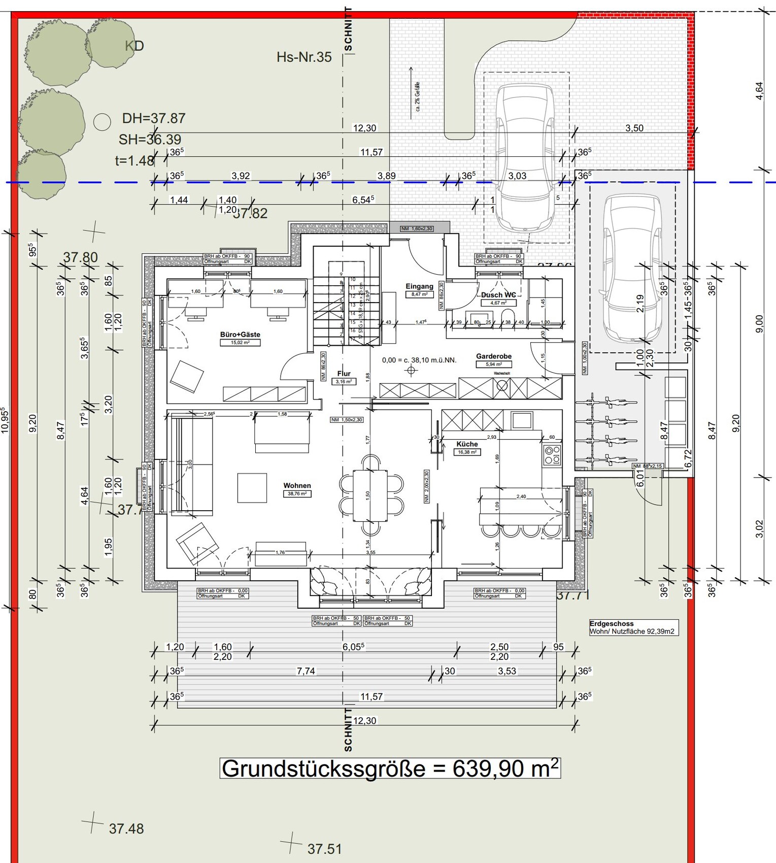

This is the current planning status with a basement. If the basement were omitted, the music/hobby and fitness area could probably be accommodated in the guest room on the upper floor. However, significant redesigns would likely be necessary just to include the utility and laundry rooms. Well, for the washing machine, I could sacrifice the sauna in the bathroom. Utility room under the roof?
What do you think of the layout otherwise?

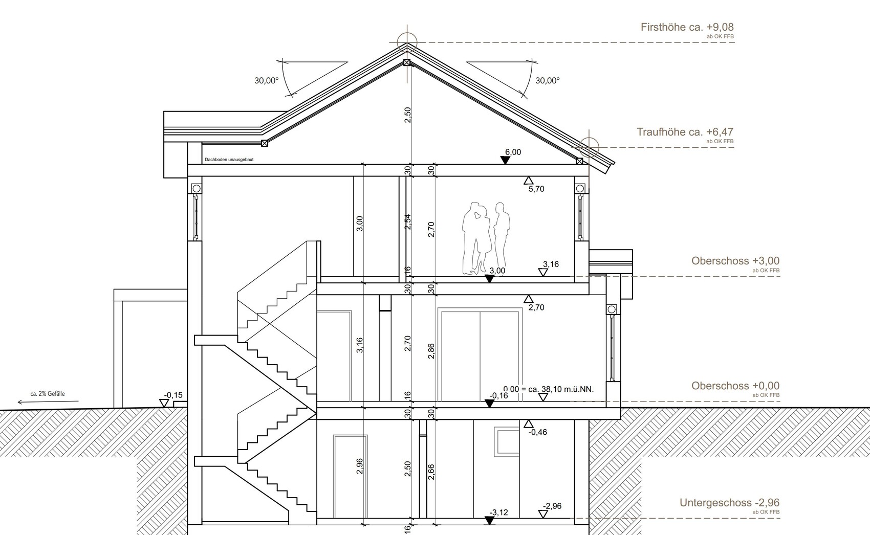

Architekten-Schnitt eines mehrstöckigen Hauses mit Treppenhaus, Dachkonstruktion und Maßen.
15 Feb 2025 23:46
Ben3001 schrieb:
What do you think of the floor plan otherwise?
I can tell you how the exterior looks: completely crooked. I wouldn’t want it like that.
Ben3001
15 Feb 2025 23:53
Yes, that was also one of our main criticisms of the design. We suggested at least centering the windows on the left side. However, this would have required changes to the bathroom installations upstairs, likely leading to a complicated routing of the wastewater pipes along the exterior wall, so this idea was discarded. In the end, we comforted ourselves with the thought that people rarely look directly at the house from the front, and the tilt is less noticeable from an angle. On the south side, the asymmetry is much less obvious.
16 Feb 2025 01:32
Ben3001 schrieb:
Yes, that was also one of our main criticisms of the design. We had suggested at least centering the windows on the left side. However, this would have required changes to the bathroom installations above, likely resulting in a complicated layout of the sewage pipes along the exterior wall, so that idea was eventually discarded. In the end, we consoled ourselves with the thought that people rarely look directly at the front of the house, and the asymmetry is less noticeable from an angle. On the south side, the asymmetry is much less apparent.
Sorry, but I have no understanding for such thoughts and arguments. In my view, the design is flawed and therefore should not be built.
