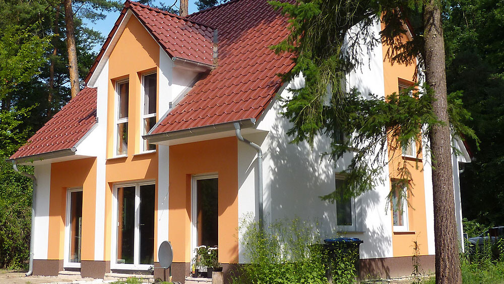

When I search online, I do find offers from solid construction companies that at least suggest this:
Example of a 132sqm house
Okay, this example does not exactly meet the KfW 55 standard, but it’s miles (about €50,000) below the offer of the prefabricated house manufacturers. And I haven’t compared quality or fittings (turnkey?) in detail. But it does make me think...
First of all, this is a provider who states they operate in Berlin, Brandenburg, Saxony-Anhalt, and Saxony. Prices there are (still) lower than here; you want to build in NRW? Where exactly?
Then it makes little sense to evaluate an offer if the specifications are unknown. But looking at what is supposed to be included in the offer price:
  • Custom planning based on client’s wishes
  • Built according to Energy Saving Ordinance 2016
  • Free floor plan modifications
  • 132 sqm (1420 sq ft) of living and usable space
  • External dimensions: 9.38 x 8.88 m (30.8 x 29.1 ft)
  • Gable roof with 45° pitch
  • Gable dormer
  • Clay roof tiles with thin glaze in various colors
  • Knee wall (Drempel) 1.00 m (3.3 ft)
  • Architect services and building permit application
  • Groundworks, slab foundation & frost protection edge
  • Exterior masonry 36.5 cm (14.4 inches) thermal brick, monolithic construction without external insulation system
  • Interior walls on ground floor masonry, upper floor drywall frame construction
  • Heat pump + underfloor heating
  • Energy-efficient windows, color: white
  • Front door with WK2 security locking system, color: white
  • Roller shutters on ground and upper floors
  • Natural stone window sills: granite outside, marble inside
  • Solid wood staircase, beech or similar, treated finish
  • Tiles: bathroom & WC
  • Walk-in shower & ergonomically shaped bathtub
  • Frost-proof outdoor water tap
  • Colored exterior plaster, painted
  • Continuous base plaster
*Promotional price [B]€158,990[/B]
(turnkey, excluding painting and floor covering work)
Prices include 19% VAT! House image shows special features!
Then I naturally wonder why not every builder builds *only* with this provider?
Again – you will not be able to build a single-family house in NRW as you wish with your budget; perhaps with some luck in the Münsterland region, but not a KfW 55 energy efficiency house. The only alternative is to consider self-build shell packages. But then you still have to buy materials yourself and possibly require professional support. It goes without saying that you should be skilled in almost all trades.
PS: Since I had to remove the link, the image for the offer is attached below.
*Source and image: EWA Hausbau
Regards, Bauexperte
Bright two-story house with orange facades and a red tiled roof, surrounded by trees.

So you really believe that you alone can compare apples to apples. Well, I’ll quote my old mentor: there are 17 different trades involved in construction. And we’re only talking about a 1000-Mark note. As a layperson, you want to oversee all 17 trades?
Let’s take building expert’s list: energy-efficient windows. What exactly does that mean? Many already fail the Uw value because they compare it with the Ug value. And I haven’t even started on the frame yet, whether it’s version A or B. Or interior doors. Yes, they’re supposed to be white. There are solid wood doors, hollow core, panel doors, and so on. They’re all white and look similar. Price difference for a “normal” room door: 300 Marks per door!
Electrical fittings: high quality, the absolute highlight.
Sanitary fittings: branded products.
Excavation work: probably not fully included unless he’s crazy, and definitely with reservations.
