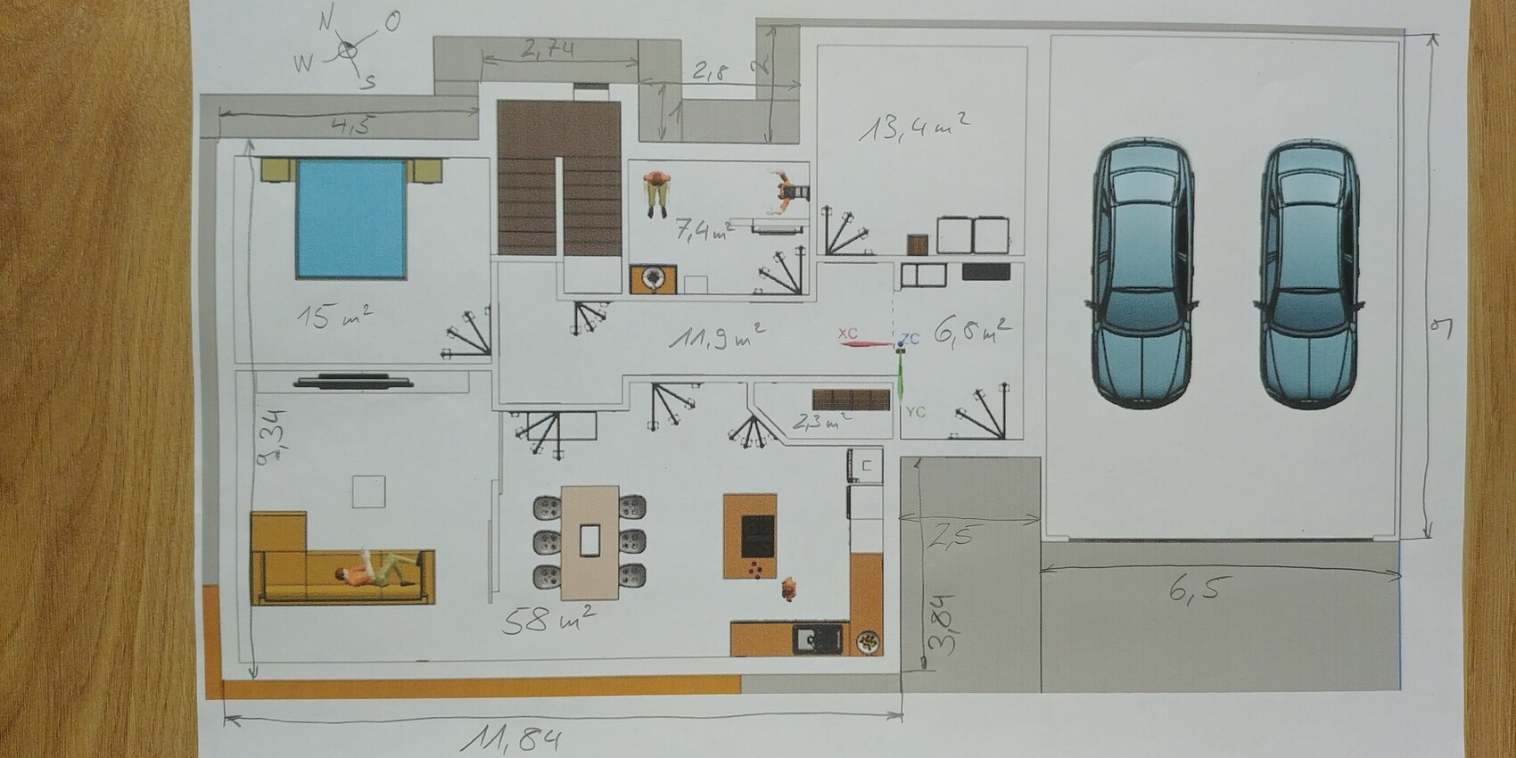

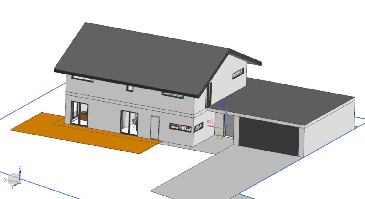

FloDerMeister5 May 2019 12:42Hello,
we are planning to build a prefabricated house and would like to receive feedback and suggestions on our current ideas.

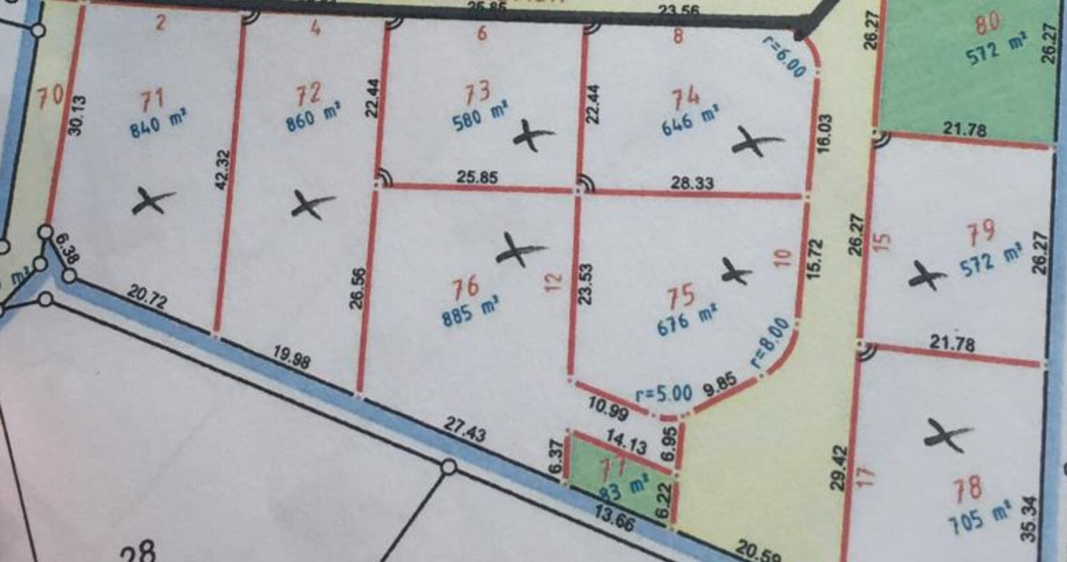

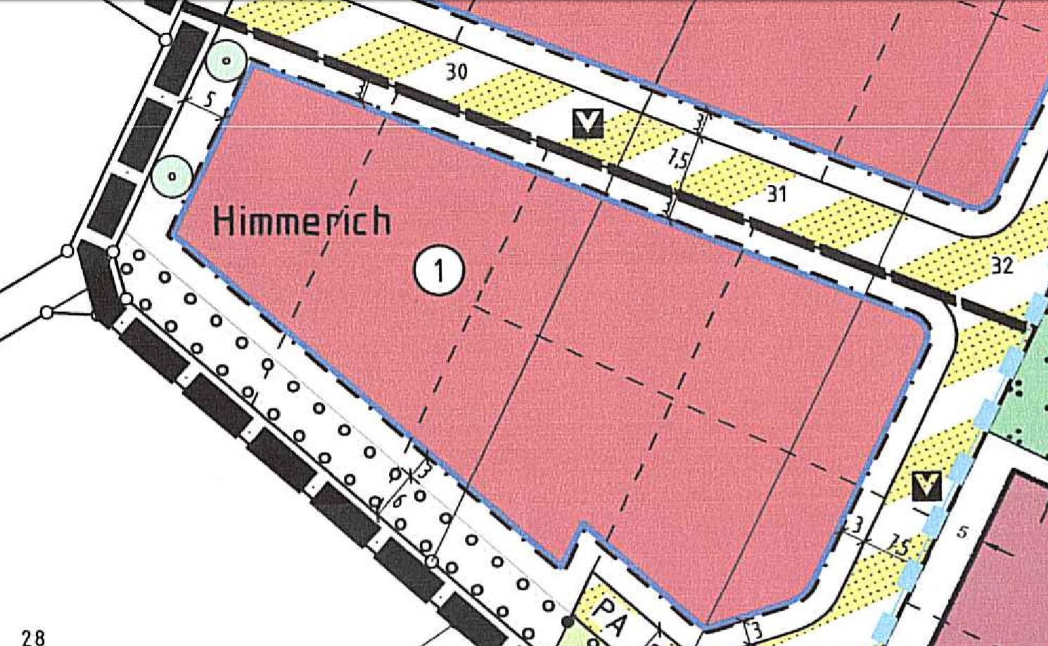

The pictures show the available building plots (we can choose one since we are number one on the waiting list).
Zoning Plan / Restrictions
Plot size
885m² (9519 sq ft)

Site occupancy index
0.4
Floor area ratio
0.6
see picture
Edge development
see picture

Other wishes / special requirements / daily routine, also reasons for preferences
The living area should be somewhat separated from the kitchen; I am especially interested in suggestions on how to design this.

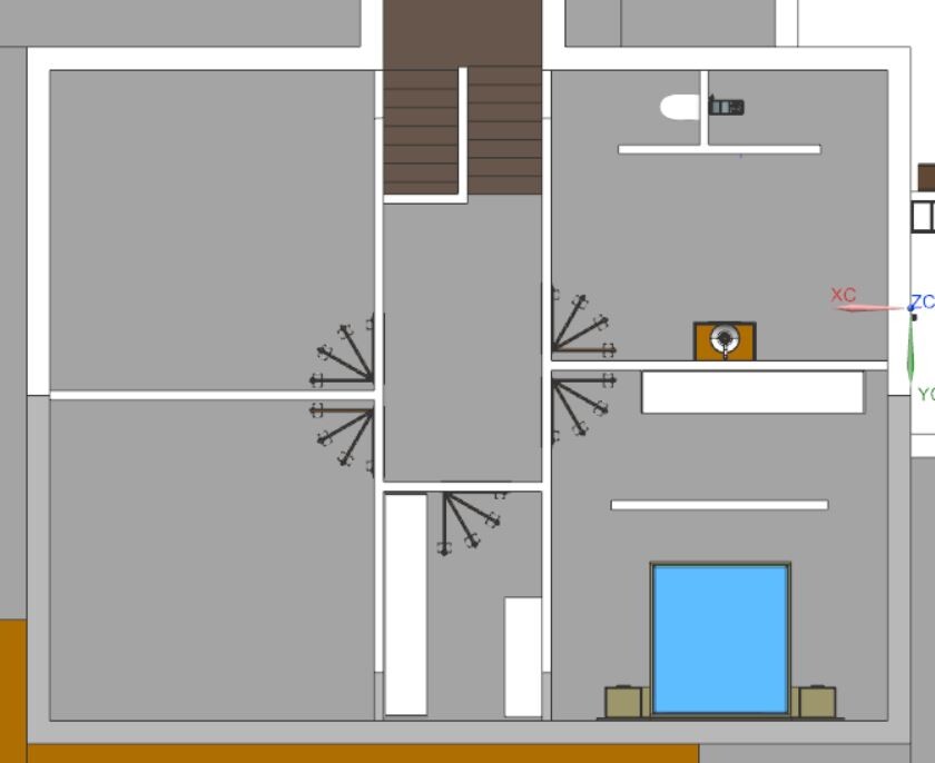

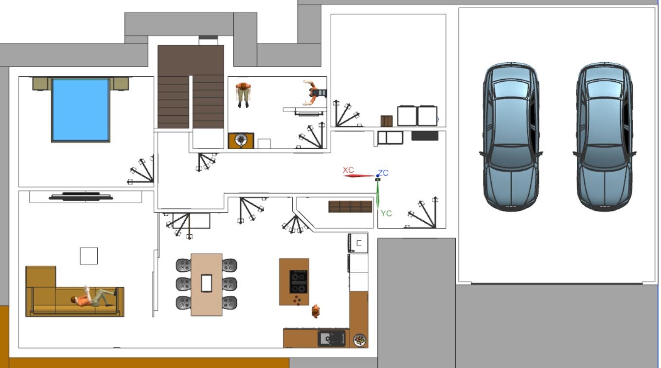

For about a year, I have repeatedly made changes to the design, looked at various floor plans, visited model home exhibitions, and researched on the internet
I hope that by already furnishing the rooms, I have considered many aspects, especially distances, walking paths, etc.
In your opinion, can the floor plan still be optimized to avoid wasting space unnecessarily? Are the rooms large enough (technical room)?
If I have forgotten to provide any information, I will try to submit it as soon as possible.

FloDerMeister5 May 2019 15:25Hello
The plot is quite challenging for a successful design.
The utility room is sufficiently large.
The hallway has too many recesses and projections for my taste, and the pantry is not very practical. I would rather install tall cabinets and eliminate the pantry.
Why are the two doors to the living and dining areas placed right next to each other?
Olli
Olli
F
FloDerMeister5 May 2019 17:53@ haydee What budget do you think I should plan for the floor plan?
@ wrobel I have removed the left door, you're right, it is unnecessary
