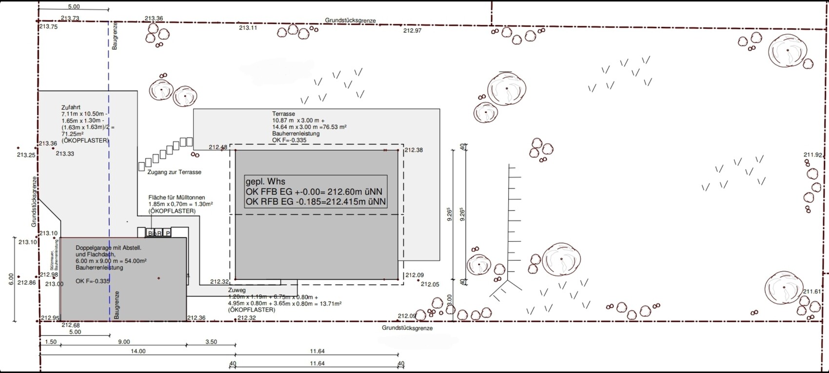

Then show them and be surprised. Is the track record for steel garages really that discouraging, or are you deliberately exaggerating it a bit?
Attached is the plan. Best regards!

Attached is the plan. Best regards!Maybe you could also draw the planned interior layout and the garage door position to scale. I’m a bit doubtful about how you’ll manage to get the second car onto the paved area along with the trash bins and be able to comfortably get in and out. It seems quite tight to me. The access to the street is on the middle left side, right?
