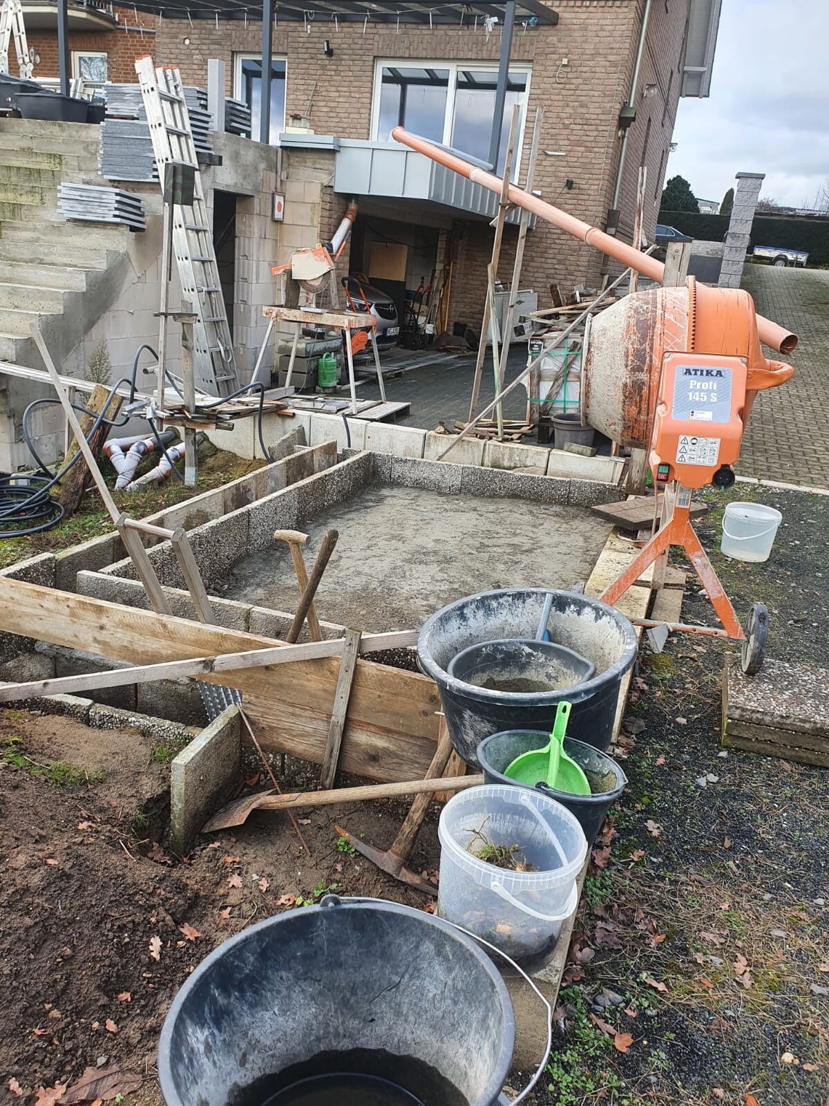

to give a clearer picture of the project, here is a photo showing the preparation of the foundation slab
Construction site in front of a residential building: concrete mixer, boards, buckets, wheelbarrows, and construction work.

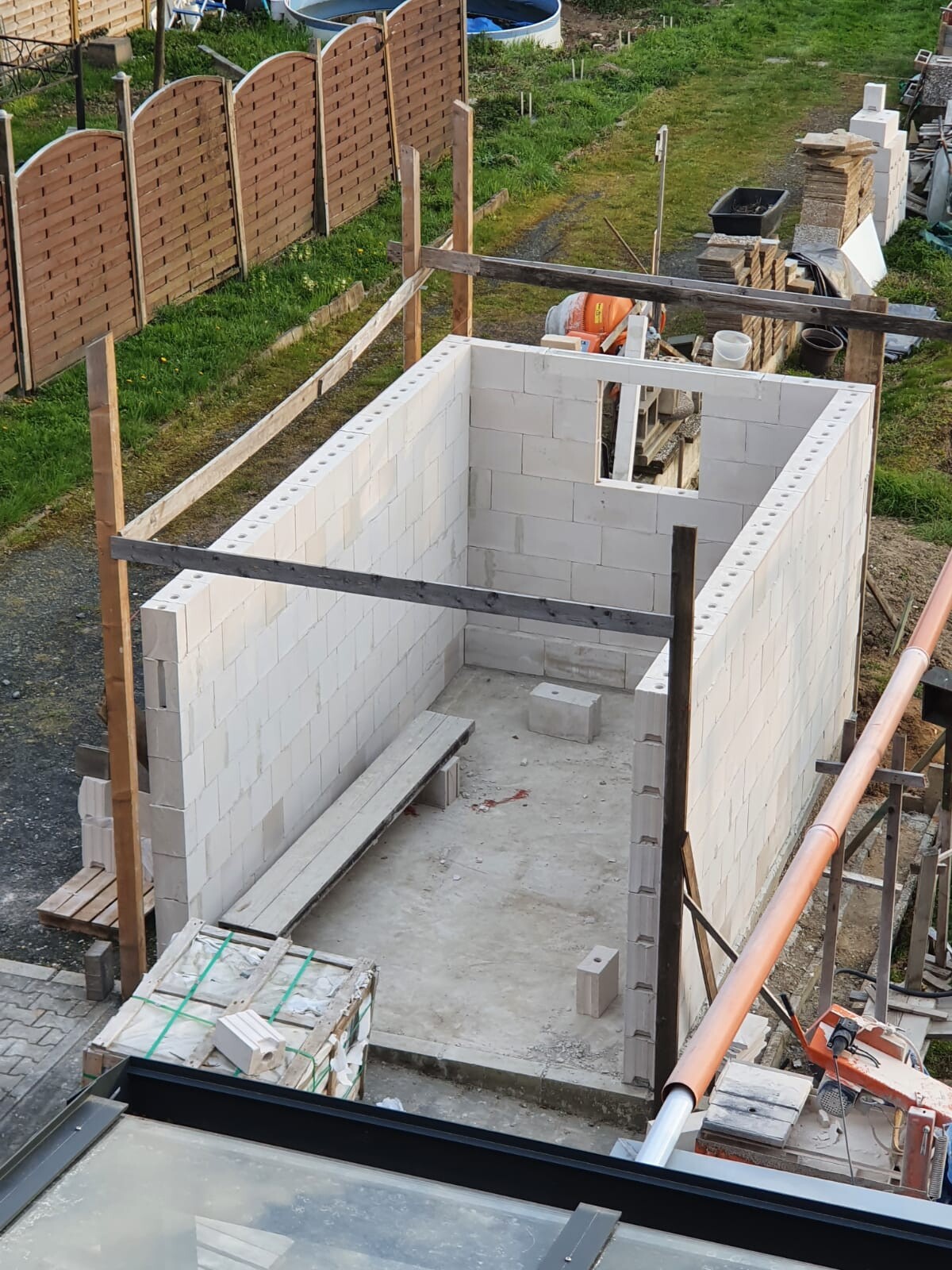

and here the masonry garage without a ring beam and without a ceiling
Rohbau eines kleinen Gebäudes aus weißen Blöcken, Fensteröffnung, Holzgerüst und Bauutensilien.

I have the exact opposite opinion. My motto is: More is better.
But you have to admit that the machine(s) could easily stand on paving slabs. Like on any normal sidewalk or paved path.
@TE: Parking spaces at Aldi or in front of your house can support a car and/or truck. And those are "just" paved. 😉
Hello nordanney
I admit that.
I’m just a bit extreme.
And since I’m doing everything myself, it only costs the additional materials.

But then you forgot the bitumen felt underneath and after the first layer of bricks?
As a saver, I would have made it a little longer and wider to increase the value. Then it would count as a garage. 😉

hanghaus2000 schrieb:
Did you forget the bituminous membrane at the bottom and after the first course of blocks?
Hello hanghaus,
I installed a horizontal damp-proof course. You can’t see it in the picture.
