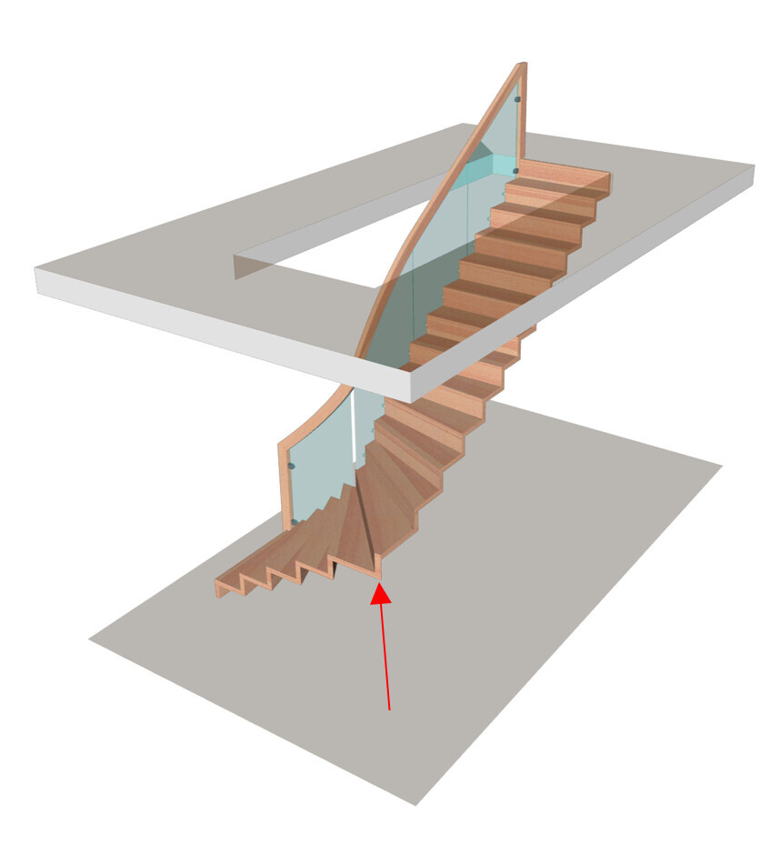

Mal Bauen17 Sep 2023 22:00For our planned stairway between floors, we are currently looking for a compromise between walkability and space requirements.
Due to limitations in the x and y directions, the step edge ends up exactly on the symmetry axis of the 90° turn (with a shift of 4 steps before and after).
As a result, the winder step, which on many stairs is exactly symmetrical in the turn—meaning it is framed by both wall stringers—“disappears.” Compared to our design, the steps are effectively shifted by half a tread width.
Can anyone explain the rationale behind this approach for the winder step? Is it purely aesthetic? Or are stairs with a symmetrical winder step (perceived or actual) easier to walk on? I can’t see why that would be the case.

Mal Bauen19 Sep 2023 23:01Thank you. The only practical "benefit" of a symmetrical winder step that comes to mind would be more surface area in the corner for flower vases or similar items.
So this winder step requirement moves down the priority list in the staircase specifications for now...
