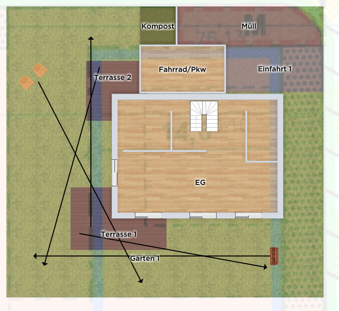

Dear Forum,
after allowing a bit more “rest time” for our plans, we are now considering the optimal positioning of our house on the plot, especially taking into account the orientation of the neighboring properties.
We have plot number 9 (parcel 929).
Parcel 949 is a waste container area (quite oversized at 30m² (320 ft²)) serving plots 3, 4, 5, and 6. This is a dead-end street (planned street B), which is why the waste container area is located next to us.
Plot number 6 will be a 9.30 m (30.5 ft) high gable-roofed semi-detached house with the ridge running west-east. This means three floor-to-ceiling windows will face directly onto our property. In front of this house is a garage situated 2 meters (6.5 ft) away from our plot (officially supposed to be 3 meters (9.8 ft), but apparently only 2 meters was approved). So the house wall starts at about ~5.50 meters (18 ft).
Plot number 10 to the south will be a bungalow with a garage directly adjoining our plot (fairly central, as there is a five-meter (16 ft) long driveway leading up to it).
We are wondering how best to position our house to avoid a feeling of excessive tightness.
Should it be as narrow as possible to maximize the west-facing garden and distance from the neighboring house to the west? Or rather positioned to have a south-facing garden, even if that means looking towards the neighbor’s garage wall?

Mangolicious schrieb:
and with the garbage bin storage area located even further north, you’d lose a lot of garden space to the north and would only have narrow garden strips or green areas around the house, right?Mangolicious schrieb:
At least the remaining small patch looks nicer than an empty paved area.Isn’t there a contradiction in your thinking?Mangolicious schrieb:
I wonder if giving up a carport or a parking space in the front yard area (a certain percentage is allowed to be paved)I consider it the worst choice to give up essentials.Mangolicious schrieb:
just to have at least a small sense of garden.You should focus more on your property than on the garbage area.Mangolicious schrieb:
Or alternatively, orient the house towards the west-south garden.As you prefer.Here are your possible sight lines for a house oriented to the south.
