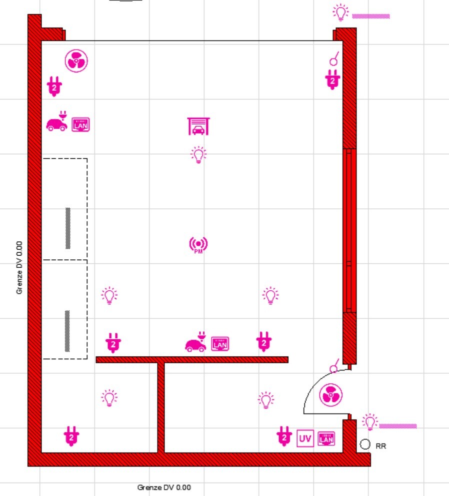

perhaps some of you already have practical experience with electric cars and charging stations. We are about to start the wiring for our new double garage. Attached is a sketch:
Floor plan of a newly built double garage: red exterior walls, car symbols, lights.
Next to the distribution board, there will also be a 16A or 32A outlet. Do you think the number of outlets might be too many? And the main question:
1. Where would you generally place wallboxes? Closer to the garage entrance or inside the garage?
2. For a double garage, would you rather go for two wallboxes?

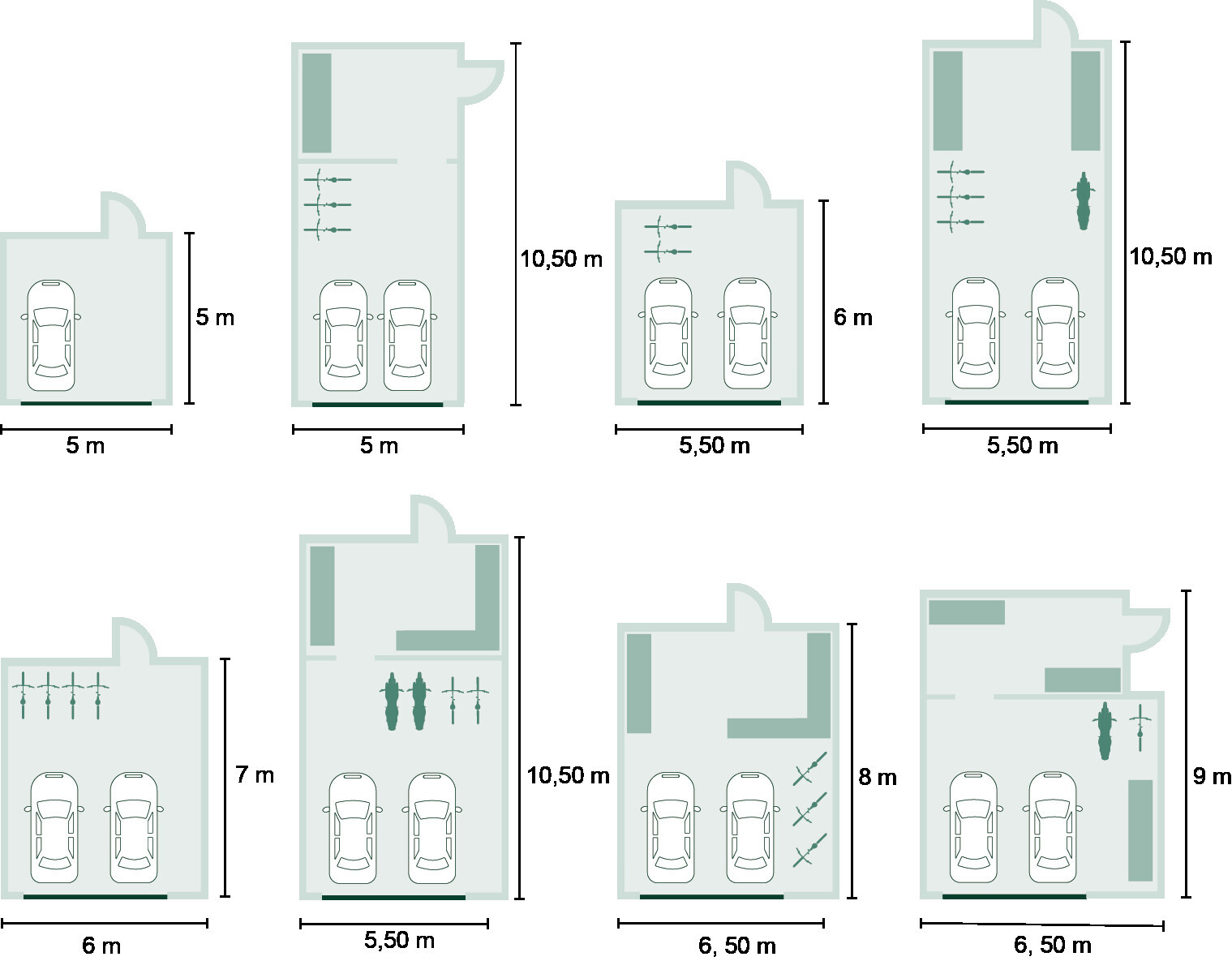

i_b_n_a_n schrieb:
If your bays are 1m wide, both cars won’t fit in the garage - right?
When planning, I based it on this overview
Several floor plans of parking garages with cars and dimensions.
I thought that if two cars fit in a width of 5m (external dimensions), then I would make my garage 6m wide and have some extra space. Now we have an internal width of about 5.5m (18 feet). It’s a bit tight, but two cars do fit inside.

Of course, this depends on the size of the cars when getting out 😉. What are the two separated areas supposed to be used for? Bicycles? With two parked cars, it’s really difficult to get them out back there.

I’m just repeating what my wife said. Maybe it’s too “stressful” to drive into a “tight” garage. I would install the wall boxes like this.
Floor plan of a room with red wall outline, pink lights, sockets, LAN, car, and door.
I can still consider today whether I need additional ventilation units for myself:
  • One fan for supply and exhaust ventilation (e.g. Zehnder ComfoSpot 50)
  • Two fans: one for supply air and another for exhaust air (e.g. Zehnder ComfoSpot Twin40)
  • The ComfoSpot 70 would probably be oversized (~200€ extra cost)

There is no way two cars can fit in there along with all the extra stuff around them.
