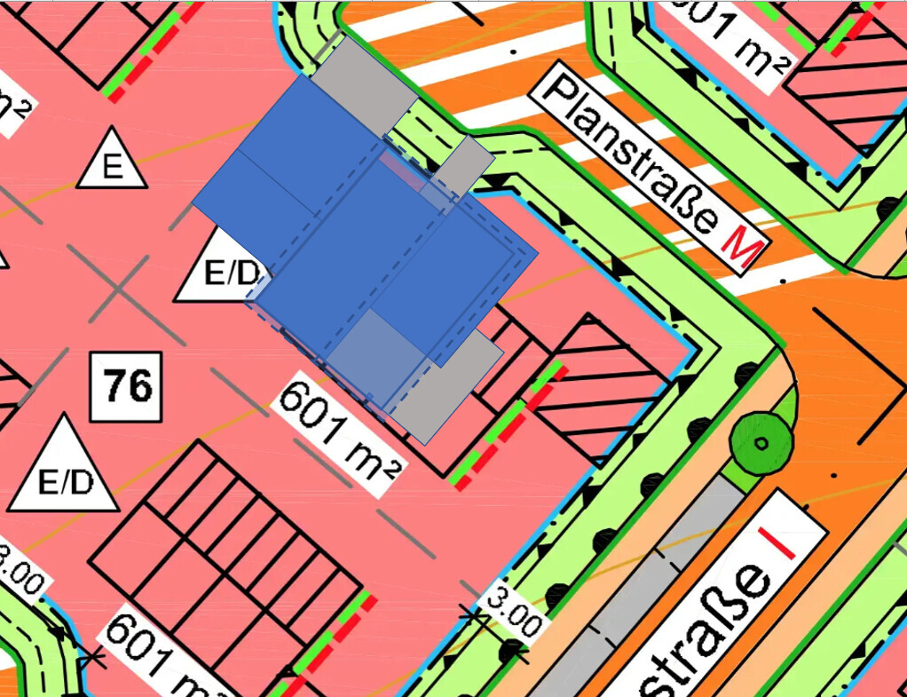

In our development plan, the location drawing roughly indicates the position of the house and garage. For better south/west orientation, we would prefer to place the garage on the right side of the house instead of on the left. Before commissioning a homebuilder, we would like to know if this is possible. The text section of the development plan does not specify any restrictions on this. Perhaps there are forum members with experience in such changes/deviations from the development plan (plot 78).

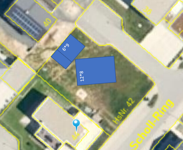

Alexander_ schrieb:
This is how we would like it. Unfortunately, I could only draw a hip roof in the program, but it is supposed to be a hipped roof. We can manage to rethink a hip roof into a hipped roof. However, for thorough design feedback — which you could definitely get here — the image resolution is unfortunately not sufficient. Please consider my warning about submitting such a self-designed plan to the processing phase of a construction company: there you will not receive any quality improvements to your design (unless it contains elements that would prevent approval). Additionally, you can find a section here with construction company reviews and recommendations for suitable builders in almost every region.
I like the overall size and simplicity of the building form. Your requirements profile also suggests that construction companies probably have similar designs as catalog houses ready to go, which I always recommend considering.

Alexander_ schrieb:
We would like to know before commissioning a house construction company whether this is possible. There are no specifications about this in the text part of the development plan. Of course, freely and free of charge… here it is:

Alexander_ schrieb:
Personal budget limit for the house, including fittings: open The price limit is interesting here. On the one hand, a double garage including a workshop is planned in considerable size. That also costs, and not a little. It should be possible on the border.
On the other hand, there is a slope. And the slope determines the house.
I won’t comment on the design. The orientation is understandable without knowledge of the slope… the utility room is much too small with two doors and one window. The house lacks storage space within the thermal envelope. With 7 sqm (75 sq ft), I also don’t see a buffer area from garage to house… or you have to crawl over the washing machine and laundry. Be that as it may… it is only a rough thought.
hanghaus202327 Jun 2023 13:56@ypg The development plan indicates a possible building orientation, but this is not mandatory. This can also be clearly seen on Google Maps. Some houses have even been rotated away from the specified ridge direction, and garages have been built in different locations as well.
