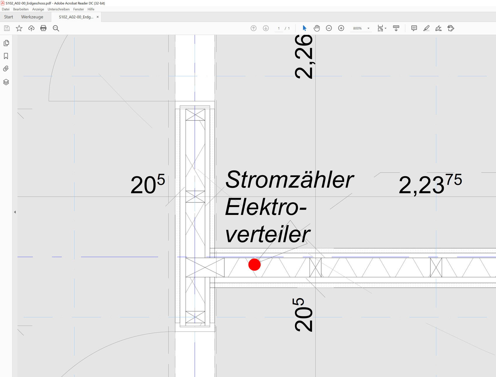

Hello, I have a question regarding the positioning of the electric meter and the single-service media entry for electricity. Currently, both are planned to be installed directly within the timber stud wall.
The wall assembly is not quite correct on the drawing yet. We have a stud frame, then OSB, battens as the installation cavity, and on the room side, gypsum fiberboard.
Is this the optimal position, or would it be better to place them within the installation cavity, or completely in front of the gypsum fiberboard?

Yes, placing it in front of the wall makes more sense to me. This way, we would also have the option to install horizontal noggings within the timber frame wall to mount the fuse box.
Possibly, I would skip the gypsum fiberboard at that spot, attach the fuse box directly onto the OSB board, and then enclose it with plywood or similar materials with an access panel, and hang a mirror in front of it.The mirror would need to be at least 55cm (22 inches) wide and 110cm (43 inches) high, which matches the size of the meter cabinet.Barnhouse schrieb:
Maybe I would skip the gypsum fiberboard at that spot, go directly to the OSB, and then enclose the fuse box with multiplex boards or similar, including an access panel, and hang a mirror in front of it.No, no, the gypsum between the wood and the electrical components definitely makes sense.https://www.instagram.com/11antgmxde/
Barnhouse13 Mar 2021 19:32As described above, the single-pole power feed is at the same location as the distribution board.
The question is only about the depth at which the feed should be installed.
We have a slightly larger box for optional future consumers (meter for photovoltaic system, meter for wallbox, etc.), so mounting it only on the OSB board does not seem optimal to me.
The main question for me is where the main cable that enters the distribution board and the cables leading to the outlets/switches should be routed.
1. Inside the partition wall
2. On the OSB board (without the gypsum fiberboard and installation cavity)
3. Between the OSB board and the gypsum fiberboard = installation cavity
4. On the gypsum fiberboard
