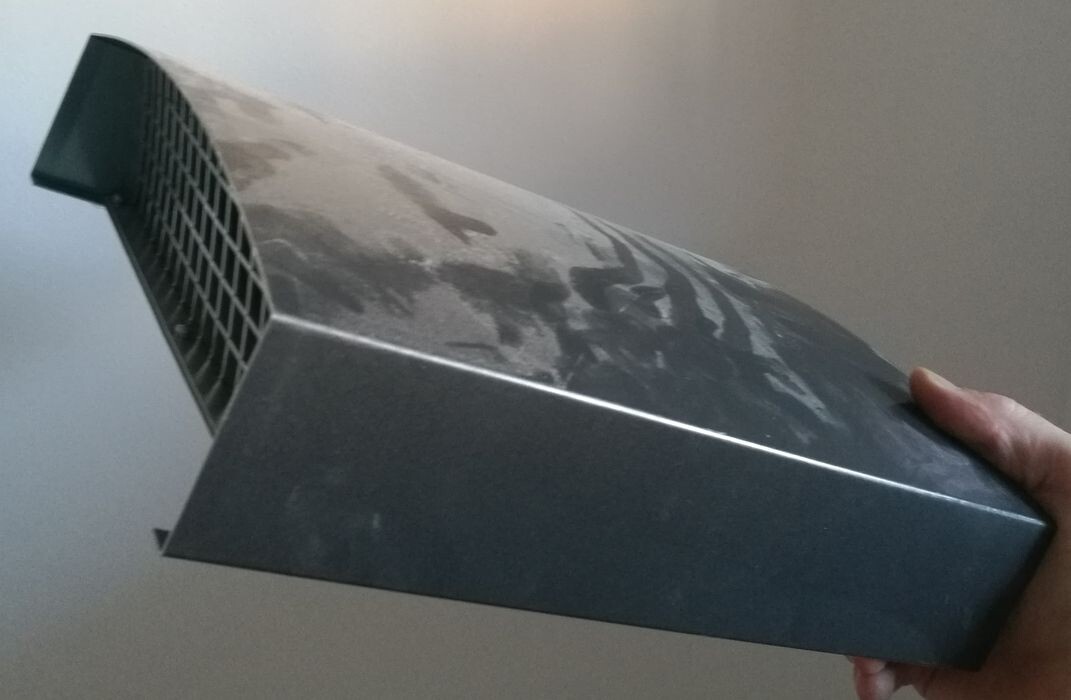

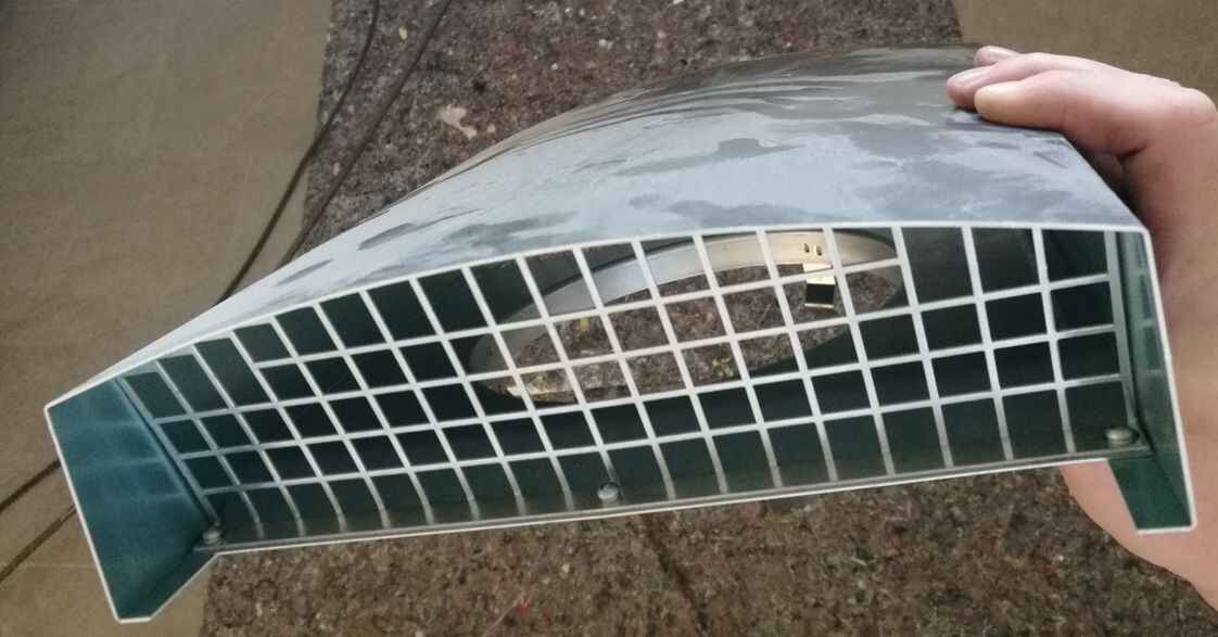

DragonyxXL5 Sep 2017 15:42The installation of our LWZ 180 will be completed soon. Two flexible ducts were routed from the utility room to the attic. From there, the supply air duct is supposed to be routed through the soffit, and the exhaust air duct through the roof (via a metal collar that will be integrated into the roof and then fitted with the photographed cover).
According to the ventilation installer, the cover with a perforated grille will be installed perpendicular to the roof slope (meaning the grille faces upward toward the ridge and downward toward the eaves). I am concerned that rain might enter the exhaust shaft through the grille in the cover.
How should the penetration of the building envelope be executed? Are there standard solutions for this? Is fresh air intake through an outlet in the soffit acceptable?

DragonyxXL7 Sep 2017 09:21It is a cold roof. The pipes are flexible ducts, which I believe are also minimally insulated.
Do you see any problem with rainwater potentially entering through the covering?

stefanc848 Sep 2017 22:35Hmm, I’m not an expert. I’m not sure if such a long run is okay or if it affects performance. I can’t say anything reliable about the grille either, but I would have the same concerns as you. Maybe ask again. It doesn’t always help, I know, many people try to talk you out of your doubts – but they don’t have to live with the consequences.
Are you sure you understood correctly why not put the grille at the bottom? Because then the warm air can’t flow upwards as easily?
