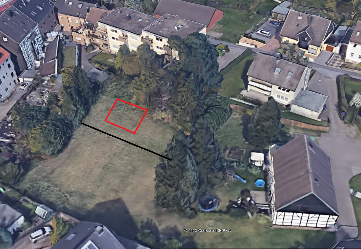

We are not familiar with your planned house and therefore lack many details that you might be underestimating in their importance. A hip roof combined with photovoltaic panels initially sounds like a less than ideal combination—or maybe not? This largely depends on whether this design actually creates pitched roof surfaces on the sides that are well positioned for solar panels. An aerial photo would be helpful, as well as cadastral maps or similar documents. How much knee wall height is possible or planned?
Regarding the structural engineering of a roof frame, you don’t seem to have extensive knowledge—at least you realize it could be important. It would be sensible to provide much more information about the house and the plot. Without that, it is neither possible to give useful advice nor to answer the seemingly simple question of how a solid hip roof could be constructed here. What is the reason against a more expandable gable roof or a shed roof, which are often much more amenable to future extensions?

Regarding the roof structure’s statics, you don’t seem to have extensive knowledge—at least you realize it might matter. It would be sensible for you to share significantly more about the house and the plot. Without that, it’s impossible to offer optimized advice or even answer the seemingly simple question of how to construct a solid hip roof here. Why not choose a gable roof or a shed roof, which are not only simpler but also much more suitable for future expansion? Regarding the gable roof, we also see the advantages of easier expansion and simpler roof construction. What spoke against it: The appearance of a city villa with a gable roof does not look good with a square footprint of 10 x 10m (33 x 33 ft), and we have to stay within a 10 x 10m (33 x 33 ft) building envelope.
The same “tinfoil hat” architect said that distributing the photovoltaic system on east, south, and west sides of a hip roof would provide a steady daily energy yield.
Attached is the requested aerial photo showing the approximate arrangement of the building. We have no information yet about the knee wall; only that the planned hip roof has a 50 cm (20 inch) roof overhang. The development plan allows 2 full stories and pitched roofs (GD = geneigte Dächer), with no specified ridge or eaves heights.
