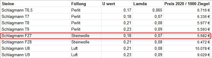

Not including the plaster, this results in a U-value of 0.311.
I find it hard to believe that this will be sufficient. From T9 upwards, it becomes more realistic.
You can find the exact requirements in the thermal insulation certificate.Exactly.T12 is no longer up to date.
Filled bricks only make sense if there are increased sound insulation requirements.
From an energy efficiency perspective, the additional cost does not pay off.
S9 is the most economical option.
