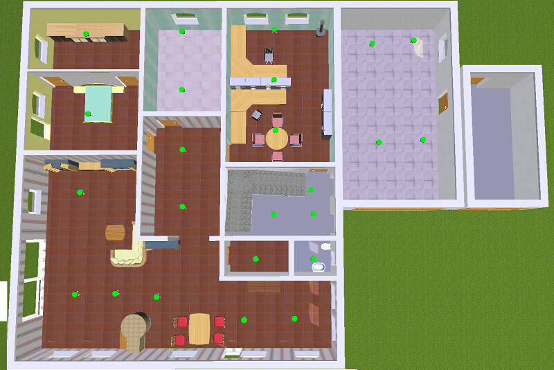

Structurally, it wasn’t necessary, but I wanted it that way. a) for sound insulation, since my office is on the first floor, and b) for heat storage. I have an open kitchen/dining/living area with a masonry heater that is meant to gently warm the walls, and the more mass it has, the longer it retains heat. I’m attaching a picture of my floor plan where you can see this clearly.
