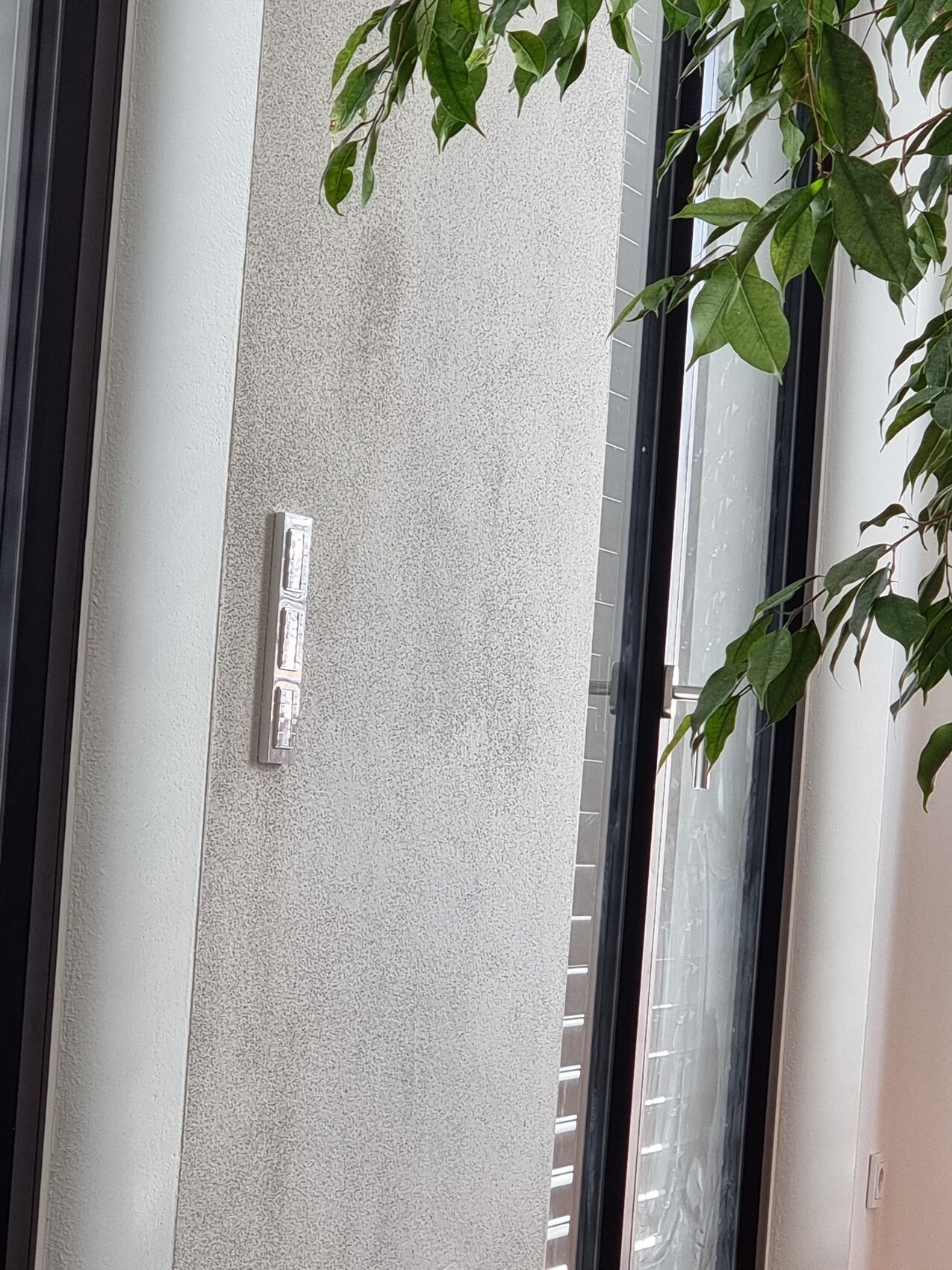

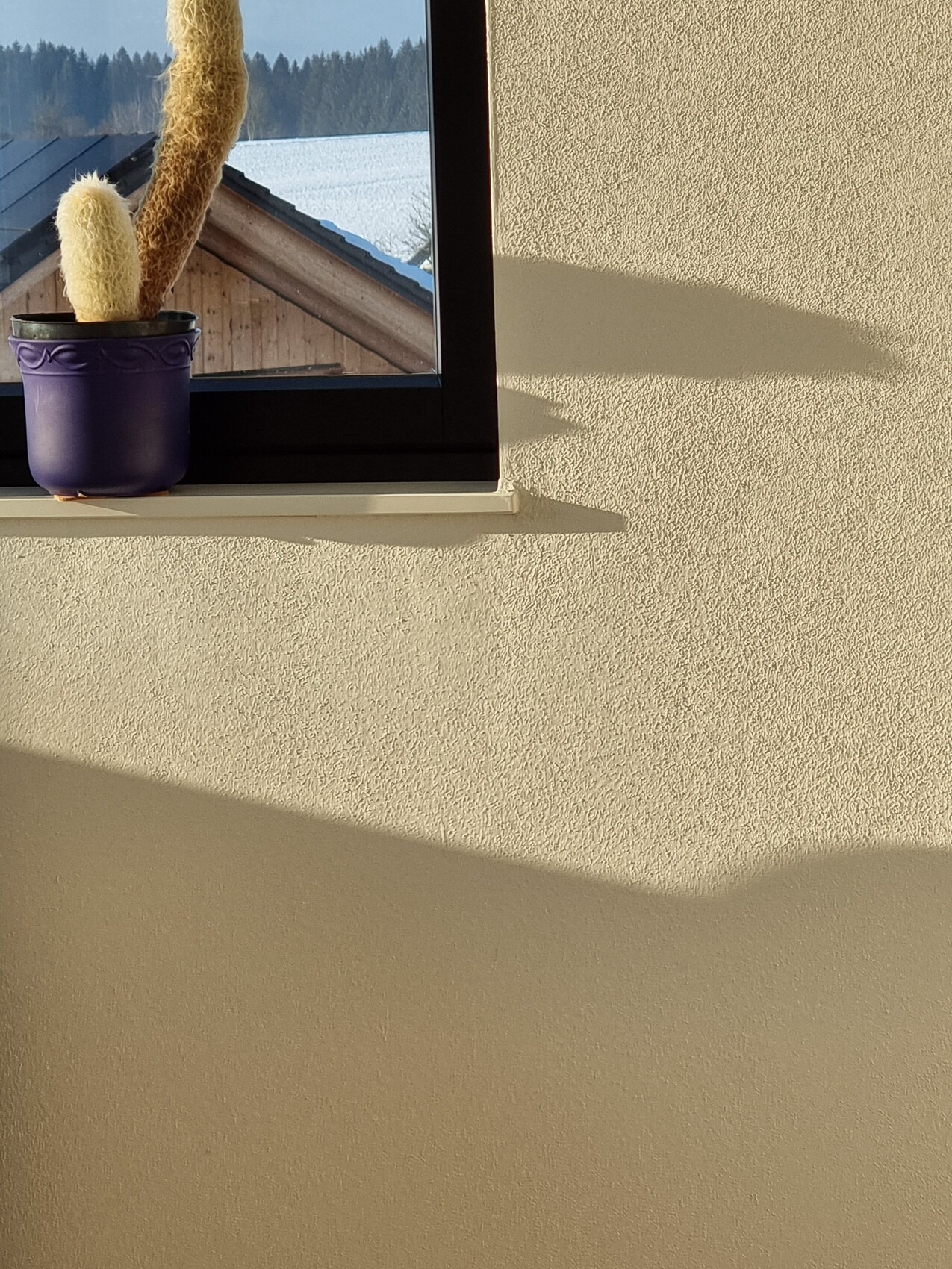

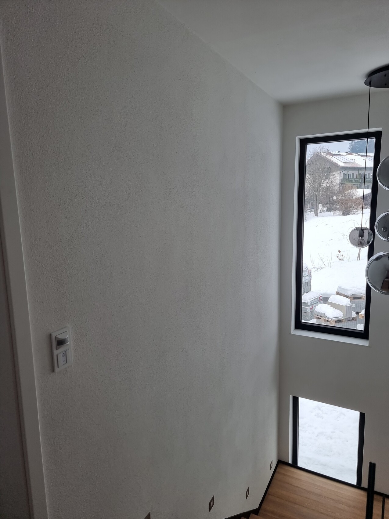

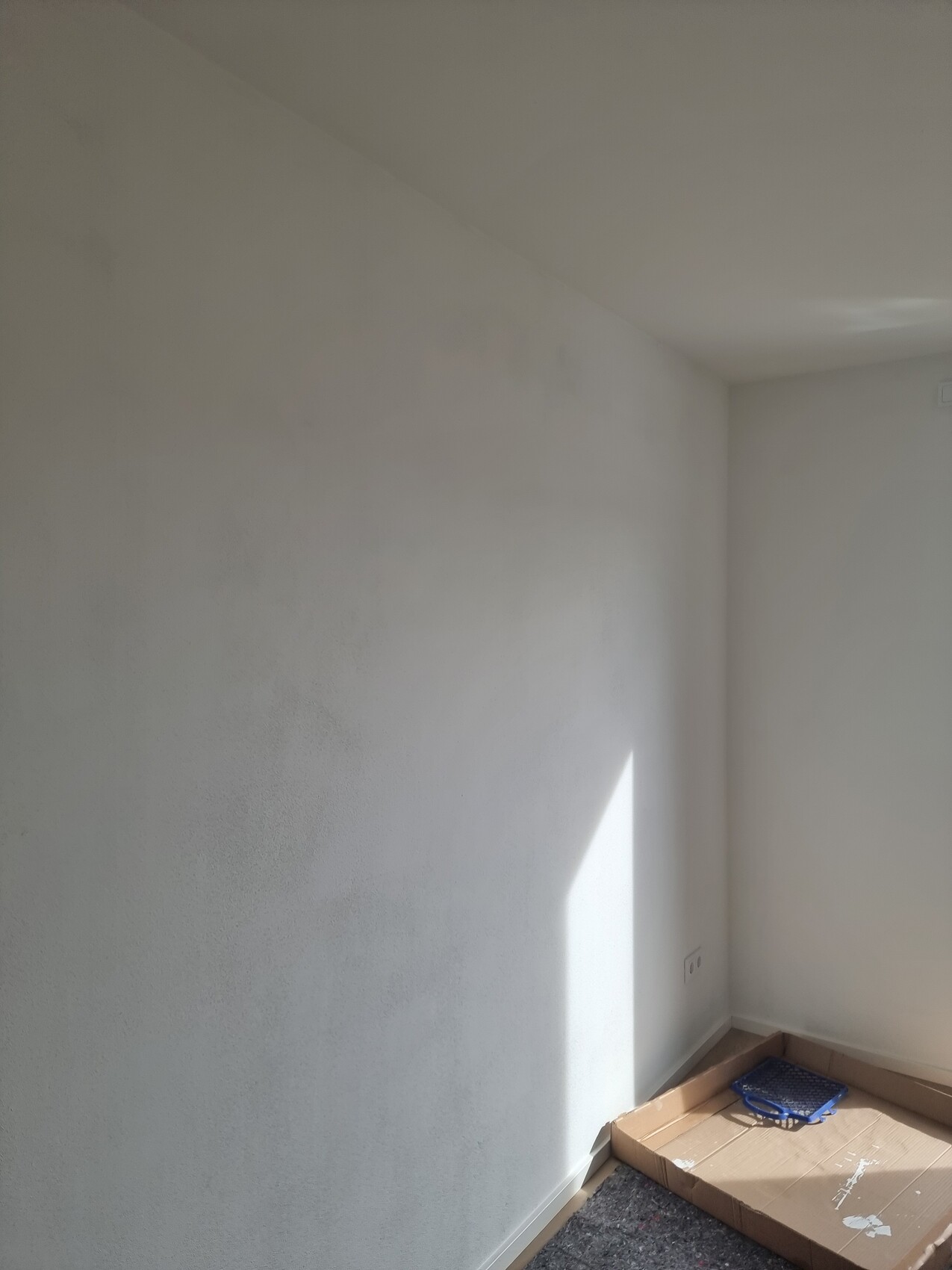

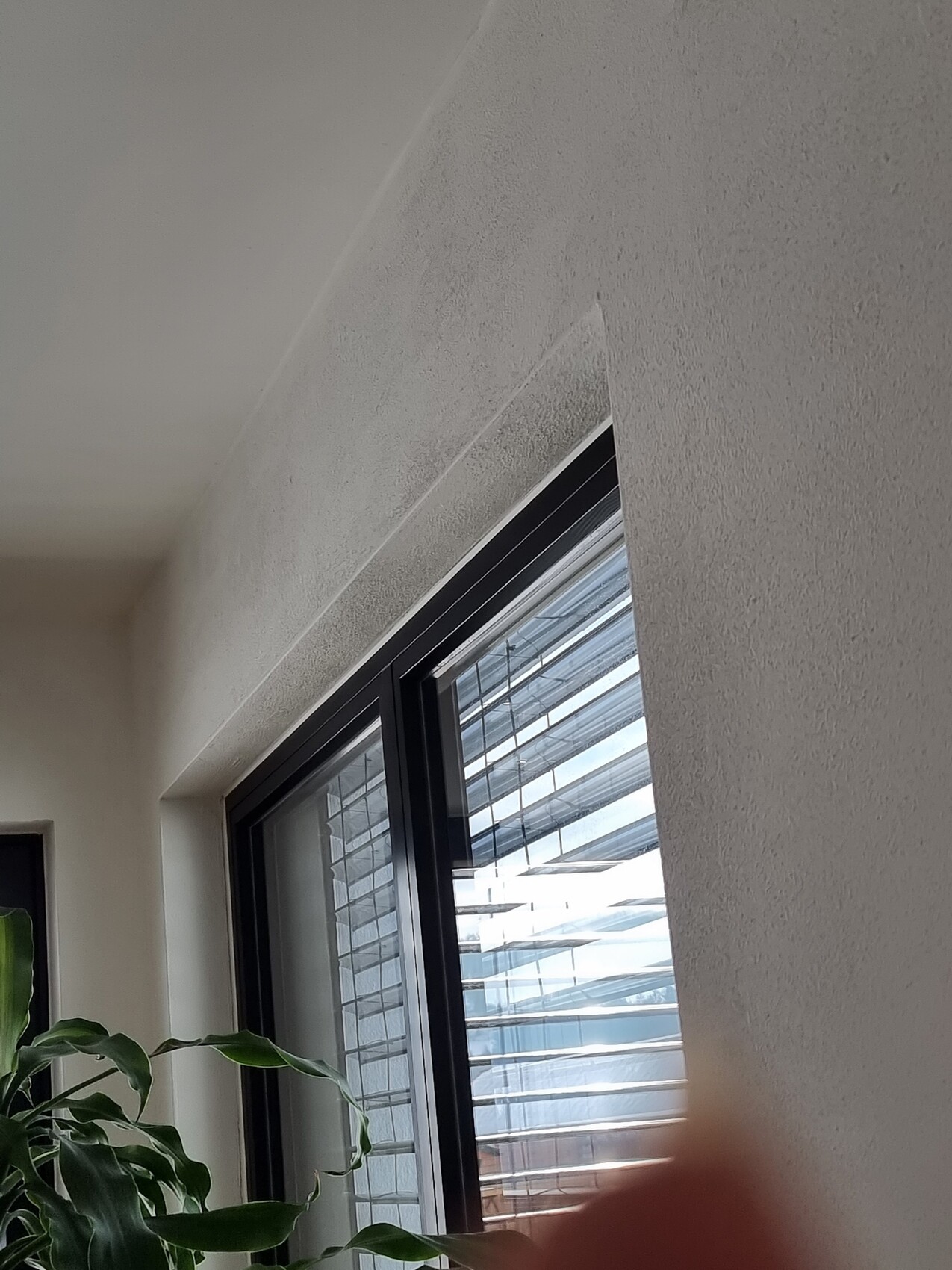

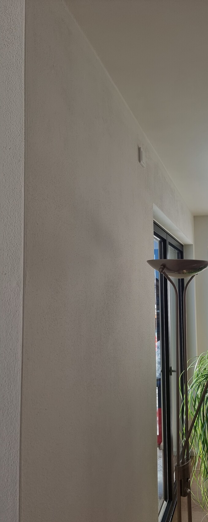

Hello everyone!
Something doesn’t seem right here, but I’m a complete beginner, and the painter is blaming the plasterer, and vice versa.
What do you think—is it poor plastering or poor painting?
White, empty corner of a room with painted walls, light spot on the wall, cardboard floor covering with a blue object.
Interior: white walls, window with black frame and blinds; green plant in the foreground
Bright stairwell with high walls, narrow window; view of a wintry outdoor scene.
Two cacti in a purple pot on the windowsill in front of a wall, winter landscape visible outside
Textured wall with a triple switch panel, glass door handle, and green plant.
Bright interior: beige wall, glass sliding door, and a floor lamp next to a houseplant.
Tolentino22 Feb 2023 11:26
Well, it has to do with the quality of the plaster. The question is what was agreed upon with each trade?
I assume Q2 finish for the plaster (looks like it) and sometimes a white matt finish with the painter (looks like it).
If no preparation for smooth walls was agreed with any of them, then none of them did it.
By the way, this is how it looks in parts of my upper floor where I didn’t sand well.
On the ground floor, I had painter’s fleece wallpapered (or had it done). There I have nicely smooth walls and ceilings. I did all the painting myself.
KarstenausNRW
22 Feb 2023 12:39
Sandra84 schrieb:
Something isn’t right here, but I’m a complete layperson and the painter blames the plasterer, and vice versa.
What’s your opinion: poor plastering or poor painting?
Please be specific. From your point of view, what exactly is wrong? What do you think is faulty or poorly done? What agreements were made with the plasterer and what with the painter? Who did what?
It might also be a service delivered exactly as ordered. Based on the photos, I cannot identify any defects at this point.
Tolentino22 Feb 2023 12:43
I think you can clearly see what @Sandra84 means, but yes, this does not necessarily have to be considered a defect, depending on what was agreed upon.
Sandra84
23 Feb 2023 09:48
[/QUOTE]
Tolentino schrieb:
Well, it’s related to the quality of the plaster. The question is, what was agreed with each trade?
I assume Q2 for the plaster (that’s how it looks) and a basic paint finish with the painter (that’s what it seems).
If no one agreed to prepare the walls for a smooth finish, then no one did it.
By the way, it looks like this in some parts of my upper floor too, where I didn’t sand well.
On the ground floor, I had wallpaper with painter’s fleece applied (or had it applied). There, the walls and ceilings are nicely smooth. I painted everything myself.
I think that was exactly our mistake.
The plaster is Q2, and the painter just painted over it.
Can you tell me if it’s still possible to fill and sand it afterwards, or is it now a problem?
Thanks for your help!
Sandra84
23 Feb 2023 09:50
KarstenausNRW schrieb:
Please be specific. What do you think is wrong here? What is supposed to be incorrect or poor? What was agreed with the plasterer and what with the painter? Who did what?
This could also be a service delivered exactly as ordered. From the photos, I can’t initially identify any defects.
It’s not about a defect.
I just want to find out what happened and then have it corrected at my own expense.
I suspect that no additional filling and sanding were done.
Now I’m wondering if the painter can still do that.
