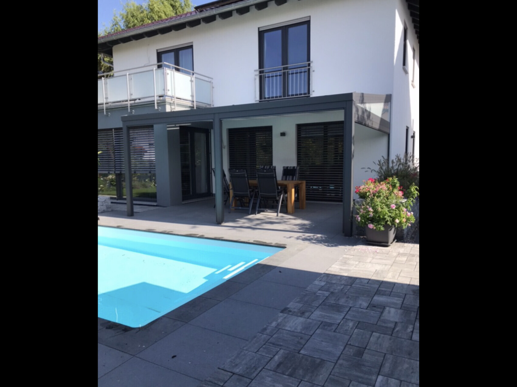

You can do everything yourself, but the question is whether you want to or can. There are even people who dig their pool by hand with shovels and wheelbarrows. You need to consider how much you want to spend and whether it’s financially feasible. We had a pool professionally installed last year, which is the easiest option. We don’t have any heating yet, but with the hot summer, the water stayed warm until September, always between 24 and 27°C (75 and 81°F). We insulated the pool walls and covered the pool when it wasn’t in use.
