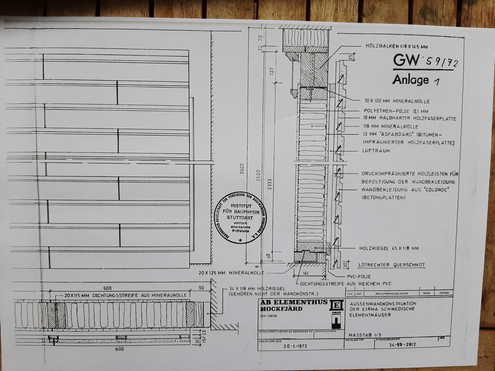

Hartrampf10 Jul 2024 08:26Dear forum members,
I have a question regarding my parents’ house, which was built in 1976 in Baden-Württemberg, near Rottenburg am Neckar. My father should still have all the documentation. I would like to know if anyone can help me with information about potential pollutant contamination. I have already read the forum posts and received some helpful information (Swedish prefabricated houses are generally less contaminated, consider testing, etc.).

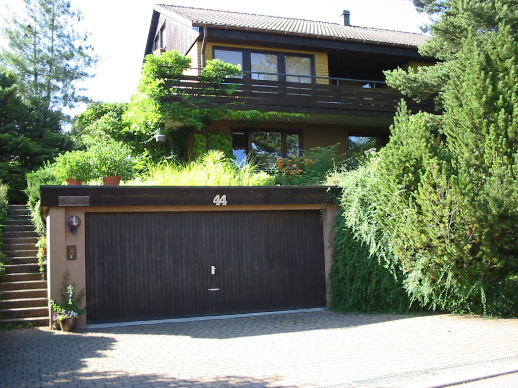

I also wanted to ask if anyone might have a pollutant analysis or similar data specifically for the Mockfjärd house type, which I could use as a reference for my own investigation. I would be willing to pay for this. Currently, I only have a detail of the exterior wall; I can still get a photo of the house itself and upload it.
Kind regards
